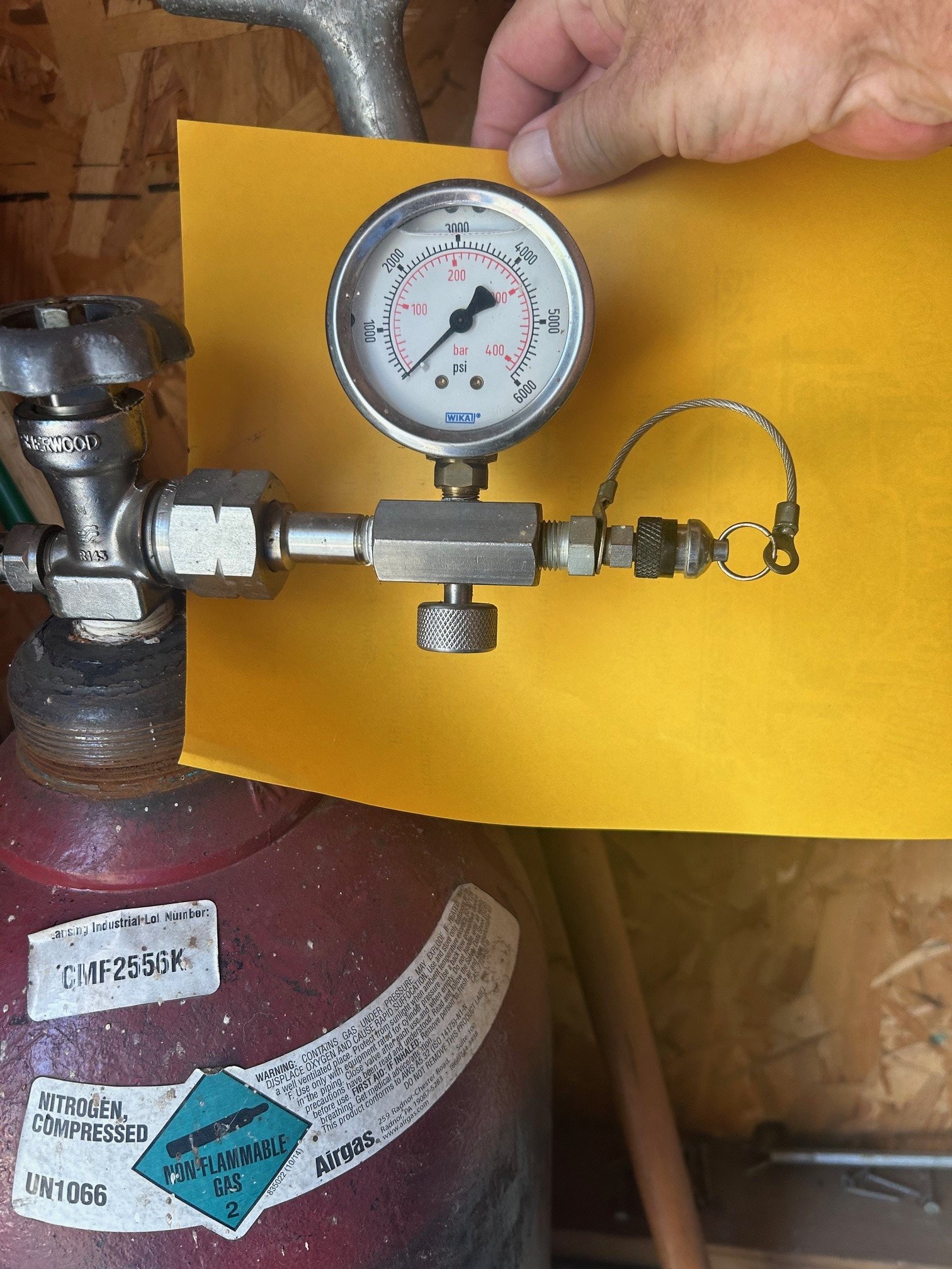

6K Nitrogen Tank Arrived

I ran the big 6000psi tank at the neighborhood air rifle range. We used the Joe B regulated version. I found a like new used new one for $350. It worked great for filling rifles direct. Very much idiot proof which was what was needed for an unsupervised public range. If only filling your tank off the nitro tank you may not need the regulator and be able to roll with the non-reg version like the poster above.
What are the fees for the big tank?
You need to check in your area. The costs are VASTLY different around the country. If you search nitrogen here you will some outrageous prices that people were quoted making it a moot point. Mine was very cheap and was a great deal for me especially since I didn’t shoot a ton when I had it.
I think mine was a $75 yearly rental and then around $100 for a fill. Others were quoted several hundred dollars a year just in the tank rental alone.
what would be the difference fill guns directly or filling bottles to fill your guns ? Unless the filling process has a lot of wasted gas blowing off the fill hoses ?
bottle size..filling a bottle less dangerous.:unsure:..still a regulator is needed , a fresh nitro bottle at 6000 psi is a real threat..maybe dumping fast air into a bigger bottle is safer then a crown bottle at 480 cc..its all fast, and at 65 years old safer is a better option for me.
Reactions: beerthief
This is what I've been using the last 5 years, go it from Joe B. I now have a compressor so I will be selling it.
I typically keep 2 N2 cylinders on hand, regulating the higher pressure of the 2 and just using a fill station on the lower pressure cylinder.
After 5+ years of exchanging many cylinders with 2500psi remaining I finally picked up a booster. Now I can run my cylinders down to <1kpsi and still boost guns to over 3kpsi.
While not required, having a good reg and booster pump will enable you to maximize the benefits of buying clean,dry, high pressure gas vs compressing your own.....
