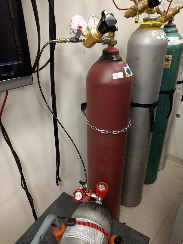

Sorry for the thread revival. @prfssrlee I'm planning on going with 6000psi N2 for my air source. I'm trying to "build" my regulator assembly. Please correct me if I'm wrong...I see from the tank valve, you have the CGA 677 nipple, into the regulator inlet, inlet and outlet pressure gauges (on their respective ports), then a bleeder on the outlet side of the regulator, and then the fill hose. Is that a pressure relief valve too (at the bleeder)? Or is just a capped off end of a thru bleed valve?
Is the bleed valve necessary? I don't see a bleeder on our forum sponsor's CGA 677 regulator/fill hose assembly, which is why I ask.
Brian Liquid nit. comes in a 10lb to 600-700lb it is contained in a special tank ,your 6k nit is gas form. The only other tanks that have liquid in them is co2 & acet. For the noobs use the right reg.for these high pressure tanks, its nothing to mess with. do not attempt to use without the ( PROPER GAUGE).Before you turn the tank on release the handle or nob that controls the outlet pressure.gauge should show( o pressure)when you turn the tank on stand to one side not in front of the gauge & turn it on slowly then you can adjust pressuse. when your done turn tank off release all pressure from gauge then turn out pressure control nob. make sure tank is attached securely to wall & if you have kids around take the gauge off & put the steel cap back on. just my 2 cnts
Sorry again....not sure why there isn't multi-quote on here. @kayaker or anyone that has HPA experience (I'm totally new at this). I am seeking clarification on the above steps for correctly filling from a 6k tank. Is the following sequence correct (assuming the regulator assembly is already correctly attached to the N2 bottle valve)?
  1. Close the N2 tank valve (it should already be closed)
  2. Close/decrease the N2 tank's regulator pressure to zero (it should already be there)
  3. Open N2 regulator output bleeder (if one is present, to empty the fill hose and relieve any pressure that may be there....even though there shouldn't be any pressure, as the regulator would have bled this off when it was decreased to zero....at least I think that's how the reg works....is this how it works?)
  4. Close N2 regulator output bleeder (if one is present, and you just opened it)
  5. Connect smaller tank, or gun to the fill hose
  6. Slowly open the N2 tank valve (keeping face out of the gauges, in case they decide to blow)
  7. Slowly increase reg pressure to the desired fill pressure of the tank/gun that was connected in step 5
  8. Once full, close N2 tank valve
  9. Close/decrease the N2 tank's regulator pressure to zero
  10. Open the N2 output bleeder (if one is present....and again, won't decreasing the regulator to zero already bleed this off?)
  11. Disconnect the smaller tank/gun
  12. Close the N2 output bleeder
    [/LIST=1]
    Thanks for any input.

I ended up getting the regulator from August Industries (reg is linked on page 1 of this thread). I also got most of the rest of the parts needed, with the same order. I could have spread it out, and saved some money on the gauges (and maybe the fittings), but I like the dial faces on the August/Wika gauges, and shipping from 2 or 3 places would have actually made the grand total cost more.
So....CGA677 nipple, into reg inlet, reg has 2 ports for gauges (one for in pressure, one for out pressure), so two gauges, 2" long male x male NPT fitting on reg outlet (to give some hand room for the line valve), into a line valve with a captive bleed valve.
I have an NPT to BSP adapter (Best Fittings) to attach the fill hose to the line valve. Other end of fill hose will have a quick disconnect.

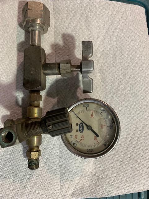

prfssrlee never responded but, it does not look like there is a line valve on that setup. I am filling from 6000psi directly to my gun, which is why I went with a regulator, and a line valve, and a bleed (my bleed is integrated into the line valve). I don't have a carbon tank to fill.
This is what I used until my local supplier raised the bottle rent on the 6000# nitrogen bottle. It has 10000# needle valve to control the flow to the air rifle and a drain valve to drain the pressure from the line. I just closed the needle valve, opened the tank valve then used the needle valve to raise the pressure on the gauge to what I wanted then closed the needle valve and the tank valve and opened the drain valve.
