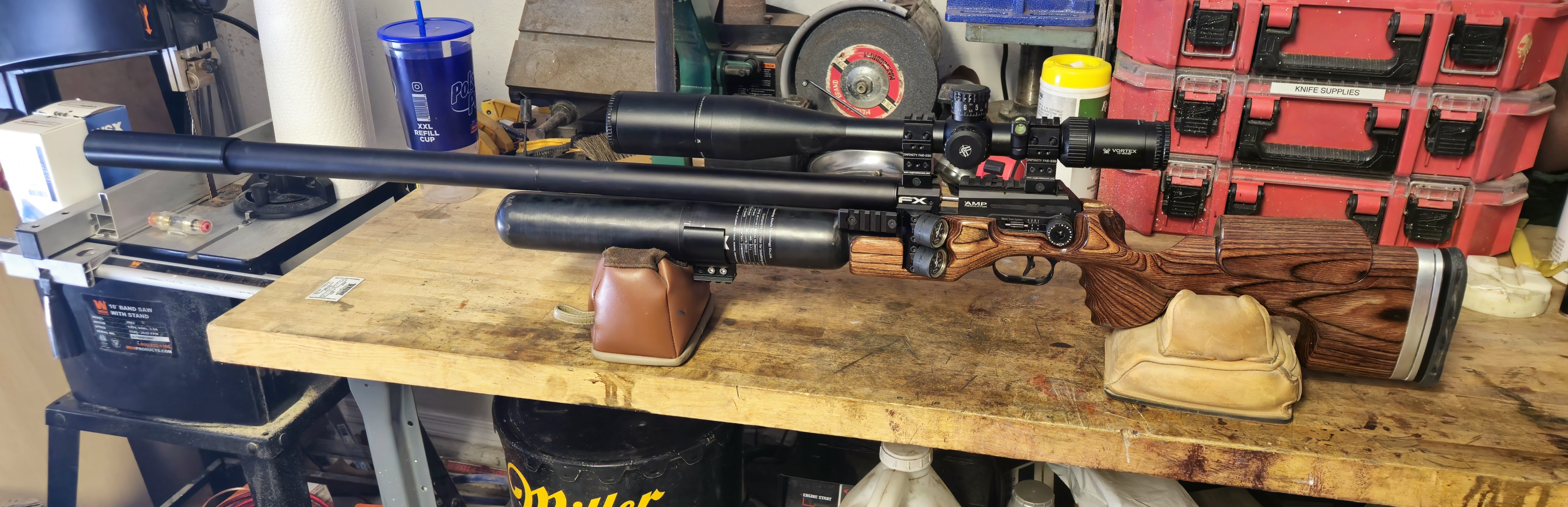

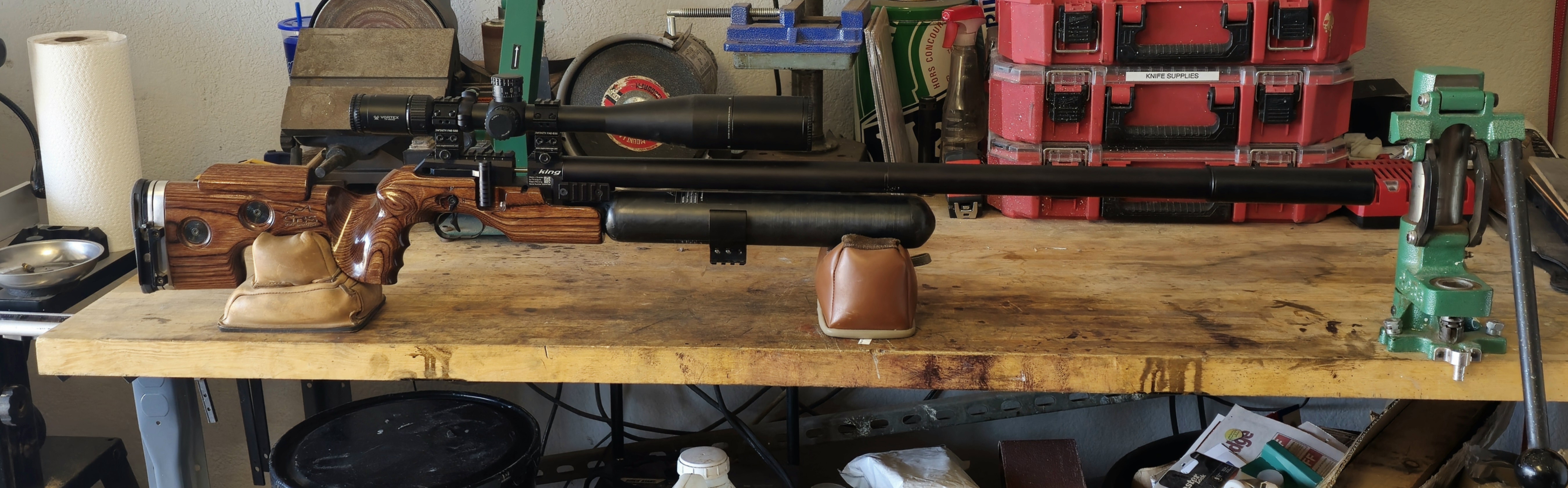

So how did it come out?
Take a look.
I like my long guns for competition and this one is definitely in that category.
So it is capped off with an STO FALX which I love, between the extra large shroud and the FALX this gun makes only mechanical noise the shot is almost completely silent.
But it does hit hard.
At 160 bar and 3.75 on micro Tune He will shoot 40gr. .217 H&M Slugs at 952 fps for 80 ft lbs.
I definitely need to dial it in and probably need to go back up to 165 bar, but this is probably my least tuned airgun at the moment as I finished the build in the middle of a very hot summer here and have not been shooting like I usually do.
When it is done, I will use it for 100 yard competition so I can line up along side all those Pantheras, Dynamics, and Red Pandas with something a little different.

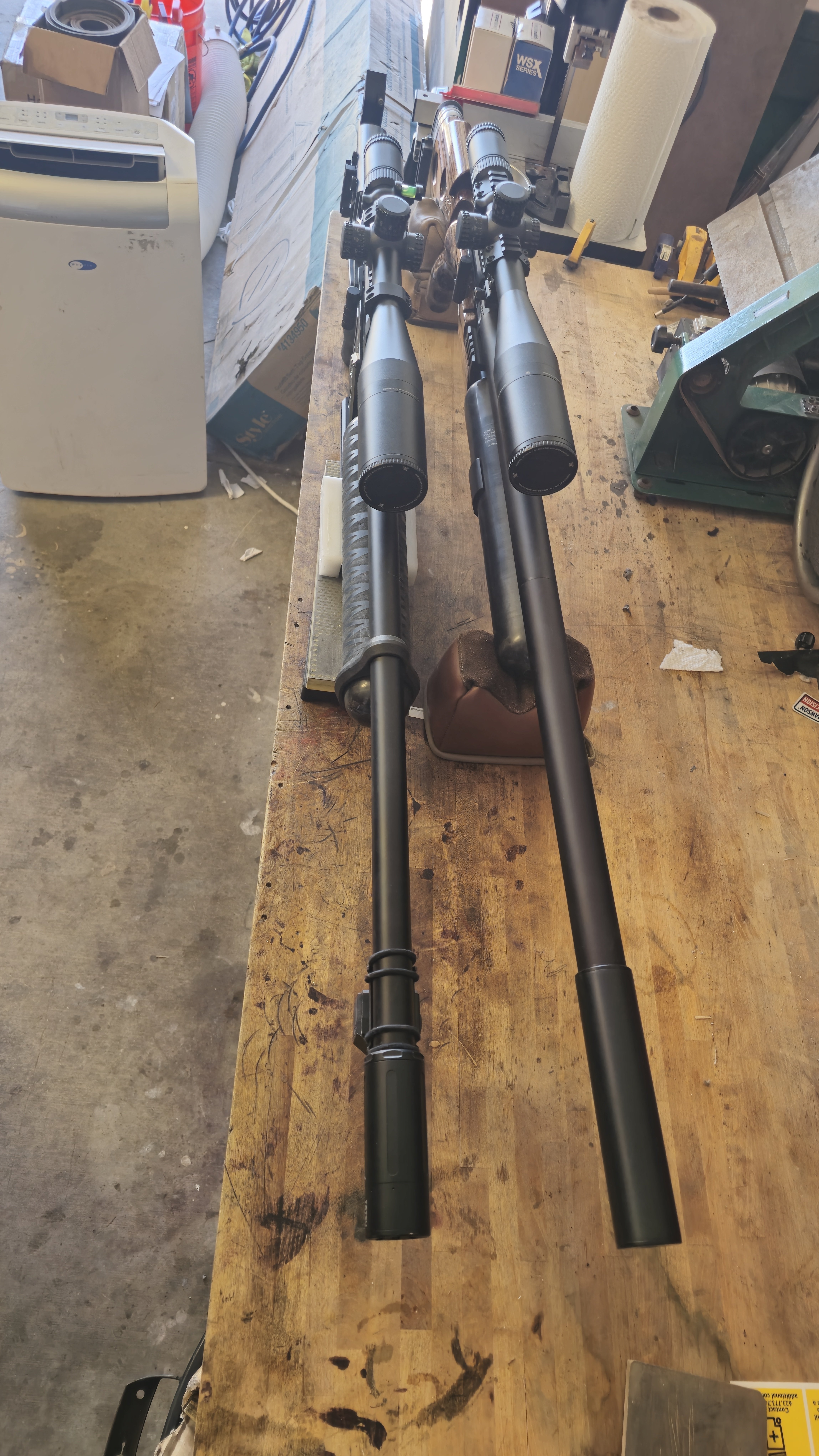

Here it is along side my 700mm Crown the lengths are almost identical.
