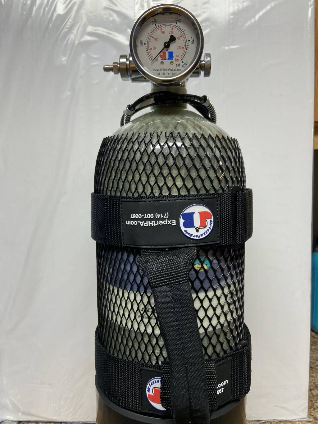

I just purchased a 72 CuFt tank from Joe Brancato....AirTanksForSale.com. It is what he calls the Tiger Shark tank. He sells very high quality tanks, lines, adapters, fittings, etc for whatever you need. Just another option for you to check out....
