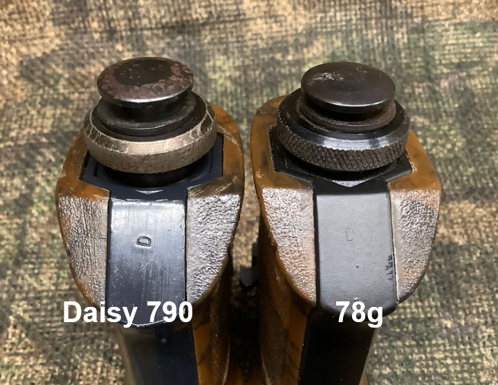

I think I was bidding against you for that Power Line 41! That heavy trigger wasn't a recall repair. All the 41s I've come across so far were manufactured in January, March, and April 1983. By that point in time, Daisy was installing the drop safe trigger on all 790 and 41 pistols. They do have the nice, crisp factory D marking on on the grip near the piercing assembly so people wouldn't request the recall be performed on a pistol that already had the new trigger.
This picture shows a June 1982 Daisy 790 and a S&W 78g that was sent in for the recall.

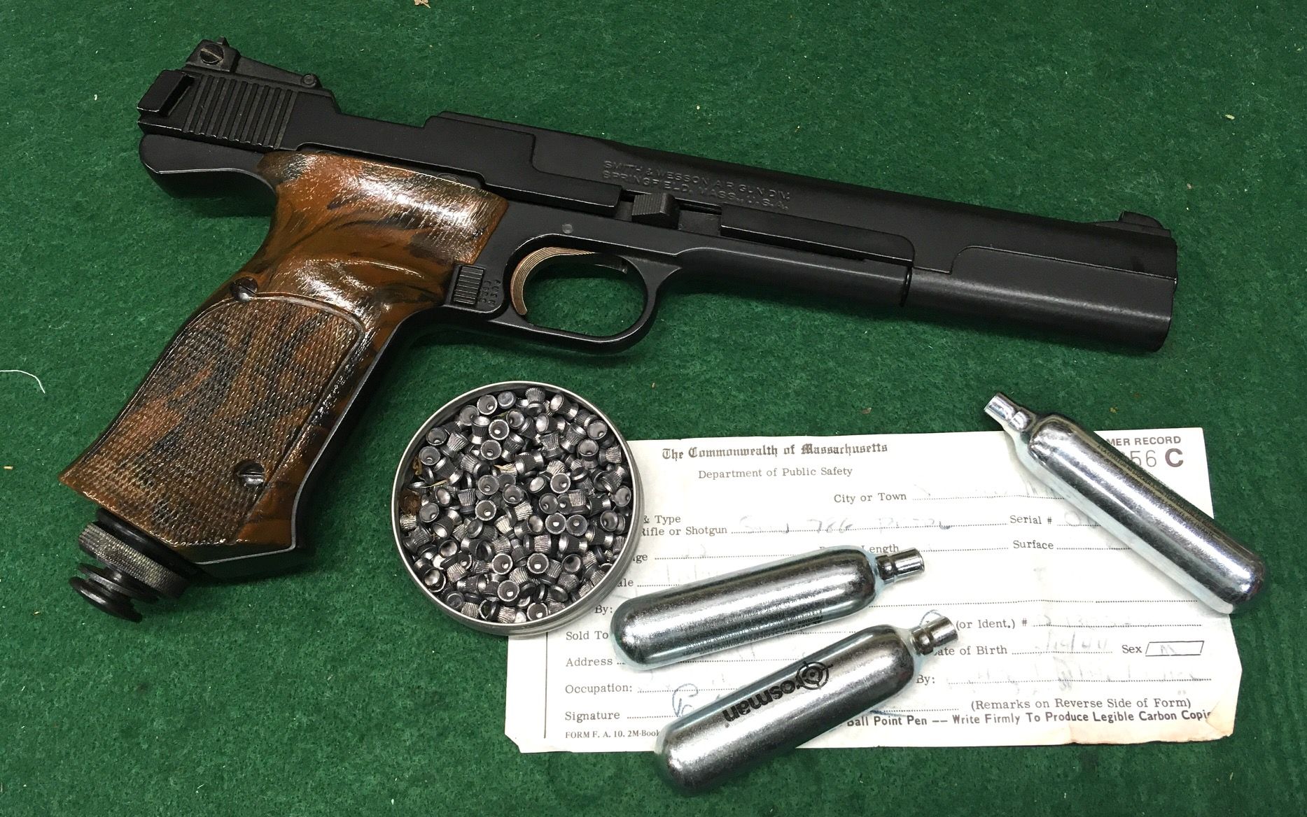

And here is a picture of the most valuable 78g on the planet:
It's the one my Dad bought back in February of 1976, and was the first "real" gun I ever got to fire as a kid. As such, it's priceless! The paperwork in the picture was required because my state viewed this as an actual handgun.
I inherited it after he passed a few years back, and found the seals were bad (as they are on most). It was the first one of these I resealed and started a bit of an obsession with the Smith pistols as well as the Daisy 780, 790, and 41. Just recently we found the original box along with the $36.99 price tag.

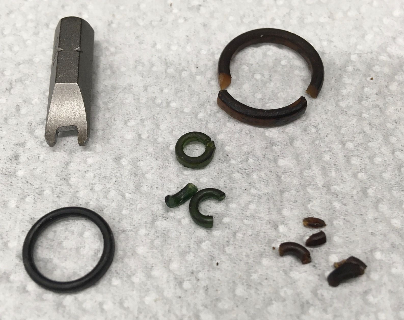

There are several good videos on Youtube that show the disassembly, seal replacement, and reassembly process. As for tools, only one special tool is required, and that is used to access the small seal in the piercing assembly. This can be made with a flat tip bit and a Dremel. Here's a pic of the one I use along with some of the seals that came out of my first rebuild.
Here's one of my 41s.
Thank you for the education about the "D" stamp. I appreciate you sharing your experience. I read somewhere about the "D" stamp, don t remember the publication. If can recall I will give the reference. Again , Thanks always trying to learn.
