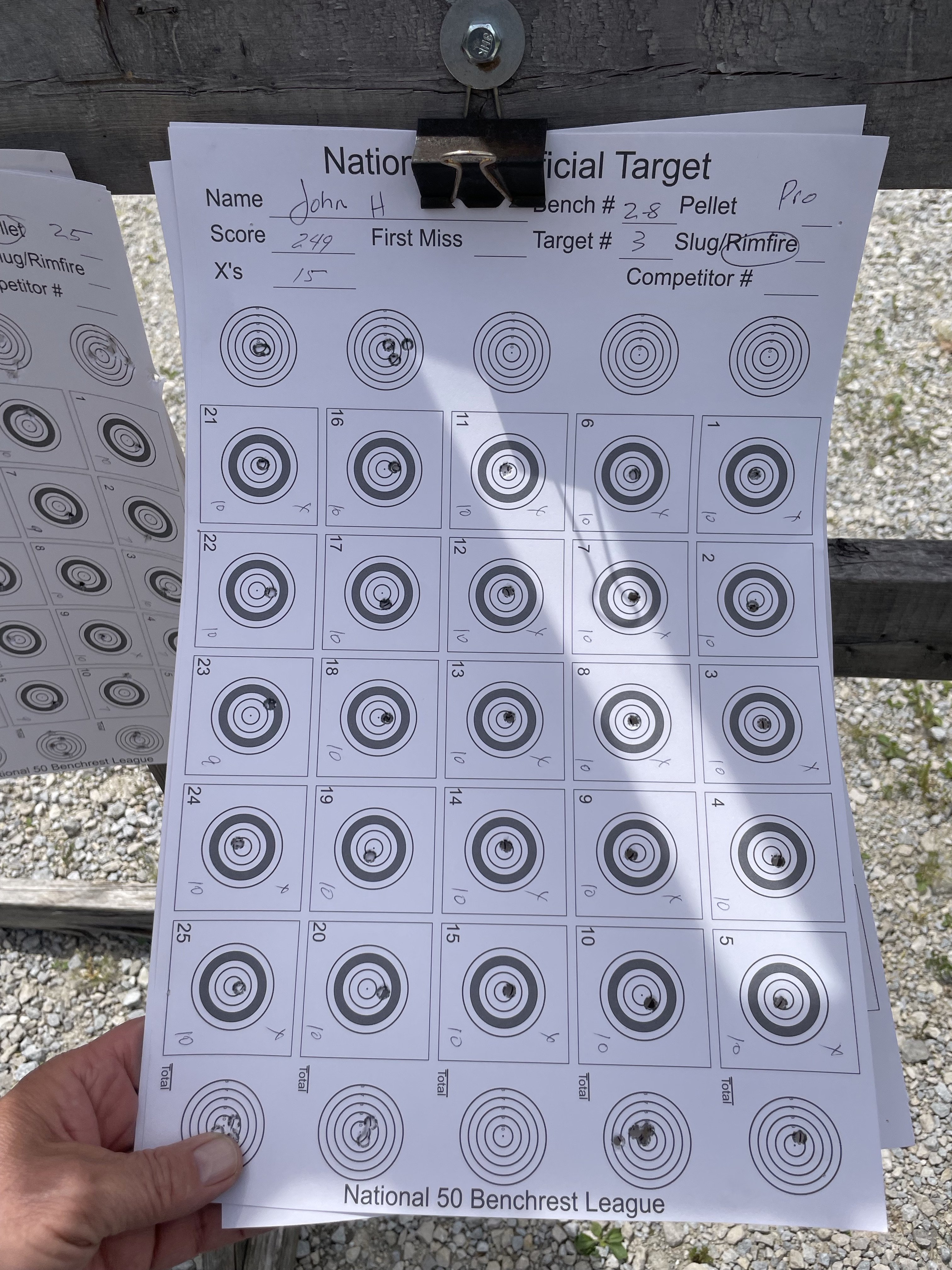

Well today’s match is complete. We had 17 shooters today and we voted whether to continue or end the 100 yard match and the majority vote was in favor of ending the 100Y matches and focus on N50 going forward. I am sure some shooters were disappointed but we have to follow the consensus of the majority.

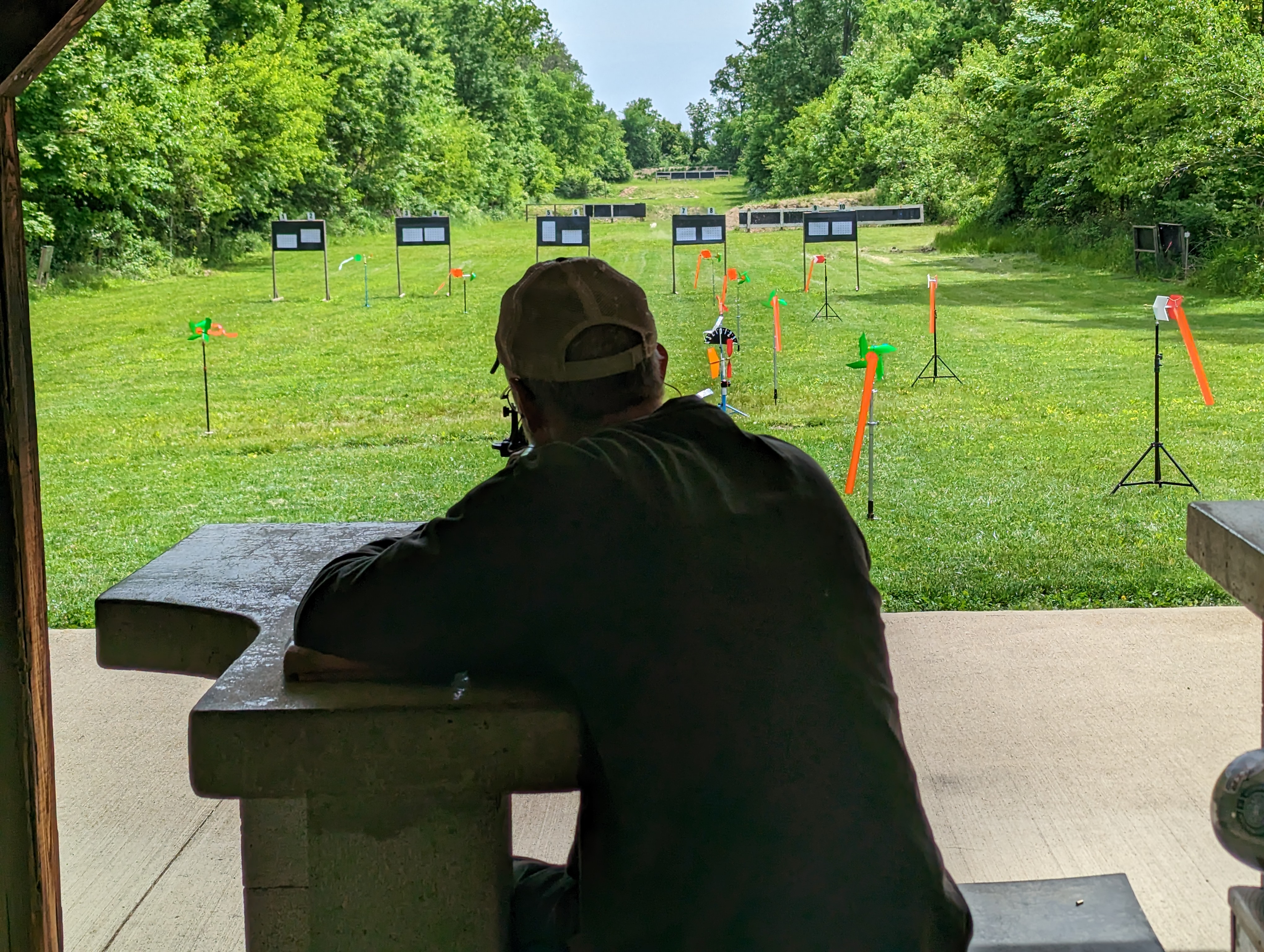

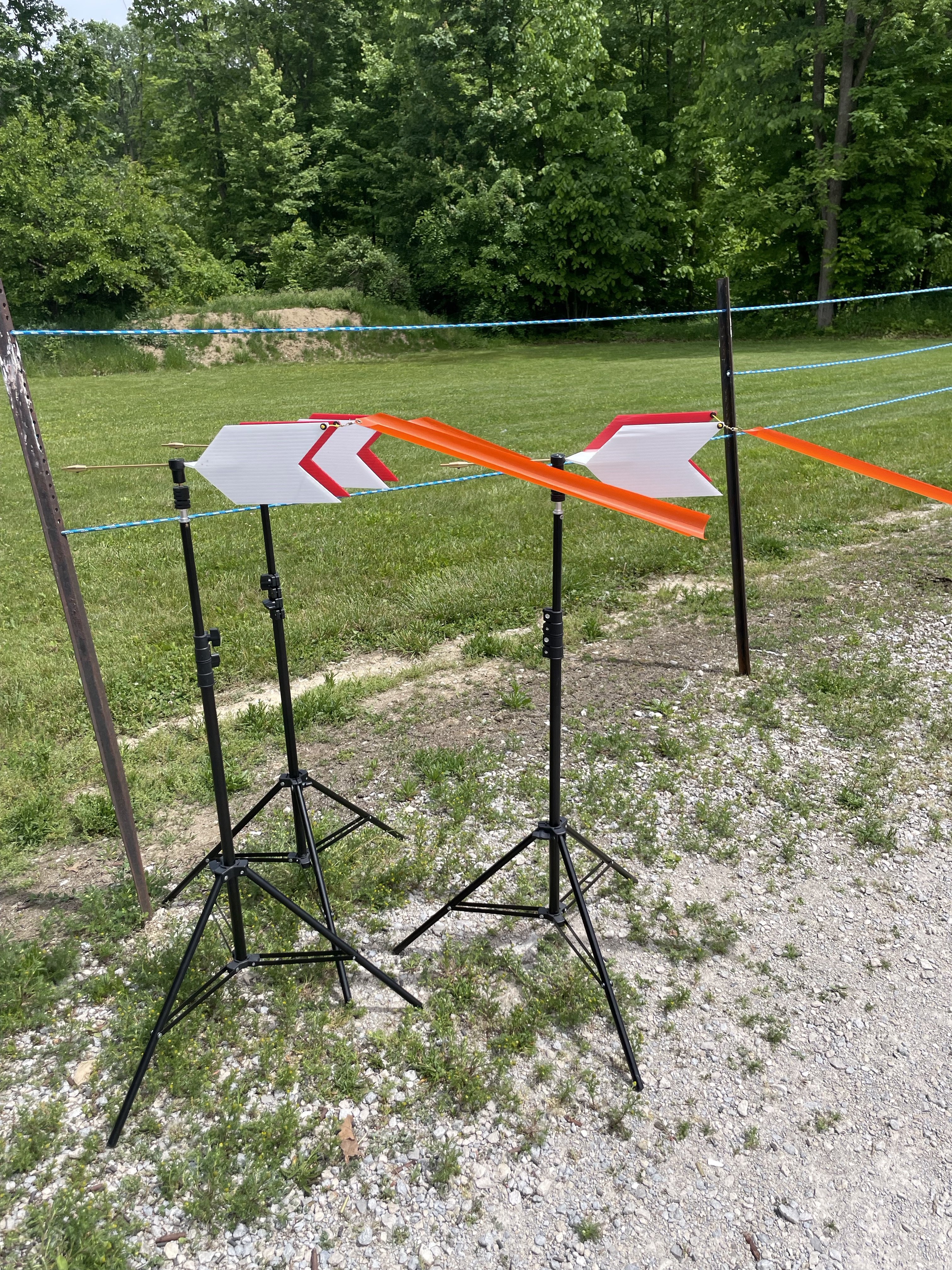

The wind was very challenging today as seen from the flag tails:

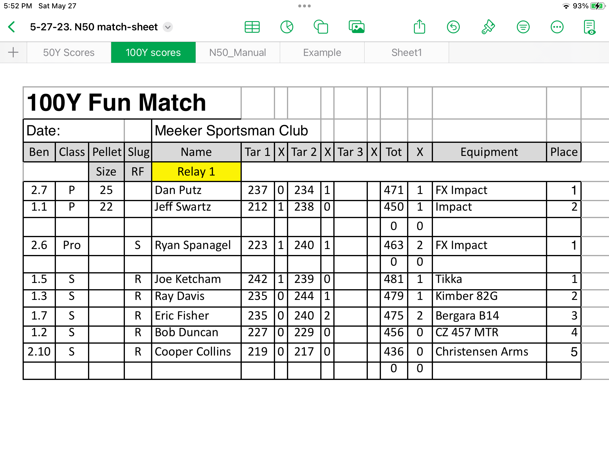

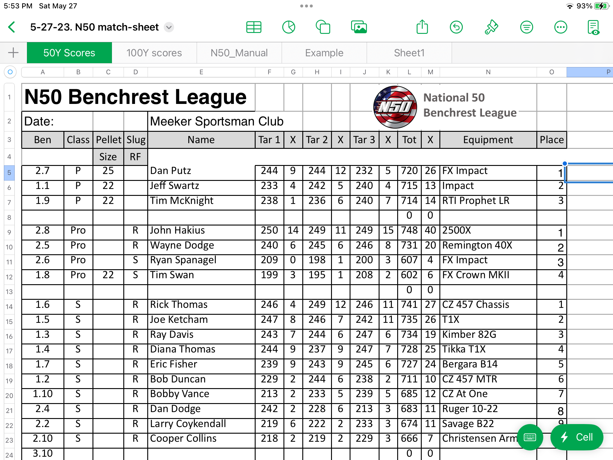

And the scores reflected the challenging winds:
A special thanks to Tim Swan for designing the award certificates:
Lastly a very special congratulations to John Hakius for posting the very first 250 card and two equally impressive 249’s with his pro class 2500X!

I have no point of reference, since these are the first IBS 200 yard targets I have seen on AGN shot at 100 yards; but these scores look pretty good for both pellets and slugs with airguns. You guys had some tricky winds right?
I know there were only a few shooters, but four out of six scores were in the 230-240 range at 100 yards. Not too shabby 😉
