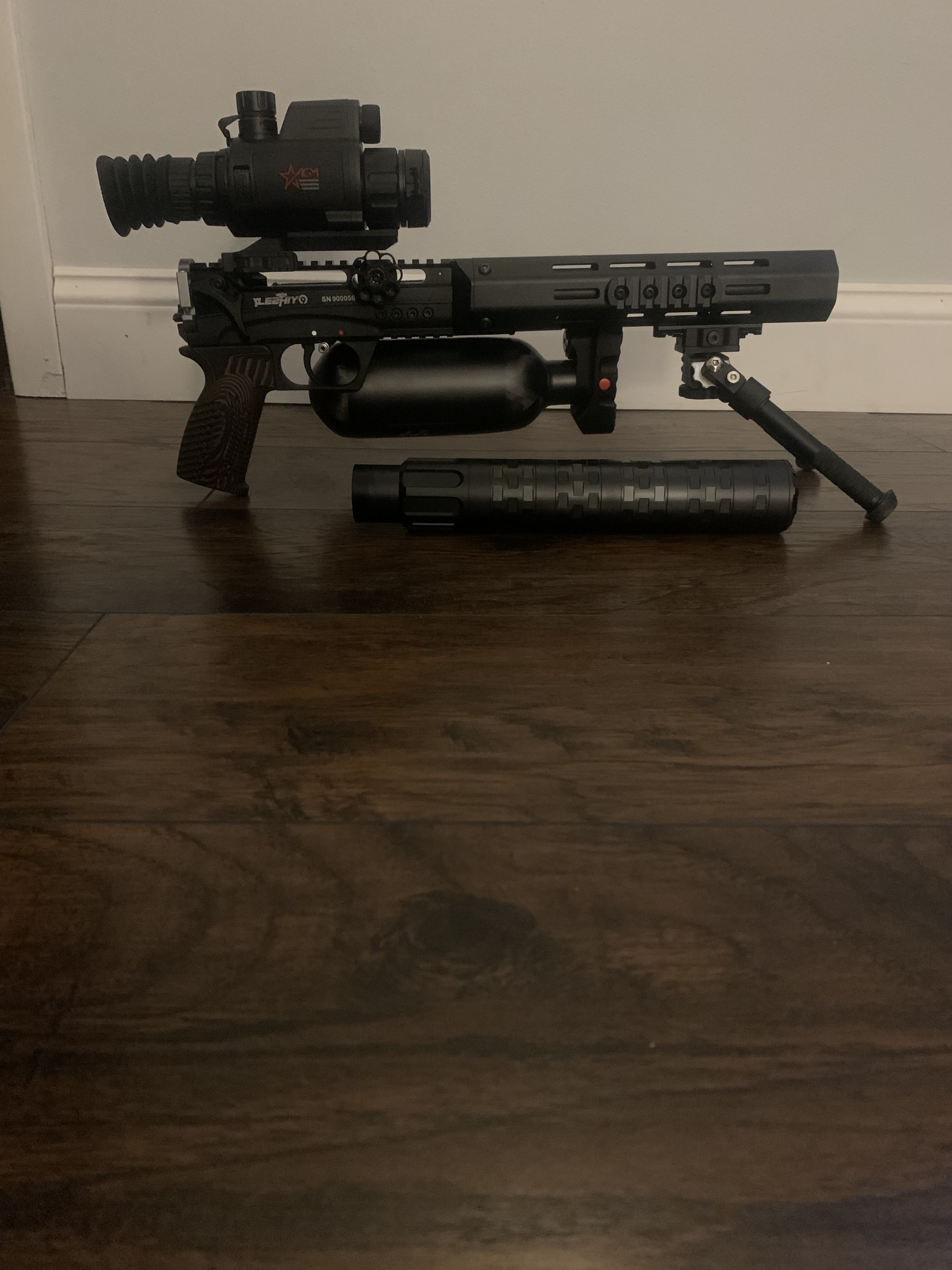

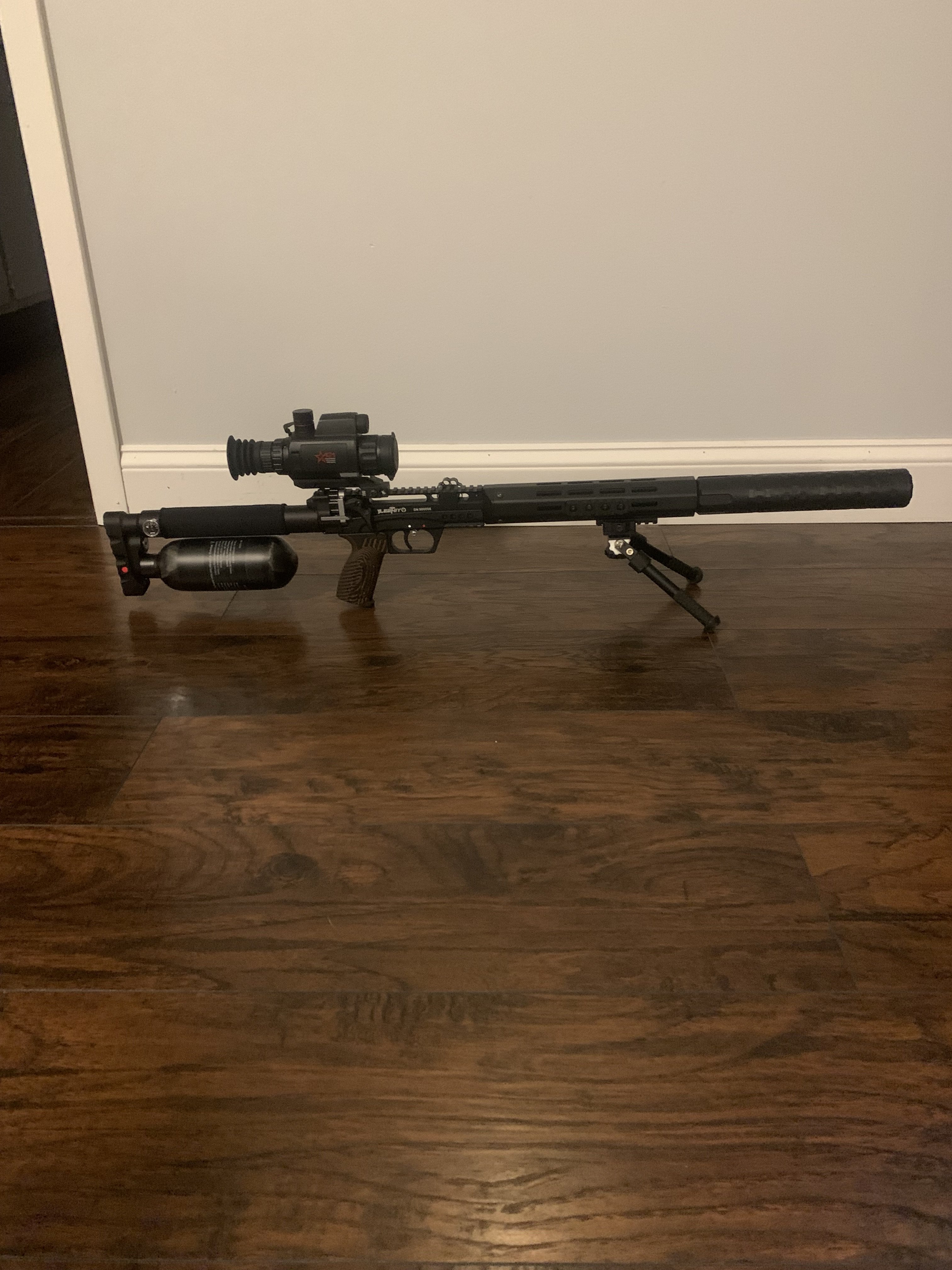

So I’ve had my 9 mm Leshy 2 for about a week and she would not cycle so I googled and searched everywhere and watched the videos. I have polished the face of the barrel, re set the barrel cleaned the barrel replaced puck light oil and made sure it was not proud polished the mag stud released the mag tension screw completely. Made sure magnetic magazine plate is straight and not bent (1 was bent). After doing such it will cycle zan slugs fine but will not cycle jsb exact or fx pellets both 81 gr. I do have to use a pound and hammer to seat the pellets but I make sure they are not sticking out the front of mag. When I put mag in and rotate with bottle folded it rotates fine by hand but when it jams I have to open the folding stock a hair and it cycles. I’m stumped can anyone help? Love this rifle just need it to be reliable with any ammo I choose.

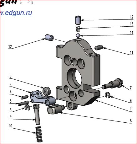

Well i successfully repaired my Leshy 2 9mm. I ordered a spare parts kit and after watching Ed’s video on indexing I measured both springs in the housing part #4 was 8.8 mm which should of been 10 mm and part #3 was 16mm the new one was 16.8 mm. Put it back together and cycled perfectly! 170 raptor reg 81 gr fx pellets avg 840 fps 126 ftlbs I get 2 mags on 470 cc bottle. Also I seated one mag and not the other both worked great very happy!!!!!!
