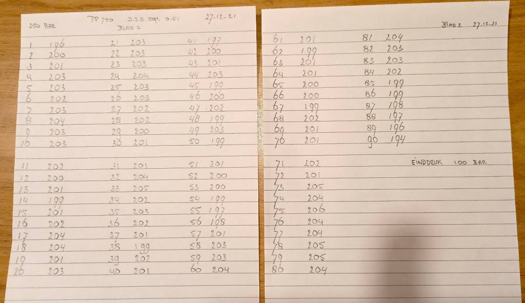

Because I had the suspicion that there had to be some more shots to get out, I went back to work with the rifle.
Since I usually shoot on the 10m track with this device I wanted to shoot as many shots as possible at a reasonable speed.
I've been busy with the hammer spring again, because in the last setting I got 10 more shots at a speed of around 227 m/s.
At 10m this can go down a bit.
So with patience (always in and apart) small pieces of the spring grinded off.
After a few small pieces off, there is 5 cm left of the standard spring which is about 6 cm
I wanted the hammer spring to be fully extended so that I always wanted a fixed position of the hammer spring
This is the final result of the grinder version: 85 shots at 199/206 m/s.
So a lot of shots with a reasonably good speed for the 10m.
Perhaps he will do it further away.
I'm happy for now!
:hi1:
Shotcount:
