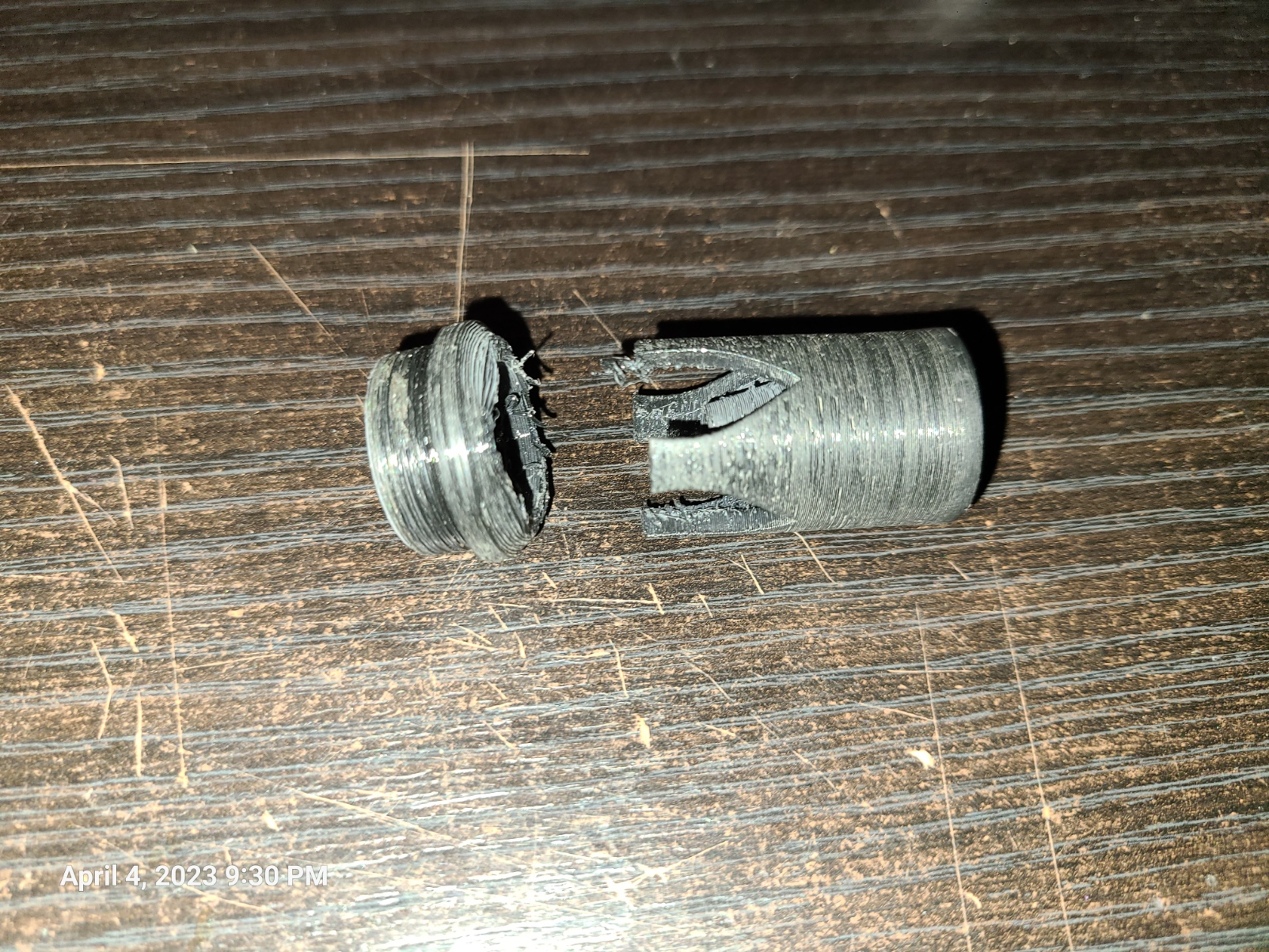

I was getting ready for the Cajuns Classic and I wanted to use the new vented moderator design but the dope was off on the closer yardages and I didn't have time to re-dope. I decided to go with the tried and true stripper, since my dope was pretty solid for it.
I got out to the bayou, had a slow start and then I got into my groove. Then, with four lanes left, I went into shotgun mode. Really struggled. Checked the scope mounts, stock screws, smoked crack, nuthin!
I was sighting in for day 2 and I reached out to make sure the stripper was tight. That's when I realized it had broken 3/4 of the way through and was hanging on by a thread!
Well, mystery solved. I thought I had packed a spare, but all I could find was the vented moderator. I had about 10 minutes to get re-zeroed and get the dope figured out. I think 20 more minutes would have been great. Surprisingly, I only did 3 shots worse than day 1, but it was not a good feeling having no idea where the pellet was going.

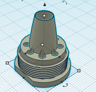

The vented moderator is also susceptible to snapping in half, so I went back to the drawing board. I was thinking I could print some baffles to go inside the HW97 muzzle tube, and maybe print a new end cap with some vent holes in it. I wasn't really feeling this, and as I printed the 3rd of 5 baffles, I had an idea. I really like the cone concept of the air stripper, but I don't want anything that is going to hang on the outside of the end cap. So why not make a vented endcap with a cone on the inside? So that's what I did.
When it prints, the cone is a little narrower and the air holes are a little smaller, but I'll test this out tomorrow and see if the concept works.
