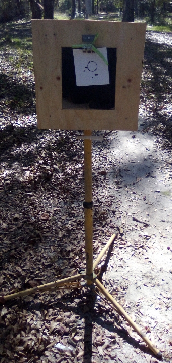

A cheap easy trap idea

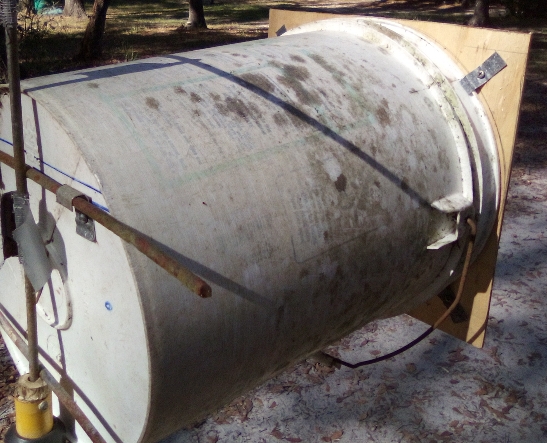

Had a round bucket with a cracked bottom so I figured I'd replace the laundry soap jug ..
Trailer trash trap 2-A ( tested)
Went with plyboard face this time.
Made quick remove clips to hold ply and same for stand mounting
Gett-toe, ©®tm2023, innovation on the cheap with shooters in mind. 😉
