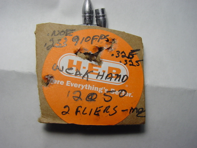

I kept this up util 6 adn 1/2 turns out adn at 6 and 1/2 turns out, it dropped from 910 to 880. Perfect for Air Use.

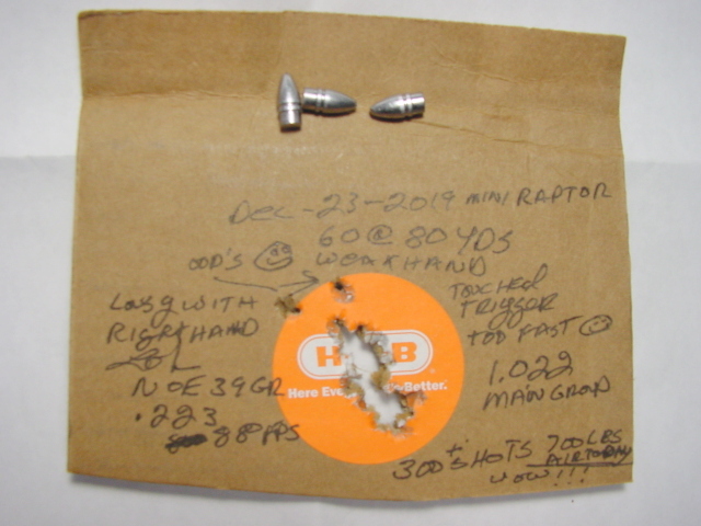

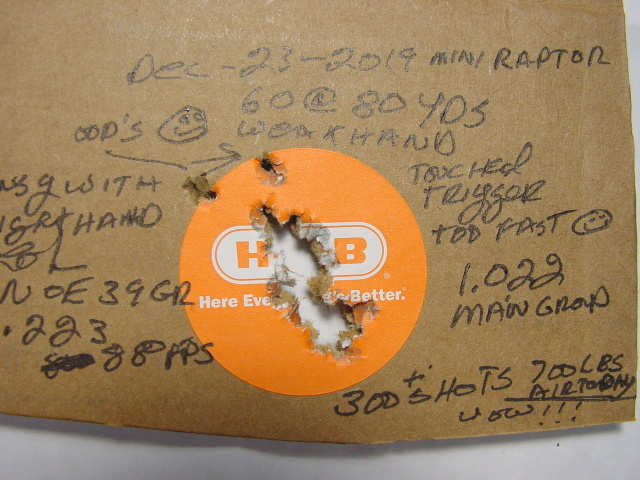

For fun, I Decided to try shooting right handed. I shoot left master eyed, so this was an eye opener. LOL
Someone ask for larger shot count groups than 5 so here they are, One at 50 yards, and one at 80 yards. Yes, I touched off the trigger a little early on a couple of them. Easy enough to spot. Really not use to shooting a rifle right handed at all. LOL

Frank, that sure is a nice group! Nice!!!

Very nice Knife. I had requested more shots per group. Thank you.

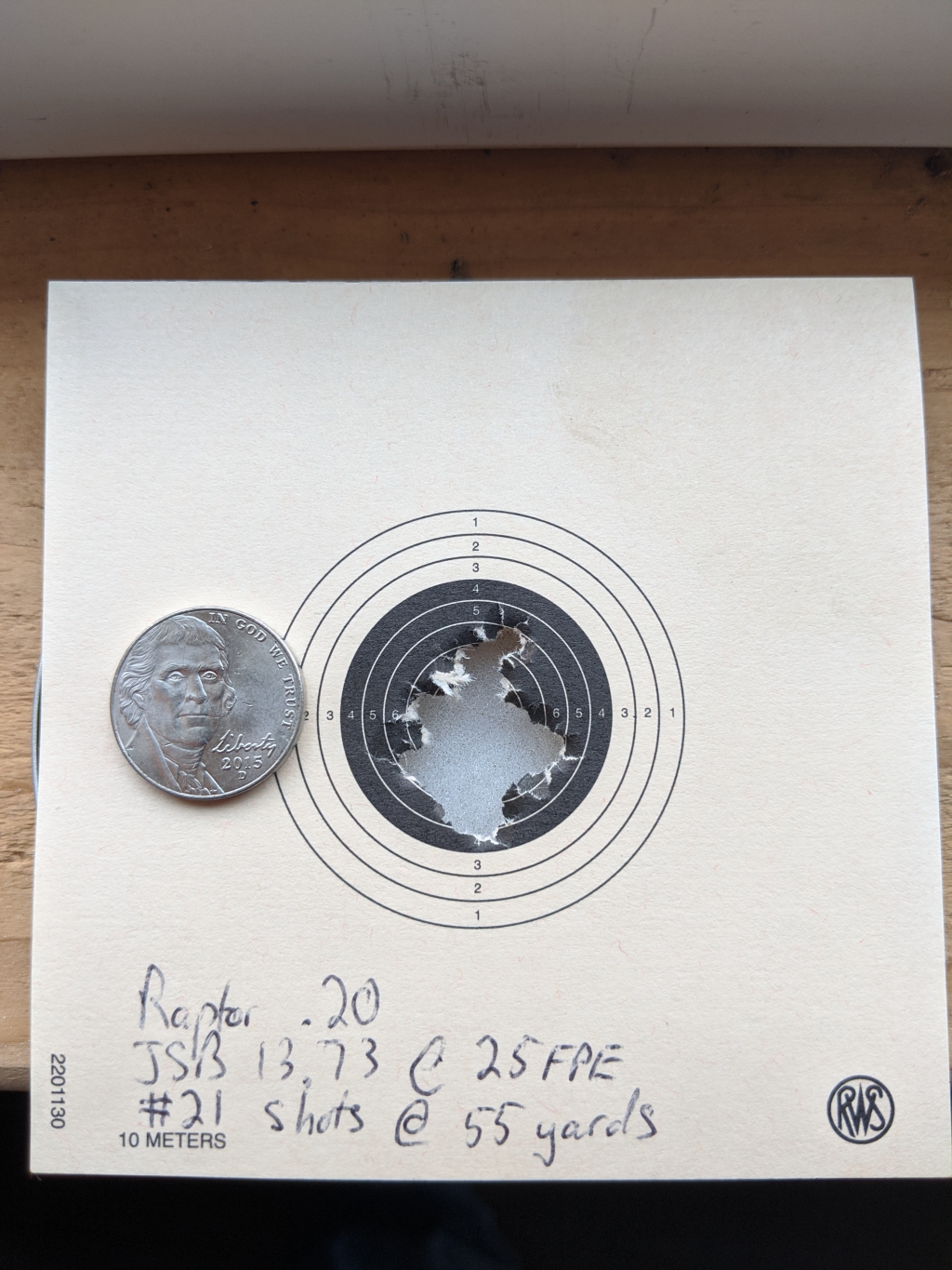

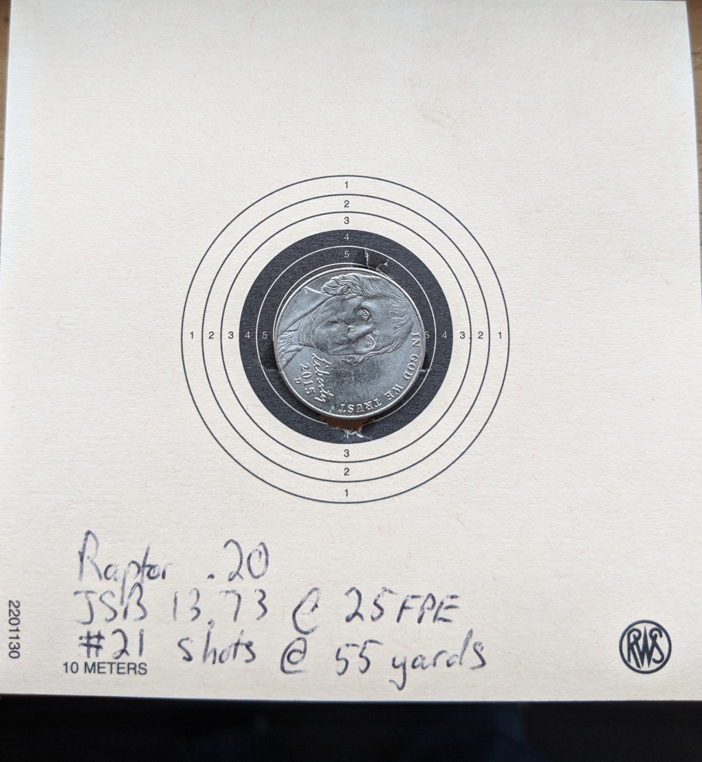

I posted this out of my Raptor a few days ago, but it seems it got buried in my ongoing review. Nowhere near the power yours is putting out, and only 55 yards, but sure put a smile on my face that day.
Lots of potential with these Raptors.
Oh my my,
A raptor in .20 is on my priority list for 2020 for sure!!! I saw the video of your gun getting tested before it shipped and was so impressed....iv been a .20 cal junkie for years and have never found just the right PCP in that caliber. But thinking the wait is over...lol. I have a huge stash of ammo including some of the new heavies.
