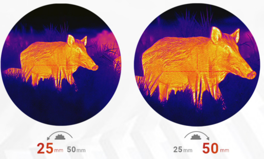

PARD Zoom series digital scopes include two focal lengths: 25mm, offering a larger field of view, and 50mm, providing a narrower field. This range meets users’ needs across various shooting scenarios. For example, a user can quickly locate a target within the broader field of view, and then switch to a higher magnification for more precise aiming. This design enables more flexible and effective shooting at different distances and in diverse environments.

(1)When the knob is set to “25,” it corresponds to the 25mm focal length field of view.
(2)When the knob is set to “50,” it corresponds to the 50mm focal length field of view.

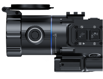

(1)The shift from 25mm to 50mm and vice versa is optical zoom. Between these two settings, In some positions, focusing is successful, while in others, it is not. This is normal.
(2)For observation distances ≥25m, switching from a 25mm lens to a 50mm lens does not require refocusing; conversely, minor adjustments are needed.
(3)For observation distances ≥50m, switching from a 50mm lens to a 25mm lens does not require refocusing; otherwise, slight adjustments are necessary.

The Zoom series offers two fields of view: 25mm and 50mm lenses. | Magnification/(x) | FOV/°(H*V*D) |
25mm | 1.3 | 14*14*19.8 |
50mm | 2.5 | 7*7*9.9 |

By using a mechanical device (such as a sliding ring or adjustment lever), users can adjust the distance between lens groups to modify the FOV and magnification.Note: Zoom Operation of the PARD Zoom Series
