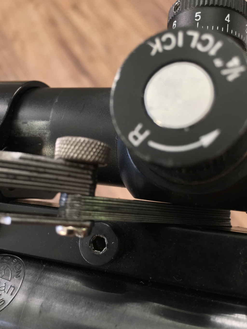

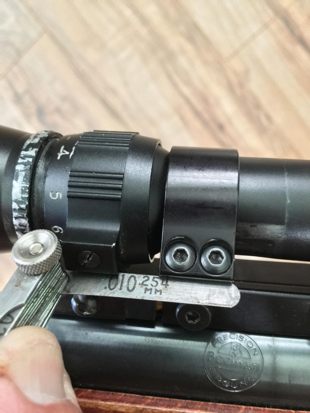

Now do us all a favor. IF you’ve taken the time to read this, then test a, or all scopes & please report back as to what you’re findings are. I’ll cover adjustable rings, shimming properly & setting a scope up correctly at next step should their be inquiries of interest. I’ll give you some hints.
Most guys new to air gunning over tighten their rings & ruin their own new scopes. You don’t use the long part of Allen wrench for massive leverage. You shouldn’t have to tighten rings beyond inch pounds if proper procedures are taken. This is PCP’s we’re talking about. Not springers which require more preparation, scope stop pin, buffer, a quality one piece adjustable mount like B-Square, 90% rubbing alcohol on dovetail, possibly preparation of mating surface with 1200 grit wet/dry sand paper & for goodness’s sake quality scope friction tape. Shims, inch pound wrench, feeler gauges are your best friends as is a indoor bench with the right color, thickness string, and background contrast. You’ll also need quality torpedo level & several calibrated tiny bubble levels out of their holders. They should roll across glass silently. You may have to clean, prep them also. Perfection isn’t quick but let us hear how many bent scopes you’ve bought first.
