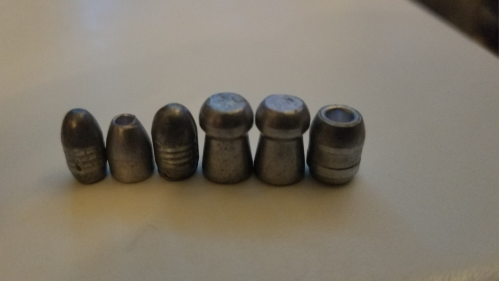

These aren't really hand picked just grabbed from their tins so be easy on me!
