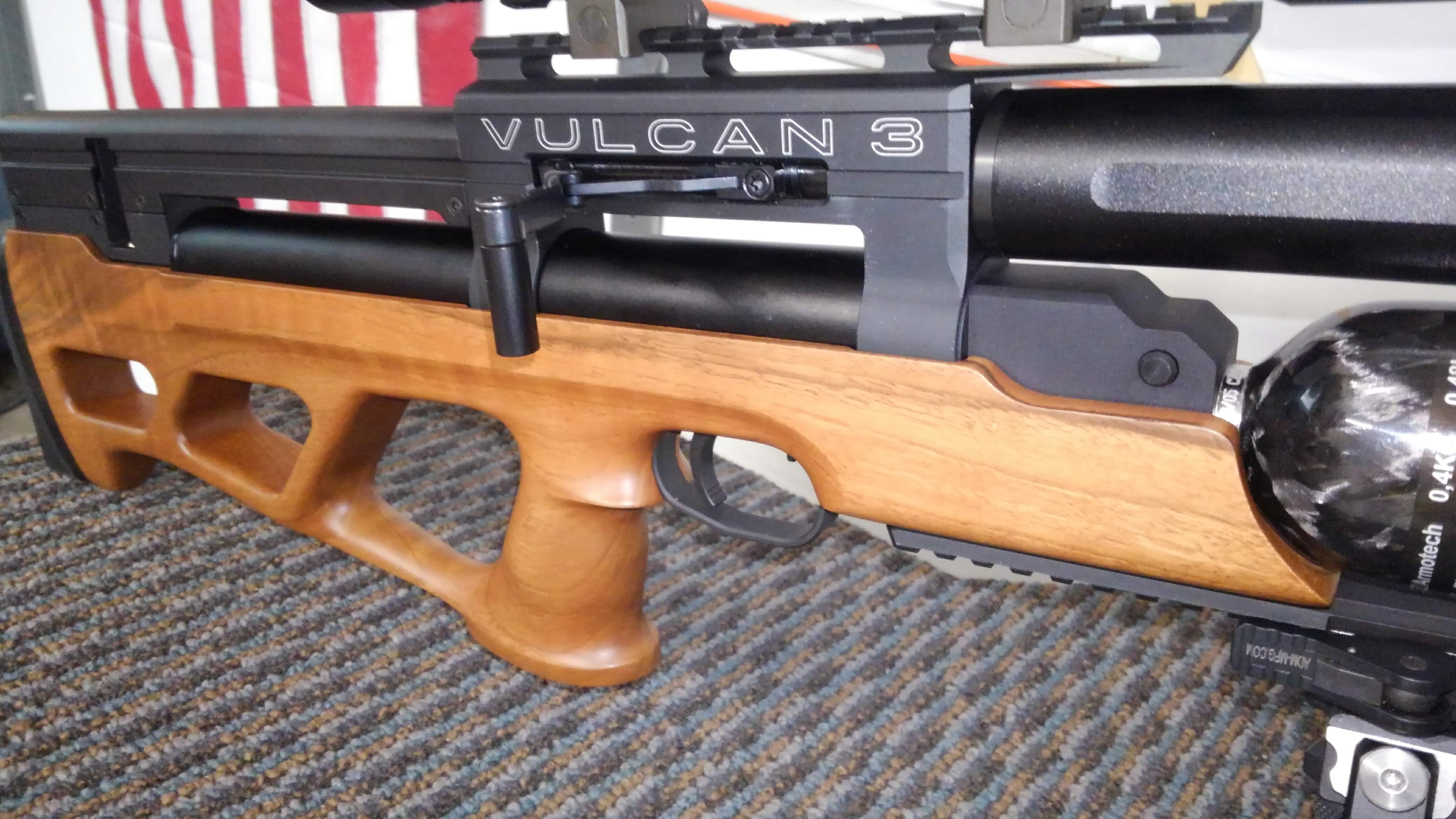

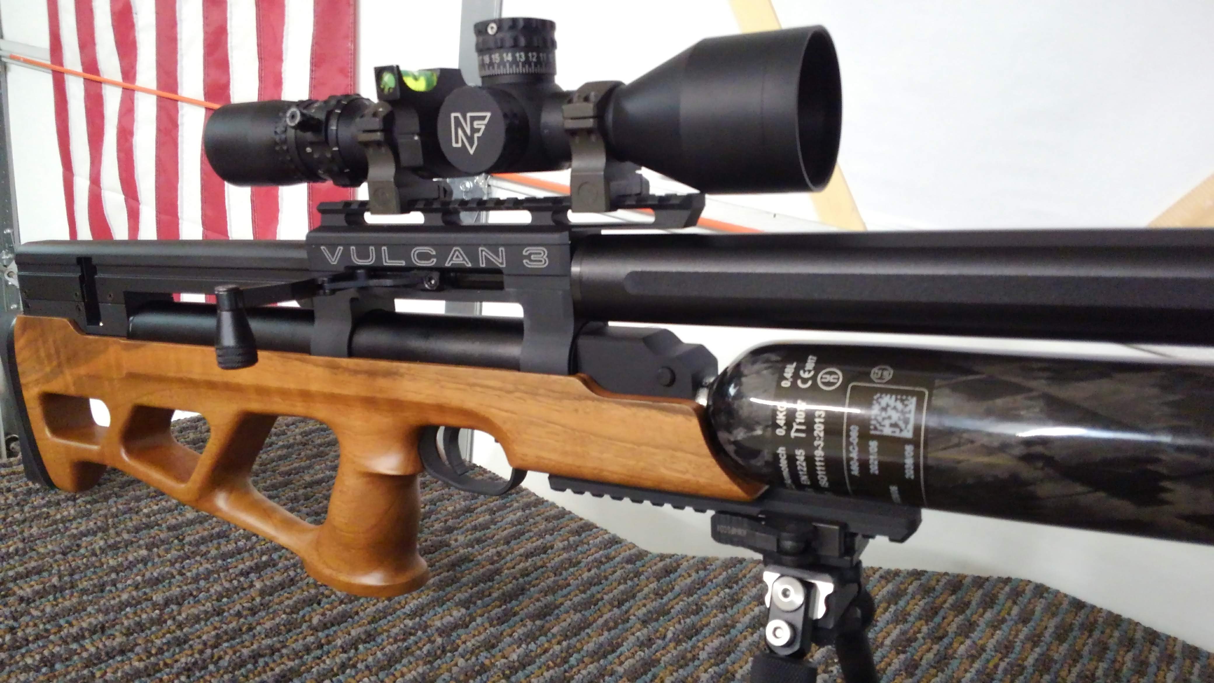

The other day I noticed the post about the Vulcan 3 cocking lever upgrade from Talon Tunes. Hmmm, $55 (edit I said $55, the correct price is $59.95 ) for a couple of drawer pulls and short threaded rod seemed a little pricey. So, I decided to investigate and was able to determine that the bolt for the cocking lever is M6 x 1.........................OK, that is the same threading as CZ and Bergara bolt handles. Started digging around and found that most were too big and contacted the plenum when fully closed. Then I remembered that some guns utilized a smaller profile knob and found exactly what I was looking for. This knob is from a Bergara BMR bolt rifle and fits perfect and has a very positive tactile feel. I think it's going to work out quite well. PS, I was lucky enough to source a depinger for the V3 from a fellow member and IT WORKS VERY WELL! Much less annoying ping. OK, story over.
before

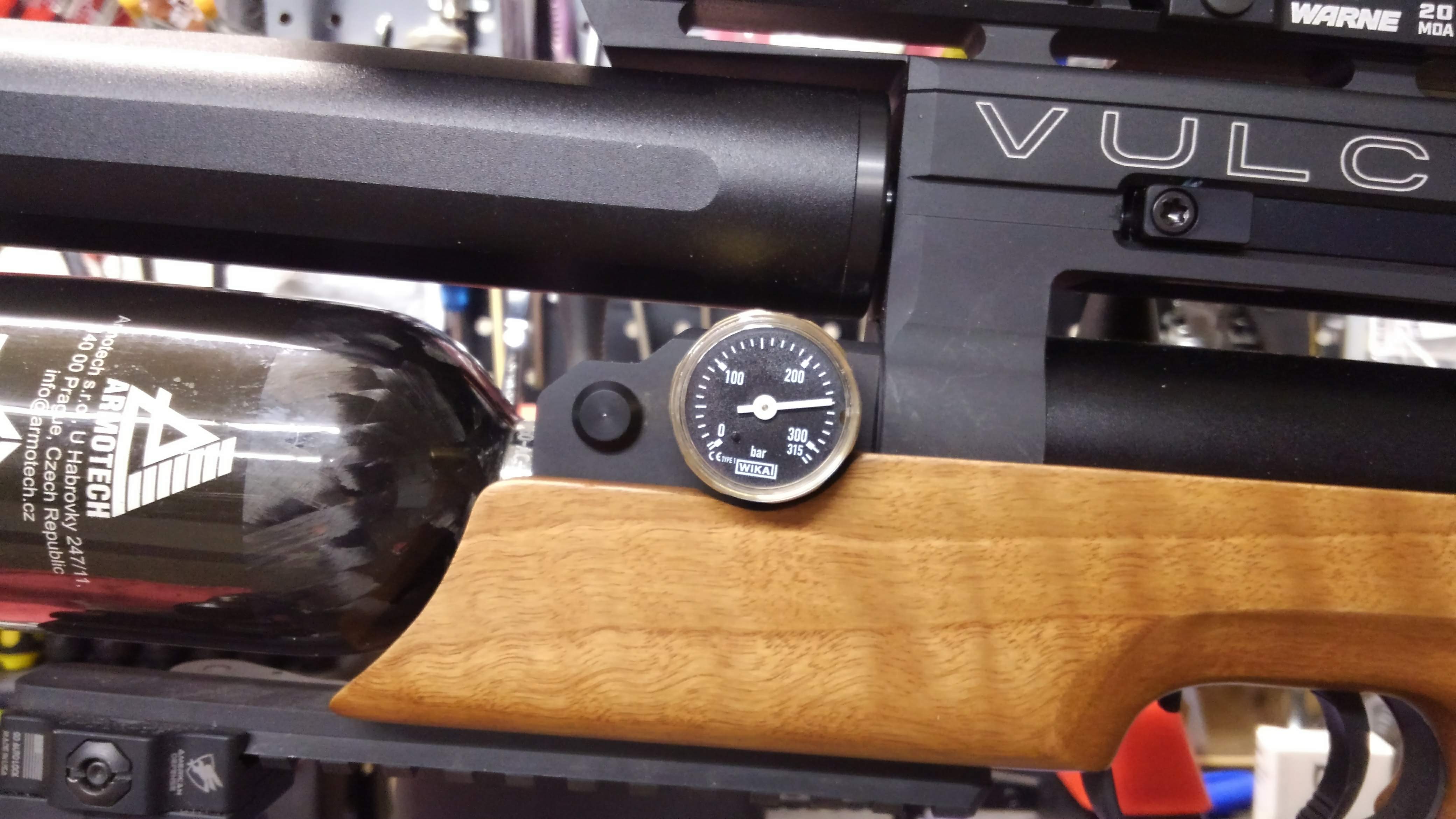

after:
before

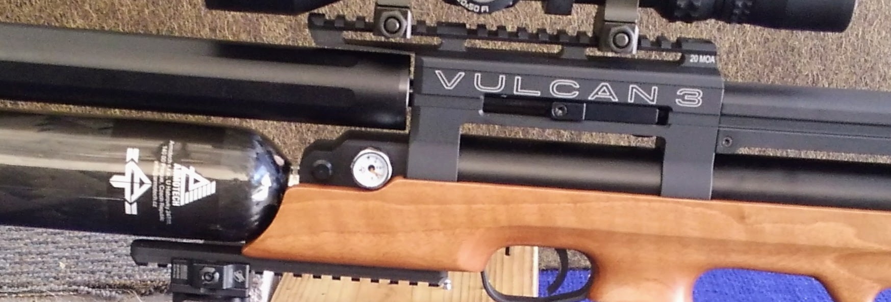

after:
