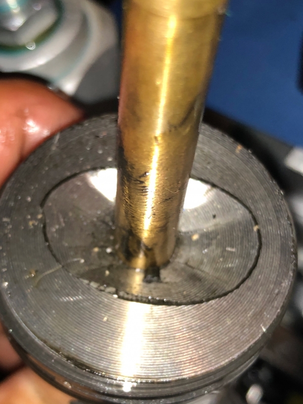

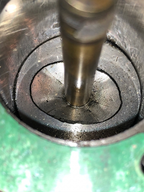

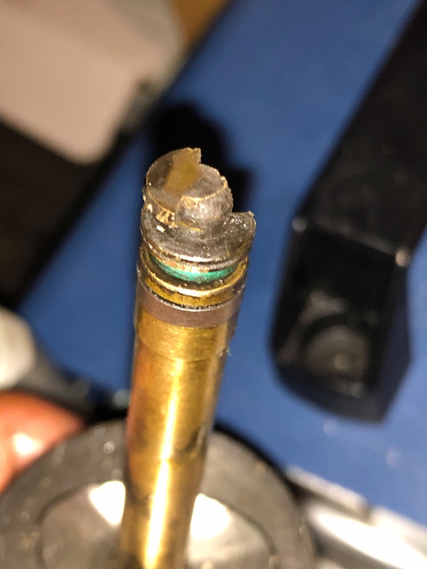

I guess I found the problem. Broken piston!
