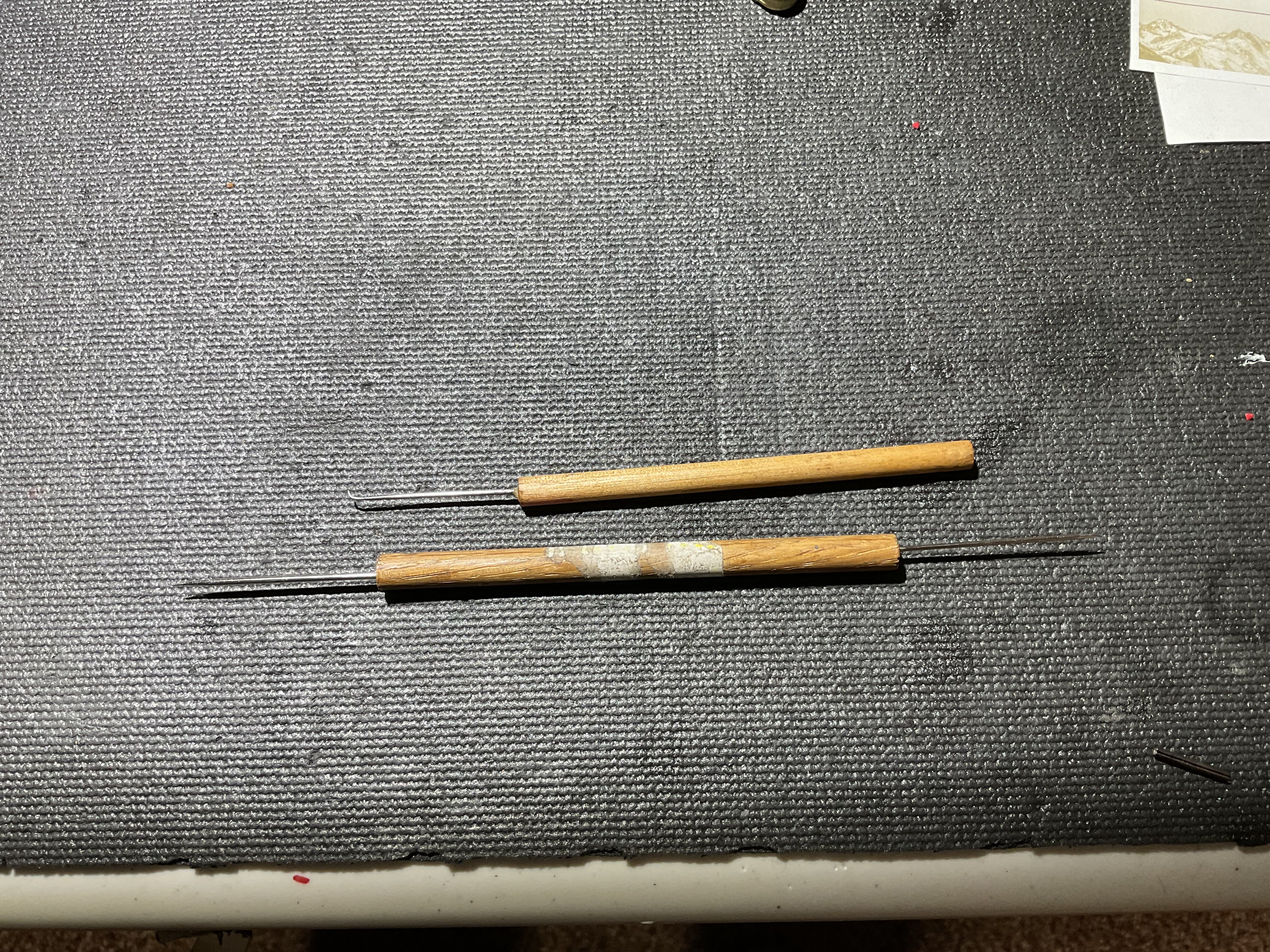

Update. Thank you all. You were great help. I made my own tool as VETMX said and I ordered a set of dental picks as Patrick suggested. Both worked well, but I found the real secret to doing this easily was to puncture, pry out and push down, not pull up. Continue pushing down and then twisting the 90 degree end hooking the then stretched O ring. Then, simply pulling it out. Just to prove that was the best technique, I did it 3 times.
Reactions: Feinwerk
Using a metal tool, whether brass, steel or whatever to remove an O-ring is a bad idea. Plastic.
You are of course correct, but my plastic tools were not sharp or stiff enough to make that happen. This ring is only 1.5mm thick in a 10mm threaded hole and positioned right at the end of the 20mm long threads Pretty much a first class bitch!
