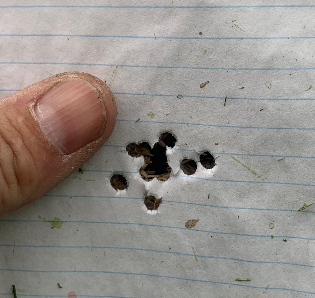

So, lately I've been testing the slugs at higher velocities and the results are getting better. I turned my regulator from 154BAR to 160BAR and tightened the hammer spring one more half revolution. This increased my velocities on average about 20-25FPS. I've already stated that I've had best results with the flat based slugs and that has held true at higher velocities as well. So, to the point. Today I shot some really good groups with the Varmint Knocker slugs in 30gr and 30.4gr. The best group I've shot in all of my testing came today with the 30.4gr FB slug at between 925-928FPS. I shot a bunch of groups today and the picture below is the best yet, a 13 shot group at 50yds. All of the other groups were pretty similar to this one, pretty impressive. If you aren't aware, slugs are not as accurate as the JSB's at closer distances, that really can't be expected. Pellets(Diablo) have a self stabilizing design which makes them great at shorter distances. They also have horrible BC's which again makes them best suited for shorter distances. Slugs on the other hand are stabilized by the twist rate and velocity. They have terrific BC's, some upwards of .099, which make them best suited to longer distances. Luckily, with my gun sighted for the 33.95 MKII's, the 30.4gr slugs shoot about 3/8" high with the same zero. Works out almost perfect... I can shoot the MKII's out to about 50 yds. and use the 30.4gr. slugs at longer distances with the same zero. That is very, very lucky because all of the other slugs tested with the exception of one or two, had POI that were no where near the zero I use with the JSB MKII's. Some are 3" right, 2" low left, 3.5" high, you get the picture. They group well but the POI could be anywhere.

For the record... my fingernail is 5/8" across. This 13 shot group at 50yds is about 1" and 10 of the slugs are about 3/8". The other groups I shot today were similar but a tad larger overall. Certainly tight enough groups that I'd feel confident taking shots and smoking ground squirrels at 150+ yards! I'll give it a shot, or lots anyway!

1554349357_4587616075ca57d2de8bde7.83332377_IMG-1421 30.4gr. slug super group!!!.JPG

You the man!
Really. Thanks for the summary
