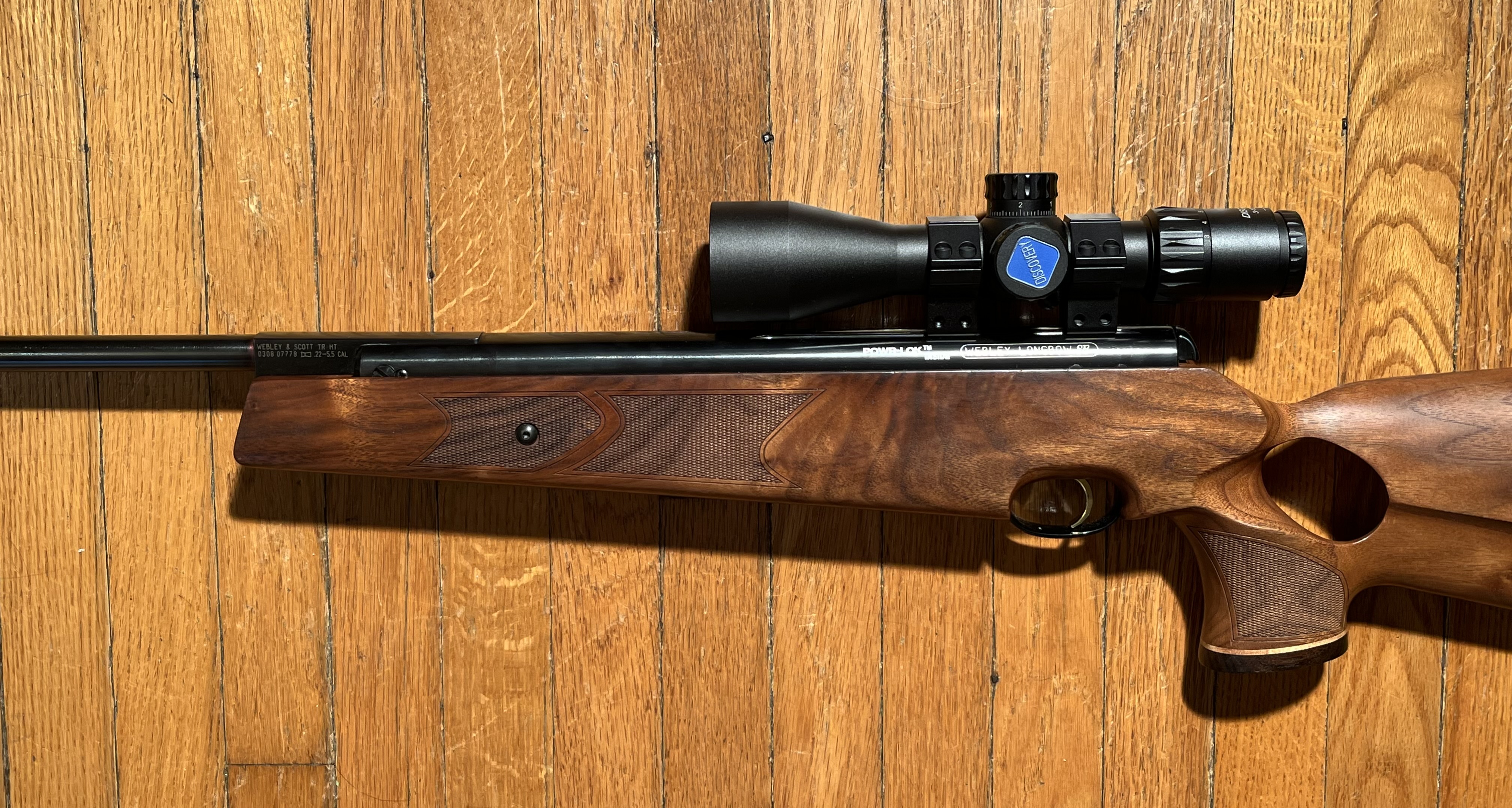

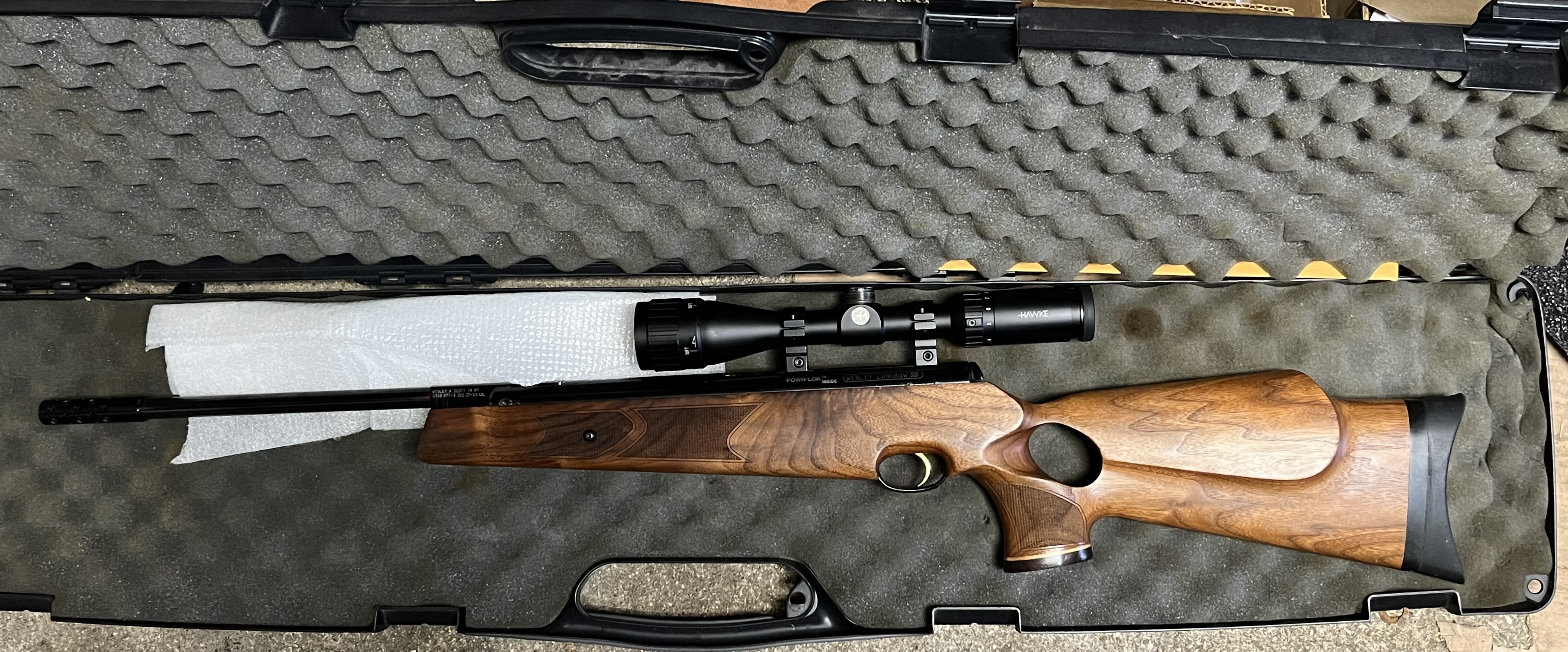

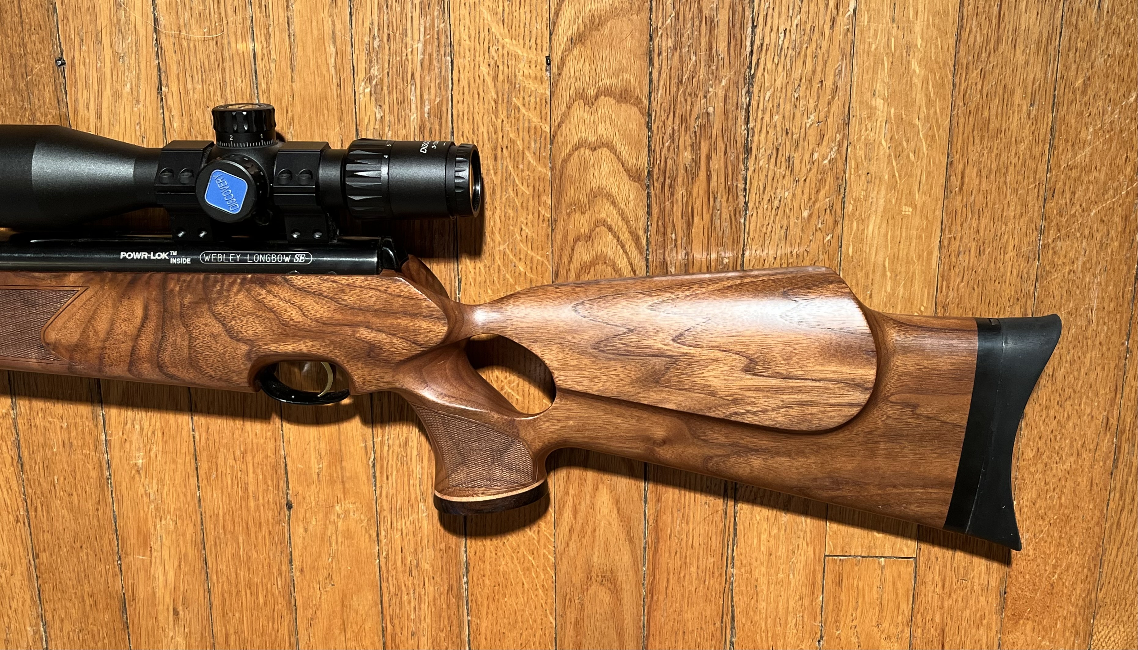

I always knew it's assembled in Turkey. All Longbow SE's were. The trigger is the same as the UK assembled guns. Long before I bought it I read up on them on UK forums. There are some mixed reviews so I knew what chance I was taking to buy it. Most of the negative opinions seem to think it's a Hatsan. Having never even seen one.
This one obviously shoots very well with the current set up. No regrets.

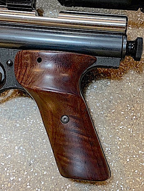

I bought a brand-new Turkish Longbow decades ago. Won't speculate if it was Turkish made, Turkish steel, or Turkish fairy-dusted, but it had pretty WALNUT.
It also had one of the worst triggers and firing behaviors of any of the hundreds of airguns, and scores of sproingers, I've owned; both 'qualities' falling somewhere in the same ballpark as Chinese Lion, Mendoza, and Philippine.
The Turkish Longbow did make a pretty good trotline weight :oops: (after removing the stock to make pistol grips out of).
