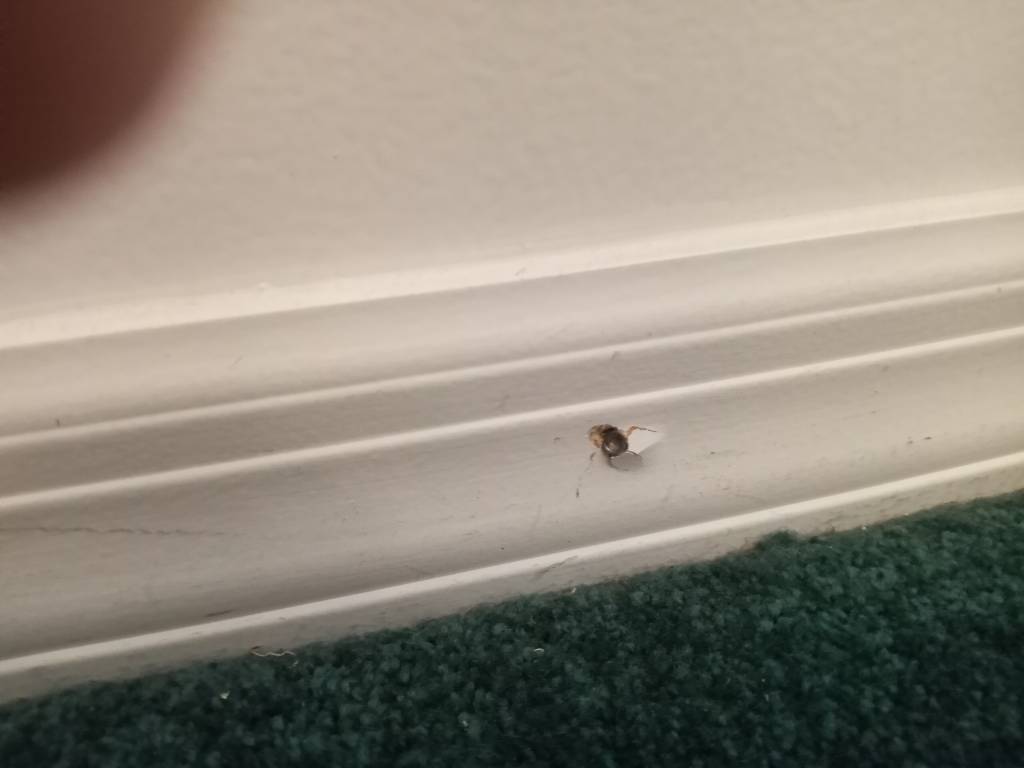

inevitably holes wind up in things trying to shoot in the house lol .. ive seen small metal traps though, its hitting the glory spot every time thats the issue indoors ... right now i have one of those 'specialty nails' holding one of mu baseboards on haha ...

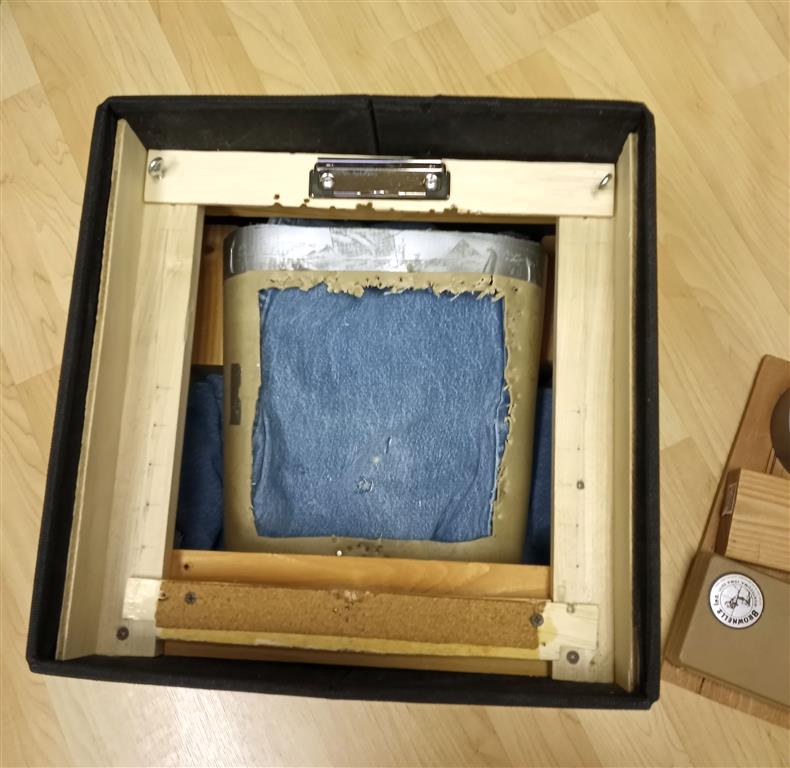

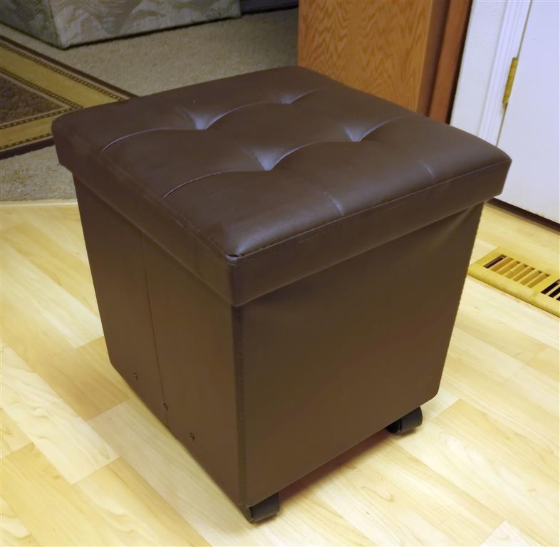

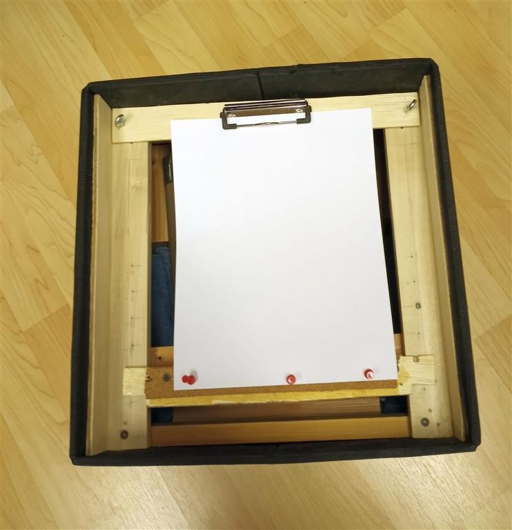

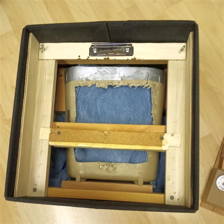

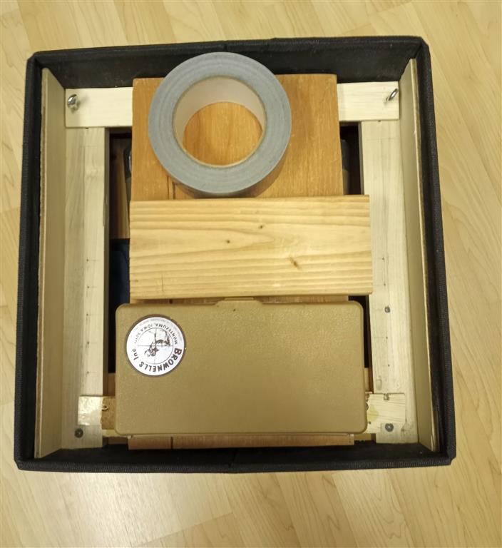

Since I got into airguns some 15 years ago, I've lived in a city where shooting outside is not allowed and in a triplex with neighbors that share common walls. My airguns are quiet enough I could shoot indoors and I had an ottoman type foot stool that had a storage area inside. I modified that ottoman which had solid wood walls and floor but was covered in a cloth exterior. I used it for velocity testing and initial setup but also for offhand shooting practice. My belief is that offhand shooting distance doesn't matter but consistancy does (especially with a springer). Anyway -- that cloth exterior got really dirty over the years so I bought a replacement and retired the old one. This new one turned out to be nothing like the old one's wooden framework (sides and bottom) so I had to modifiy the new one in many ways. I use old jeans held in a small trash can as the pellet trap (really quiet) and have a thick belting backstop on top of a solid wood floor. I used 8x11 paper with a weight on the bottom to tension the target, and set the angle of the trap using a 2x4 which is stored inside when done shooting.
If I could go back before I ordered this ottoman I would make sure it had solid wood walls and floor but this works for my needs now.
