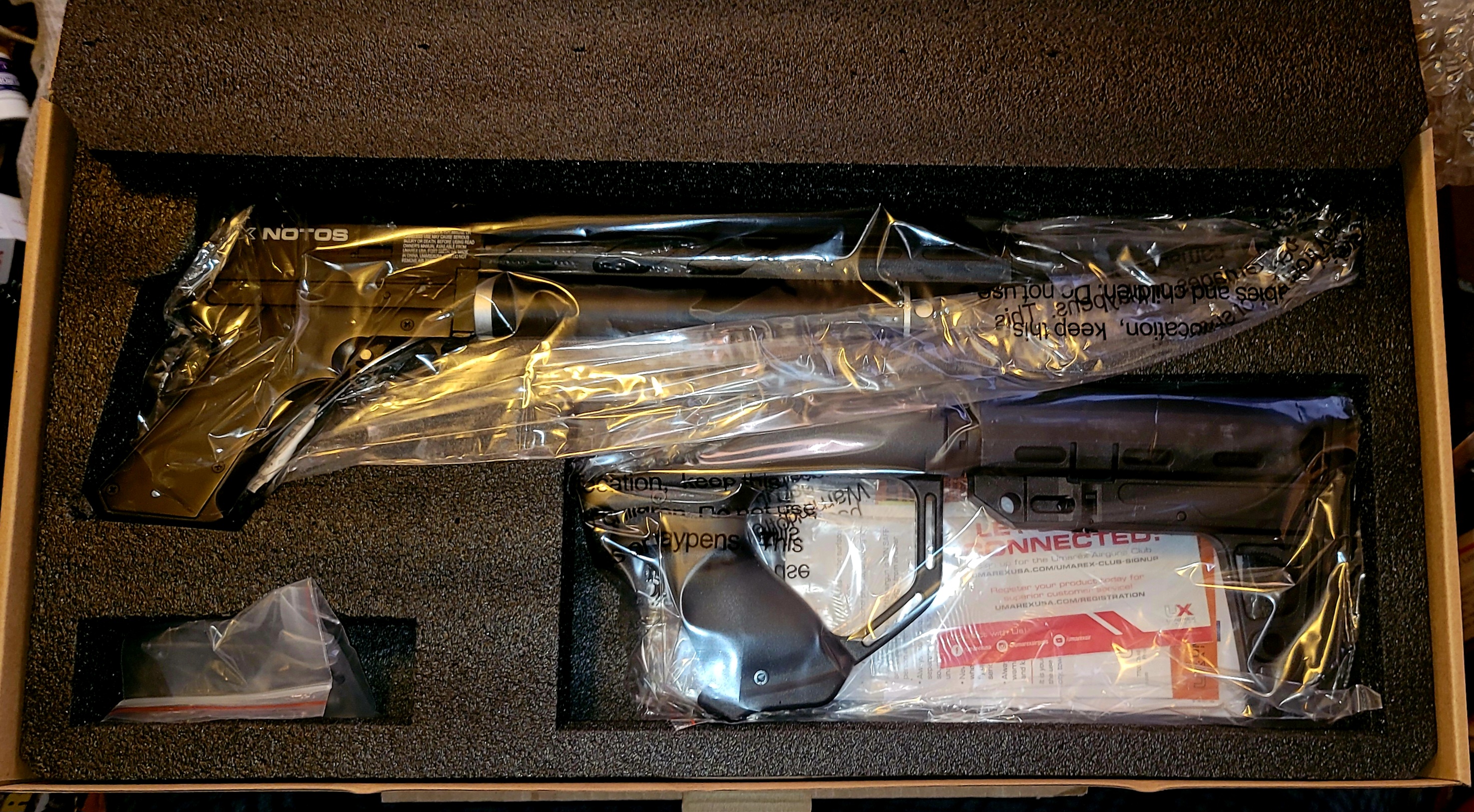

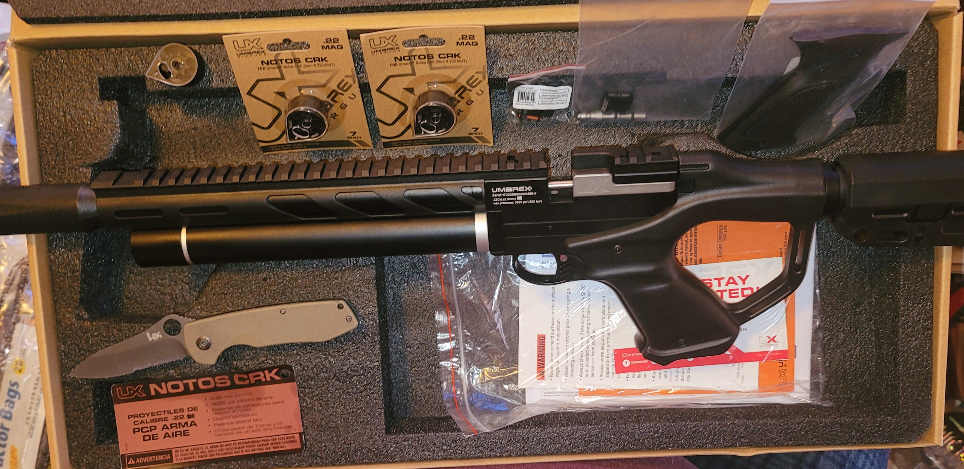

They came nicely packed. Decent presentation. Cardboard outer box, foam cutout insert holding the airgun and included accessories nicely.
Open the box, the receiver, barrel, rail, and fixed moderator are in one clear plastic sleeve/bag packed in its own cutout. And the grip/stock in another. There is a separate small zip lock bag with 4, 2.5mm(?) Allen screws to attach said grip/stock. Followed by another zip lock bag containing 1, (Yes only 1.) 7-shot mag and fill probe.
I'll be frank, I don't care for the tiny, quarter sized diameter 7 shot mags. The clear cover is kind of sloppy fitting. Yes, there is a small set screw that can be adjusted bringing the tiny detent outward to help with the slop. But, it causes misalignment when feeding the mag into the receiver if adjusted incorrectly. I'm thinking I may try a tiny o-ring under the face plate provided the friction doesn't hinder the mag spring and rotation. That's all trivial I suppose. Main thing, they work.

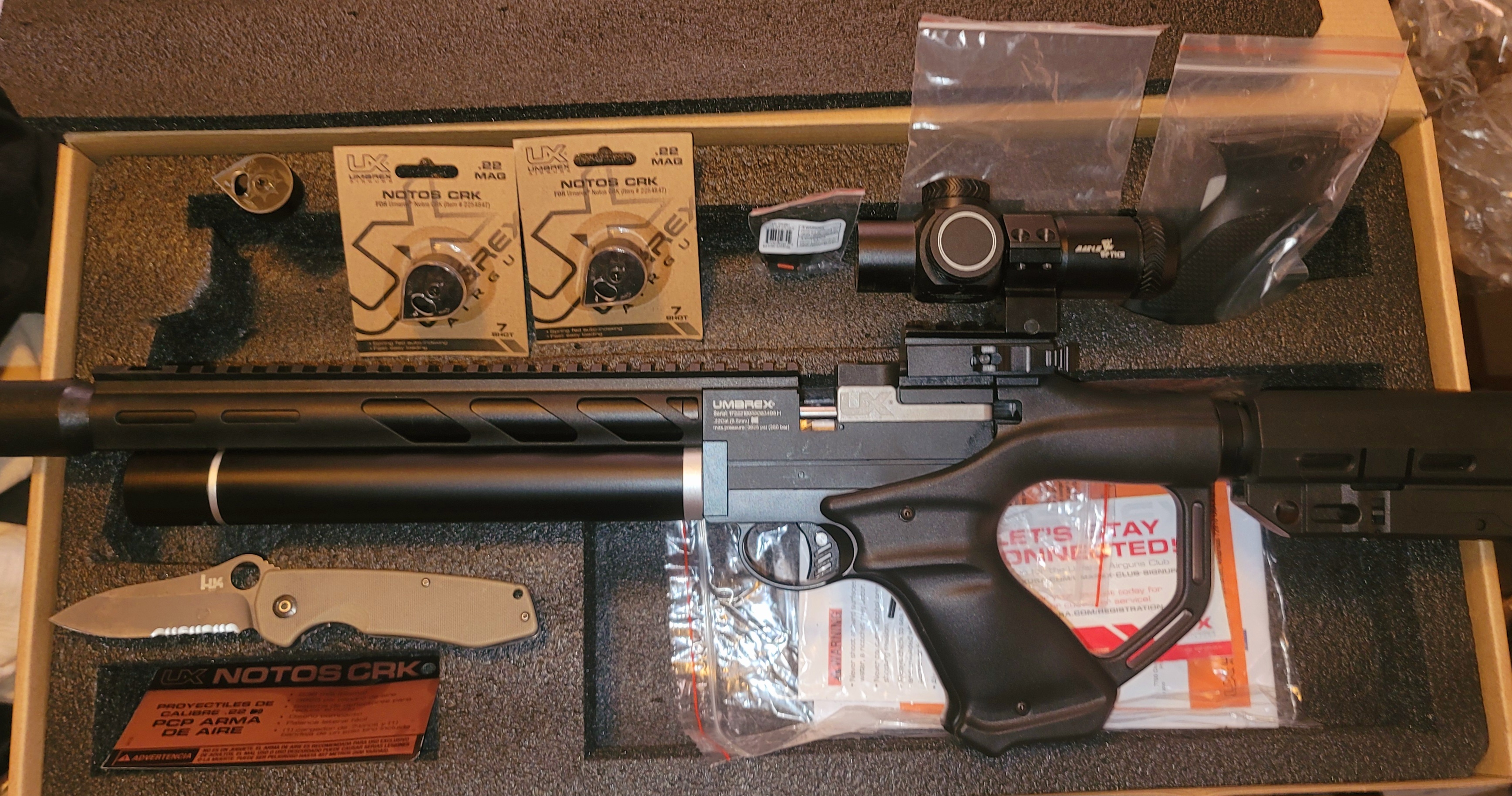

I mounted a March Optics 3x28 micro scope on top as I'm only planning on 10-20yrd engagements within the confines of barns and out buildings. This March Optics 3x28 has a medium width etched glass crosshairs with hash and mil dots. It's a simple, not too busy reticle perfect for pesting up close. It's also red/green illuminated. Just under 5" in length, was the perfect hood ornament for what I intend to use it for. (60 bucks shipped Aliexpress)
