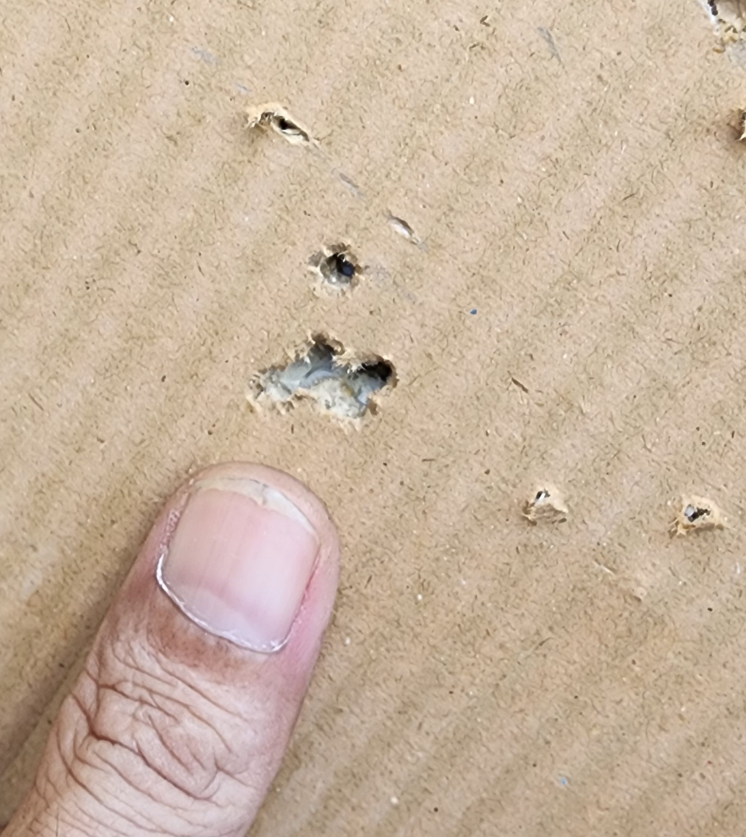

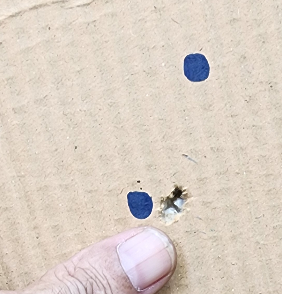

Just to start, I decided to test the barrel. If barrel is bad then no use to do any work.
So made a barrel Bush that has transfer port and makes the barrel indexable.

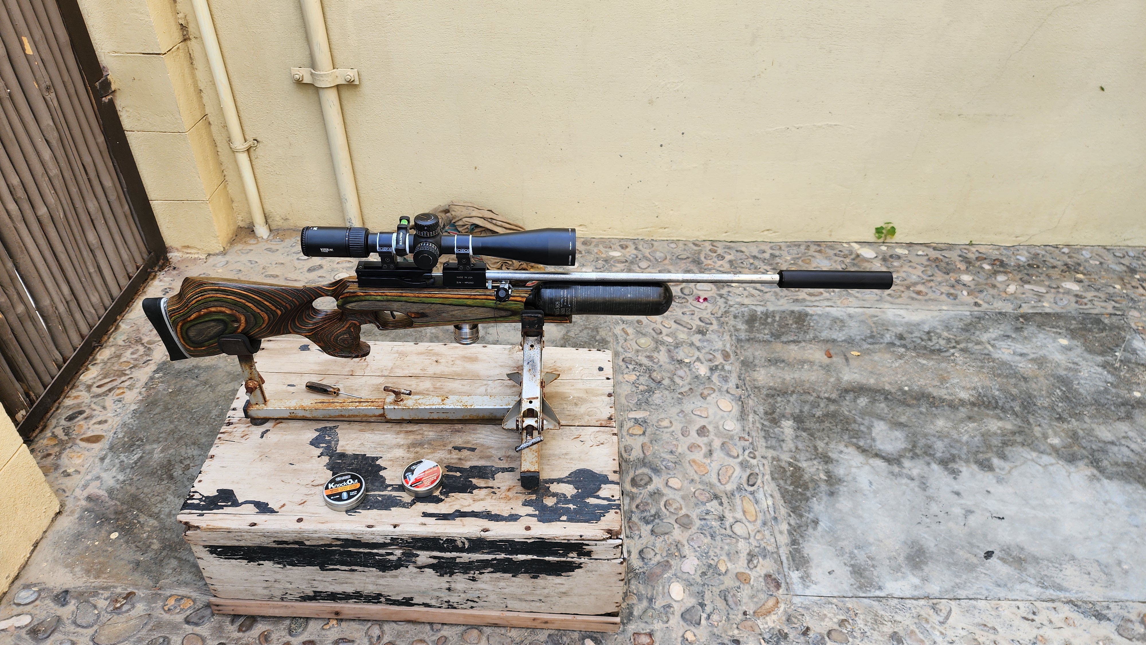

Then installed the barrel in my own RAW.
Following is some shooting with this barrel at 24 yards with Redesigned 25 grain pellets and Knockout slugs.
I feel that the barrel is reasonably good so now we can move on to work on other ruined parts of the gun.

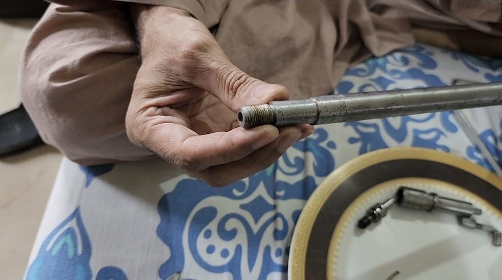

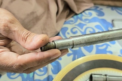

Following are two pics of the RAW barrel as it had been received. The user had finally got sick of RAW and had tried to machine the breach end of the barrel to accommodate it in FX Crown.
Very poor machine work.
Following is the pic of muzzle end of same barrel. As per my understanding Martin didn't use to thread the muzzle end for LDC. So looks like some extras work has been done here too. But here the quality of work is better.
I hope that now members would know that why I had to sleave up the breach end of this barrel to properly fit into RAW.
Most of the things are screwed up.

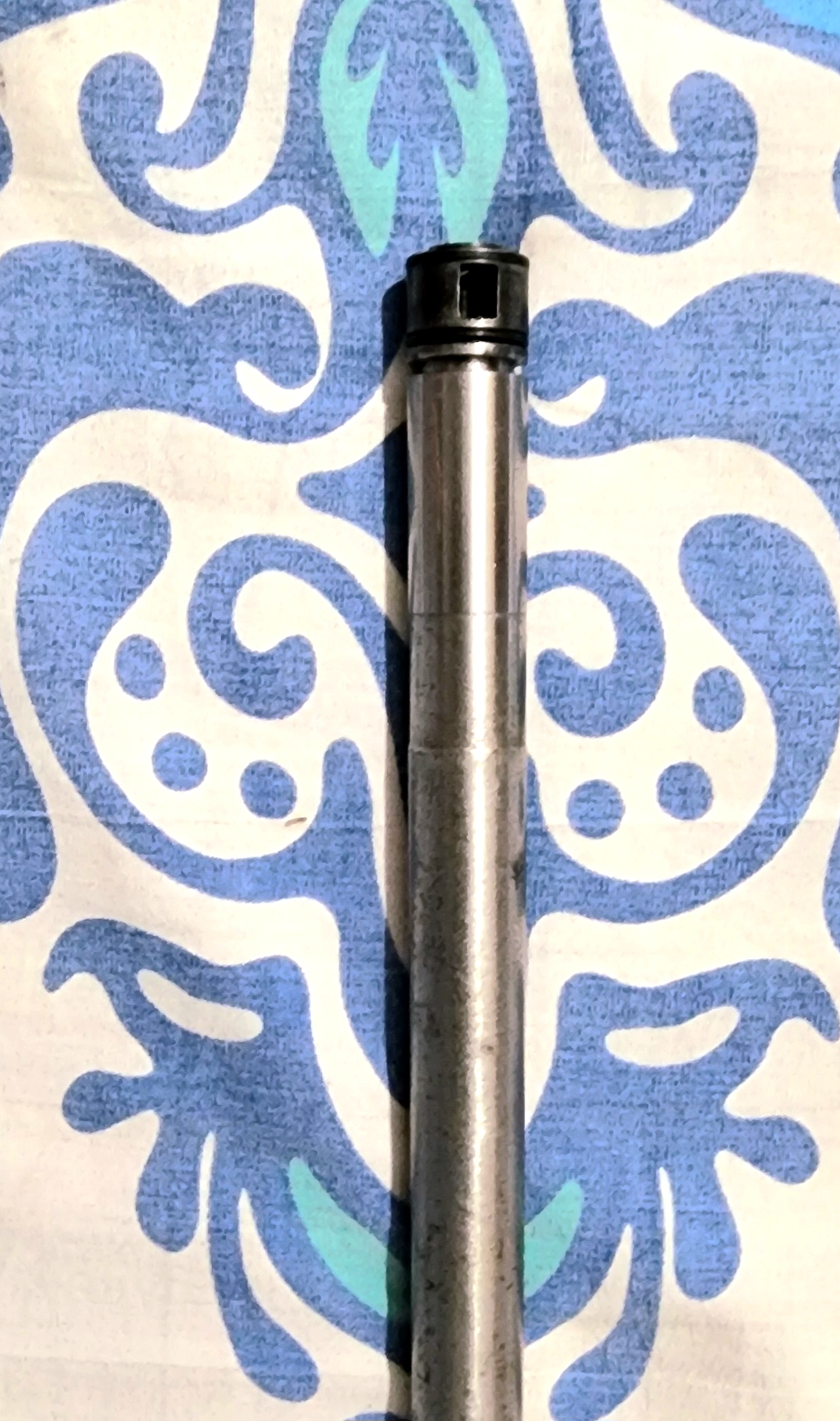

I converted the breach end into to the following by sleaving it up.
