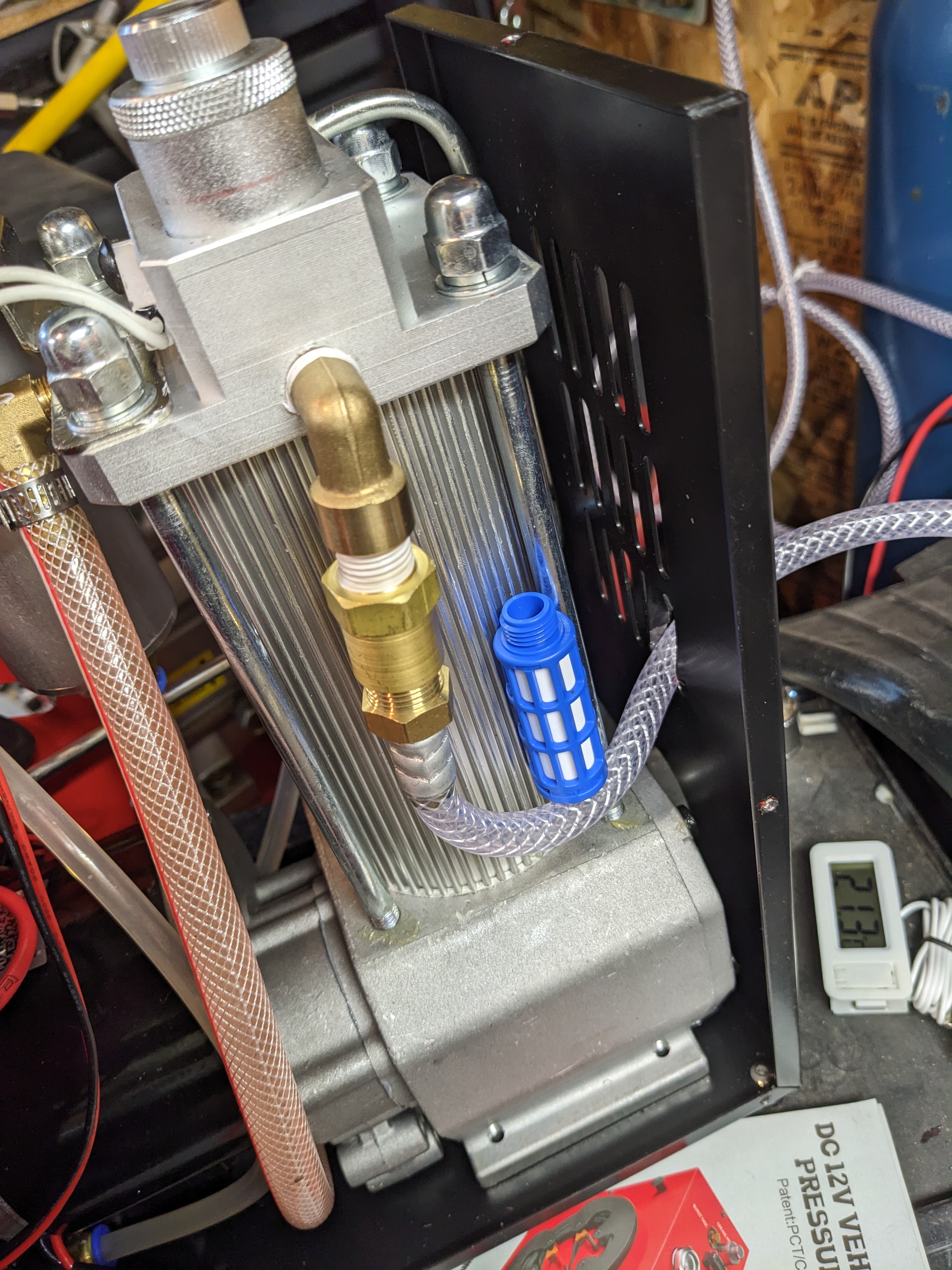

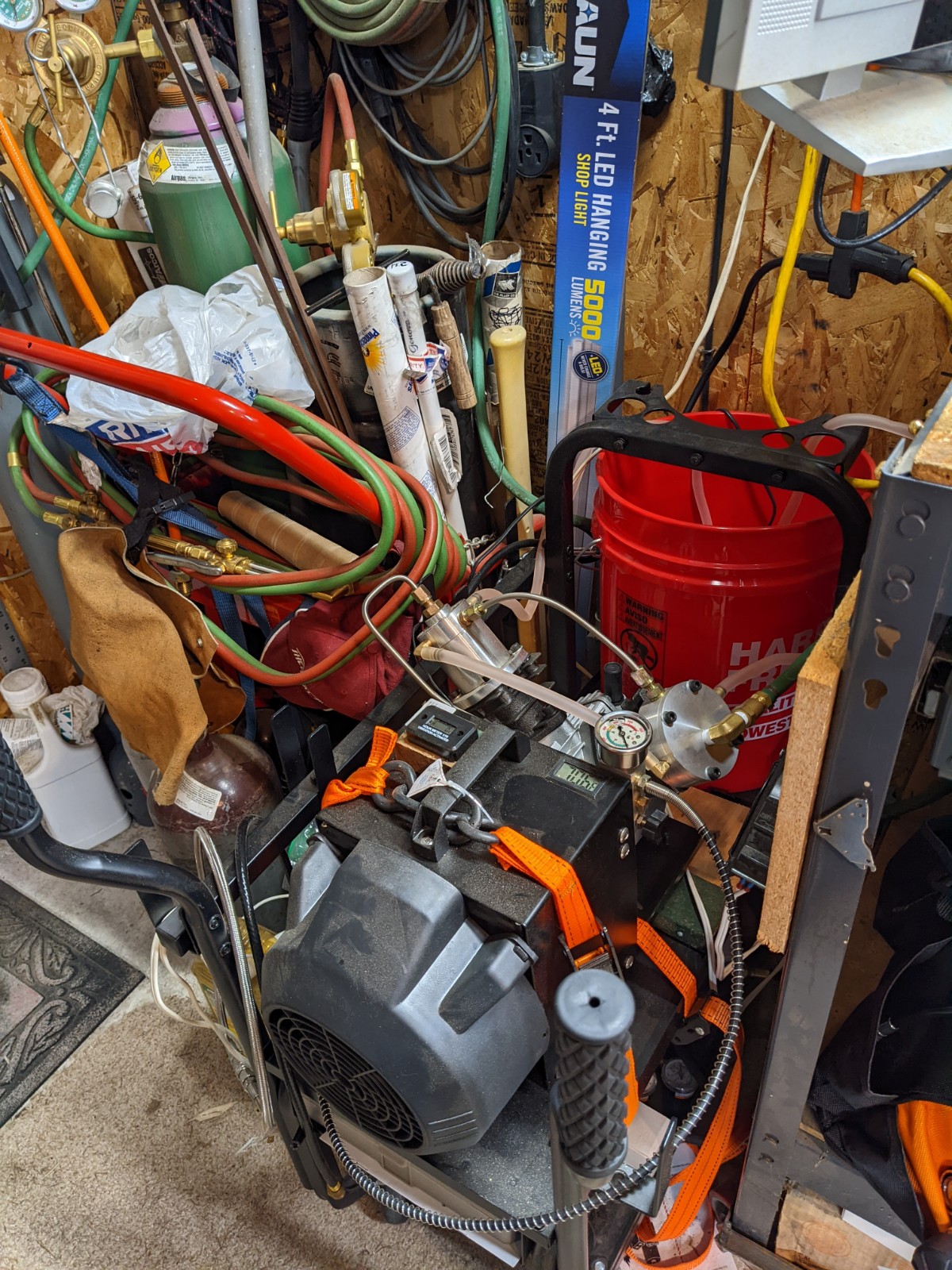

Nitrogen is the way. You need a tank a 40cuft would be a good start, also need a regulator that you can set to about 10 psi or a flowmeter at 20cf hr
a piece of hose from the regulator w/fittings for you compressor all compressors have a single air intake port most that I have seen are 1/4" npt inlet
The GX cs2 need a 1/2" fitting for the handle intake, Tuxing ,Yong Heng and gxcs4 are all 1/4 inch.
