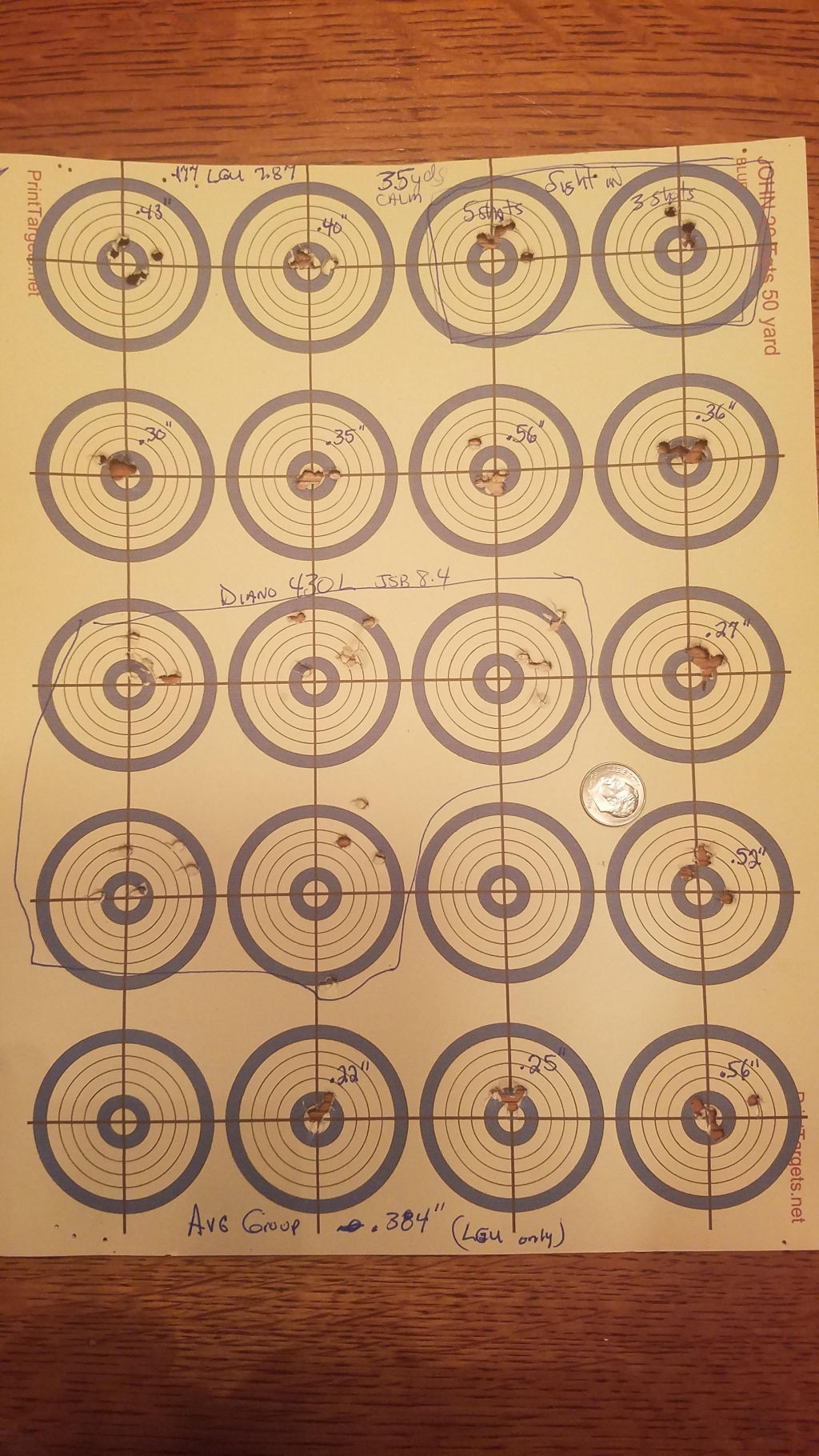

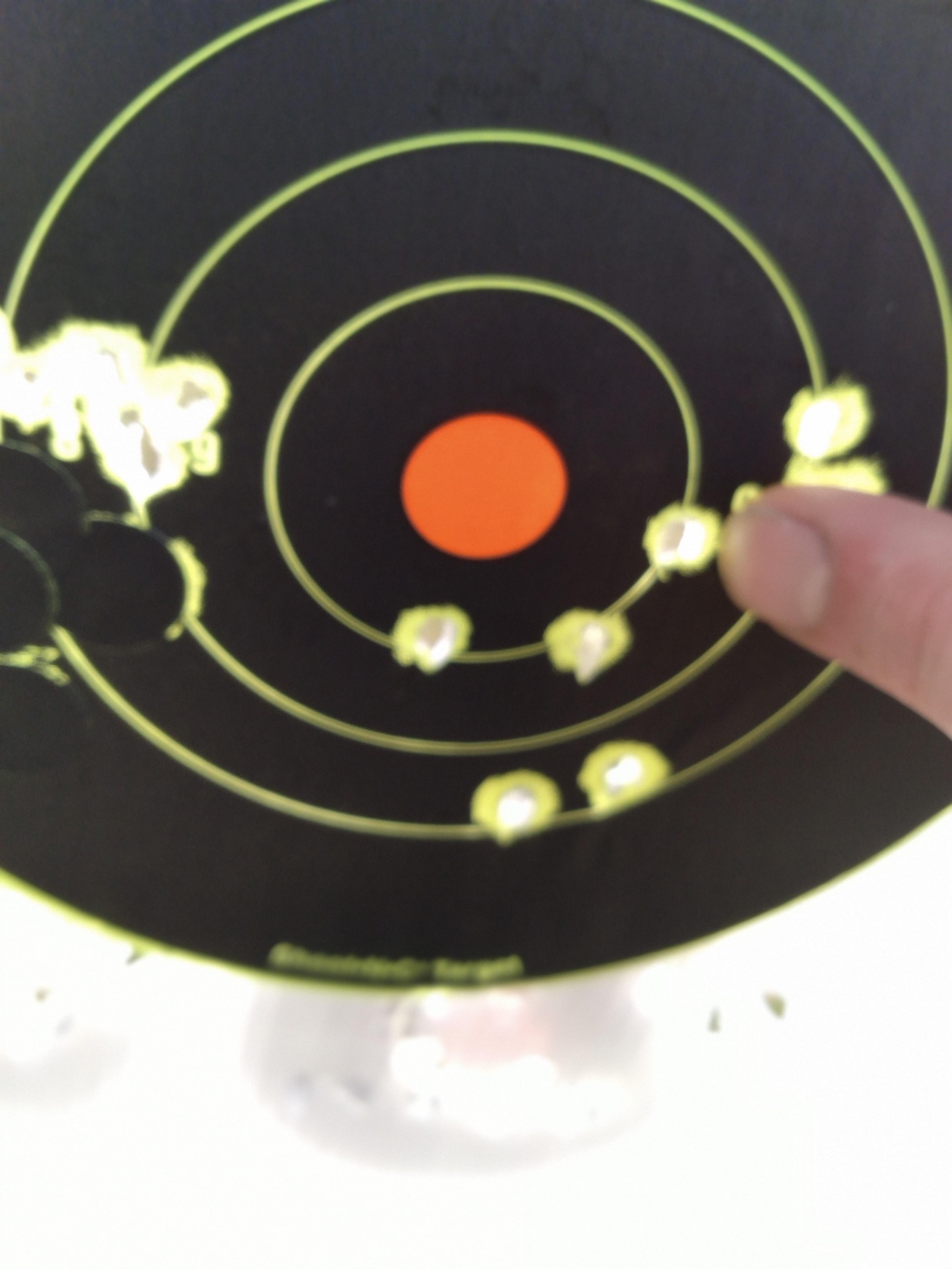

My LGU is shooting pretty well, my go-to springer, a pleasure to shoot and very, very accurate... slightly more so than my very nice ProSport. It likes the JSB 7.87 or Air arms substitute, shooting about 860 fps with them. The gun is stock, untuned... I adjusted the trigger to make it lighter, but it can't touch my ProSport in that. It's slightly twangy too, but it shoots so well I'm not sure I wish to mess with it. I shot 11 groups at 35 yards (in addition to 2 sight in groups), 5 shots each off a sandbag.... average of them all was .384, just a bit over MOA. It certainly is a 1/2 inch gun at this range, although there a a few just over dime size, most are smaller. I think the gun is shooting above average.
The other 5 groups were shot same day with my new Diana 430L. I was unshootable when I got it with a harsh metal on metal noise to cock it, a grinding and scraping throughout the stroke and return. I tore it down and honed a few spots, cleaned it up (almost no lube) and then hit it with Krytox and Tar'd the spring. I adjusted the trigger a touch and it was certainly MUCH nicer to shoot, actually quite pleasant and it seems easier to cock as well?! It prefers the 8.4 JSB.
Here is the issue, it is not shooting anywhere near what I think Diana should be able to do in terms of accuracy so I'm hoping for some advice. I don't expect it to compete with my LGU, but I do feel it should shoot much better as I now have about 400 - 500 rounds through it. Groups are 2-3 x larger and I feel too much so for this level of Quality. Is this an unreasonable thought? I am trying to decide if I should recrown, polish the barrel and do a full tune/hone/lube. Not sure it's worth it... do you think a gun shooting like this can be tamed and shoot nearly as well as the LGU? The trigger is much nicer and the shot cycle seems fairly pleasant now so I want to have hope, not sure I should. Thanks for any thoughts.

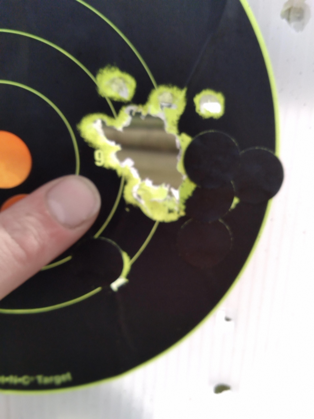

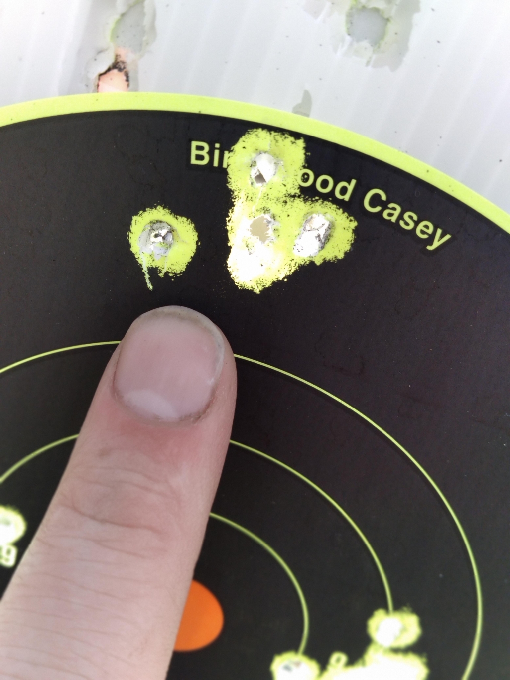

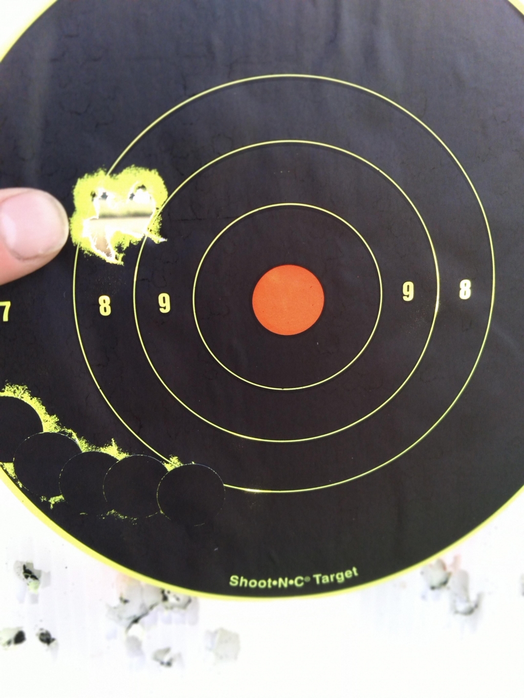

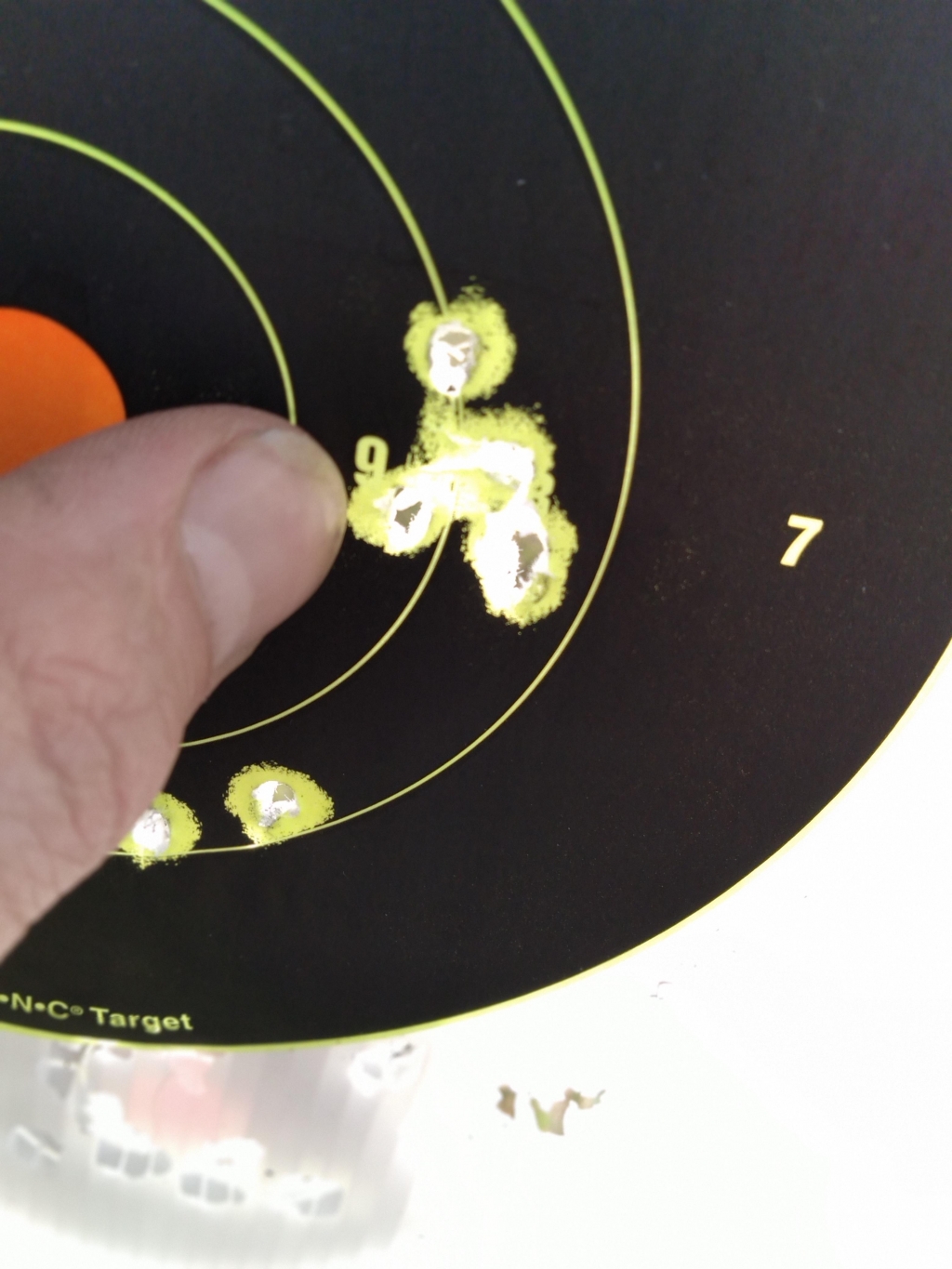

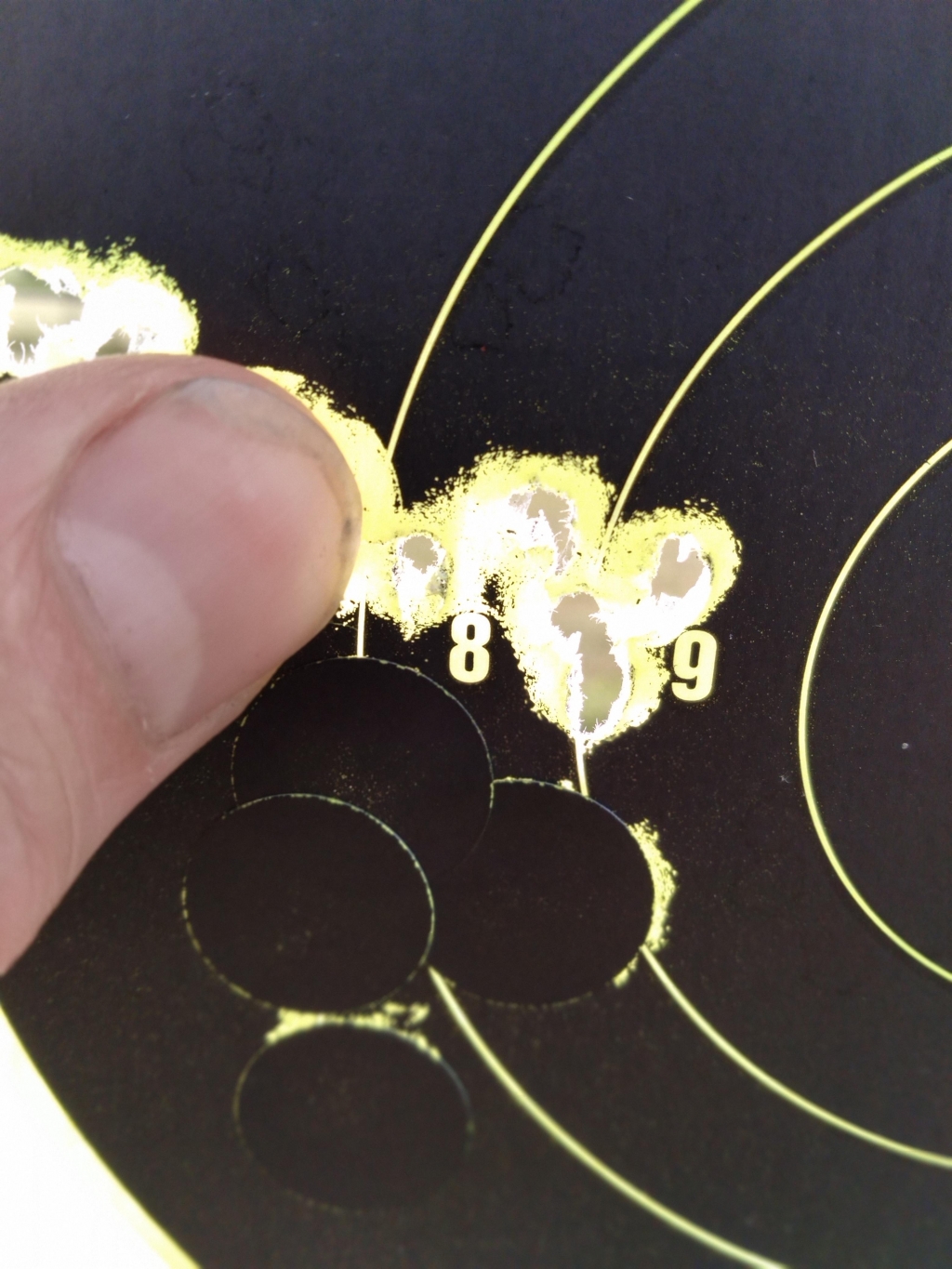

I've had a d430l since the aofa sale and absolutely love mine! Thought this might help as a baseline...
5 w its favorite barracuda hunter in 4.50 hs:
5 barracuda hunter extremes :
5 air arms 10.34s in 4.52 hs:
5 w/ h&n ftt in 4.52 hs:
Only thing it did not like was crosman destroyers(5 in classic big box break barrel shotgun pattern lol!):
My conclusion is mine shoots a fair amount of variety with consistency!Testing was @ 25 yards, winds 5-7 outta my 1 o'clock.
-Jake Kingsley
Wow,
that is what I was expecting for groups. Both of you are saying the heavies may be the way to go, the Hunters being 10.5g. Clearly some of these guns can shoot. I'll check all the screws and try some diff ammo (.177). As a note, I did try all the usual suspects in standard weight... (JSB 8.4, 7.87, Barracuda, CPHP, CPL, Some chinese rounds that seem to shoot well, FTT's and a couple more). I have not tried pointed pellets but may do so after I get some heavies through the gun. Stil, I'm suspecting I got a dud? My Gamo CFX shoots better than this, not to mention my ProSport and my LGU. Well at least I can shoot the heavies and see how it goes.
I appreciate all the photos, really helps and the advice from you guys. I'll keep trying but if I have no luck, I'll need to figure how to get at that barrel.... do a full inspection and maybe a poor man's crown and polish job. Otherwise it might be for sale cheap! :)

I know the thread is dead, but wanted to update. I tried a bunch more pellets and checked all the screws, tried different holds, bags, scopes, resting points.... etc. Finally I did what I thought might be needed all along, I pulled off the muzzle break and had a peek into the crown. What a mess! It looked like a meat grinder had been at it. I was not surprised but the level of damage did impress me. I just could not imagine a gun leaving the factory like that.
I did the 2 minute screw-in-a-drill fix. I have a couple of paste abrasives and had at it. I first used a dremel to knock off the big gouges. ( I do NOT recommend this, but the gun was useless so I figured what the hell). Then to the screw/paste/drill.... gave it 30 seconds of heavy grit and 30 seconds of medium. It did not take long, I did not bother to get it polish smooth. I did it handheld as well, so maybe not the perfect job. I just wanted to see what would happen. Re-assemble and shoot... WOW! First group was 1/2 inch at 31 yards. Hmmm, shoot 5 more five shot groups and they are all very good, some near MOA. I then get back to testing pellets and it looks like H&N Barracuda FT and more so the FTT's are the best. The FTT even fits into the breach without falling out, which is a nice bonus.
I intend to to a proper crowning, and polish and then a better lube/tune. I think I have a winner! The shot cycle is very nice, cocking is not so bad when you get used to it and can get a "technique"... (Fast and short). Trigger is great, and the accuracy is now excellent, and it sometimes reminds me of my LGU in that regard. I have hopes to get it shooting slightly better. Seems to need a cleaning pellet down the barrel pretty often, maybe 75 shots. POI is steady, gun is now a pleasure to shoot. It's small and light compared to my other springers, and a short snappy shot cycle is somehow satisfying. No or little twang, really enjoying it.
