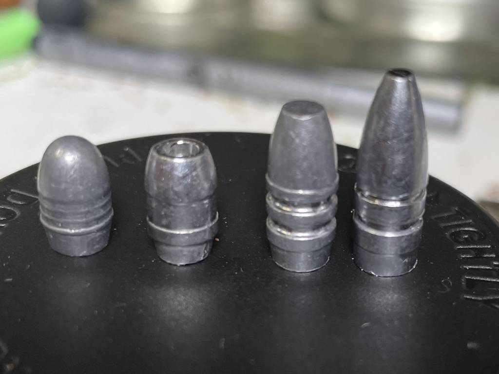

I was able to find two molds when I started this whole thing, and one of those two is still available as far as I know. They were 25 caliber - The two on the left in the picture. The one on the far left can be purchased from MP molds I don’t know how well it will shoot in different platforms though. Seems to work ok in my Air Force barrels. Second to the left is from NOE and they have been out of stock for a year or more. These shoot very consistently for me.
More recently I had two molds made by arsenal one was a 257-420 boat tail, the other an 85 grain Spitzer. Arsenal molds are made to order and the first one took two months, as they warned me it would. The second one came much quicker in spite of that same warning. Pic attached…
