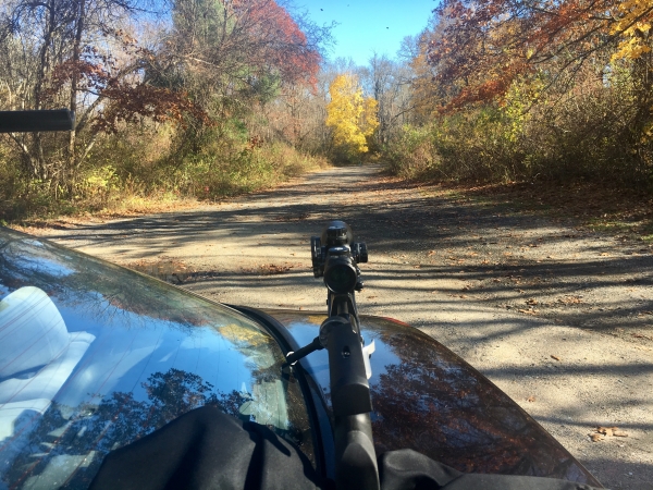

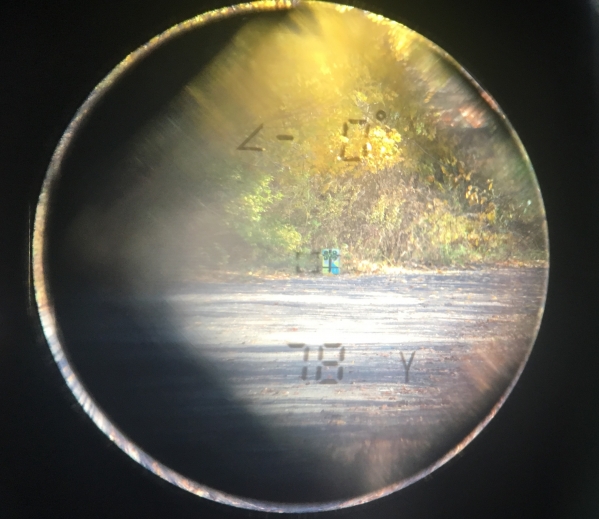

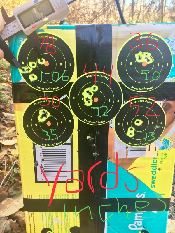

OK, how about some pictures? Had some long shots today too, battled decent gusts but was pretty impressed. All shots were centered on crosshairs except last group was one dot mil hold over (from what I could tell..) at 12X on my mini scope - tough to see at 78 yards!
Hoping to close up those groups and analyze a whole lot more. One side note is I ordered 4 tins of those 25.39's and many were damaged, one tin almost completely unusable.

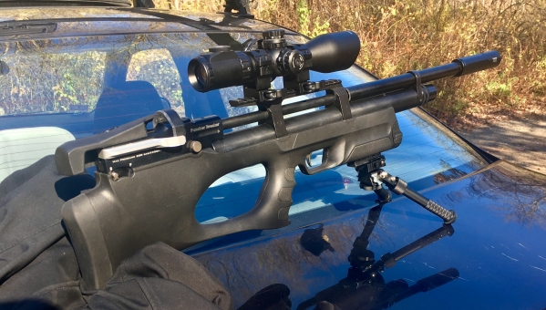

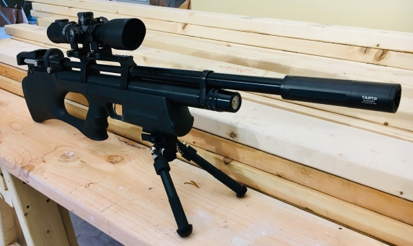

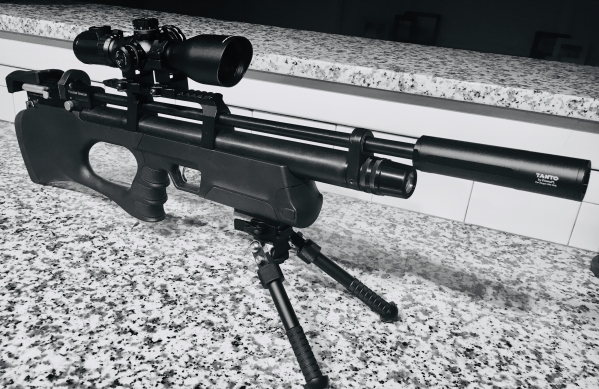

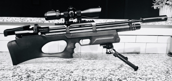

- Kral Puncher Breaker .22 base platform
- Troy Hammer Tune, designed for 45fpe (currently shooting 50fpe!)
- Trigger adjustment
- Enlarged transfer port
- Modified power adjuster
- Upgraded cocking lever
- Modified valve/hardened stem
- Quiet kit - I turned shroud backwards and removed the baffles/spring
- Bunch of other stuff to make it sweet (?)
- Donny FL Tanto LDC
- Cleaned barrel
- Added Atlas clone bipod
- Reinforced and epoxied bottom picatinny rail
- UTG SWAT 3-12x44 compact glass etched scope
- Shoots JSB's pretty gnarly

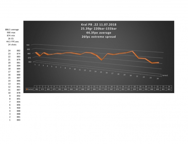

- This is a hunter and set up for 36 shots (3 full mags) at 870fps with 25.39 Monsters for 43fpe from 220bar to 155bar
- I think I've had some spring setting issues, tweaked the hammer to about 24 shots at 900fps but expecting replacement spring, more to follow
- shoots 18.13's at just over half power at about 860fps and POI just about doesn't change at all, not sure how many shots
- shoots 15.89's at just over 2/5ths power at about 820fps and spot on at 25yds
- 14.3's are pellet on pellet but POI changes low left, love to know how many shots there at just 2/5ths power...
- Hand pumping with cheap chinese rig, takes about 120 pumps from 150bar to 220bar
- got a sweet UTG over the shoulder bag that holds gun without LDC on and pump with plenty of other storage
