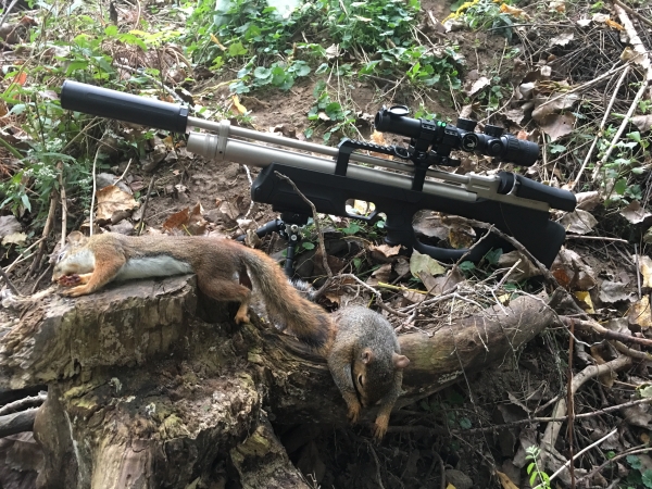

A Troy Hammer Kral PB Story Part 1: Check out my Rig!
My .25 is tuned for power at 55 ft lbs and still has a decent shot count of 48-50 I alternate it with my .25 wildcat for hunting....it hits with authority and is just as accurate,so impressed by this mid level gun

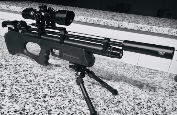

Is that a Sumo on there? I'm sure you love it, not even going to ask... my Tanto was all I needed direct mounted to barrel but I like the shroud when it's turned backwards, it's the max length in that config and I want to experiment with the air stripper but think I may need to polish and crown that thing pretty good just to cross it off the list of things that may be effecting accuracy. Not that I'm disapointed with my groups off the back of my Civic with some wind looking through a so-so scope, this is my first PCP and I've shot and modified and tinkered with fire arms and break barrels for about 12 years here and there but I friggin love this gun and am so excited at it's potential still. If the gun was shooting as good as it can, like many of my other hobbies, I'd probably be done with it...
So my question is, have you done any testing with shroud vs. no shroud vs. Donny vs Donny&Shroud for accuracy comparisons??
Also, 50 shots at 50+ FPE is really nice out of a non-regulated 280cc... I mean, damn that's good. Theoretically, do you think I could ever achieve that shooting 25.39 pellets in .22 caliber? why is it that much harder in a smaller caliber??
I have not done any testing at all...I am a hunter and some times I punch paper to kill time,I can say that the accuracy of both guns is really good,my .22 has Troys quiet kit and the hammer hitting the valve is really the only noise you hear till the pellets hit down range.and the .25 with the sumo basically the same thing with a much louder thud down range.troy did the trigger on my .22 and it’s fantastic not as good as the wildcat but reall freakin close.... good luck with yours
p for shot count ,I get 80 ish shots at 28 ft lbs...I use that when I just want to shoot paper or red squirrel or chipmunk
wow, that is a great pair right there.

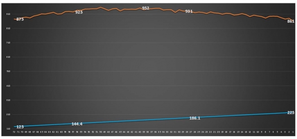

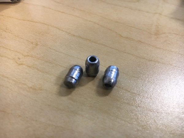

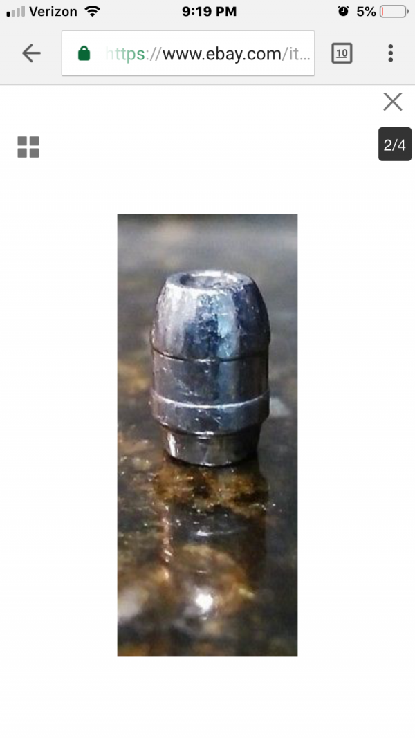

I just got new springs from Troy in the mail (the stiffer of the two is the same spring in your .25) and I'm shooting 50fpe with an "extreme" spread of 9fps! I only screwed it in a few turns and it has plenty left to crank up the power. I've got quite a bit of testing to do and have some 28gr bowtail HP slugs coming in the mail today that I'll be testing out as well. More to follow in a separate thread.
Will be interesting to see how those BTHP’s do in your .25 if the numbers are good I might have to give them a try, where did you get those if I may ask? I have a Mega .25 coming from Troy that he is tuning for me and those might be worth checking out.
So Jim, just wanted to clarify one thing - these are 28gr in .22 cal not .25 just to be clear if you were interested.

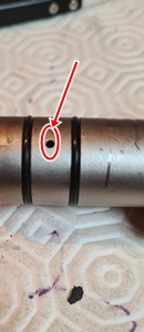

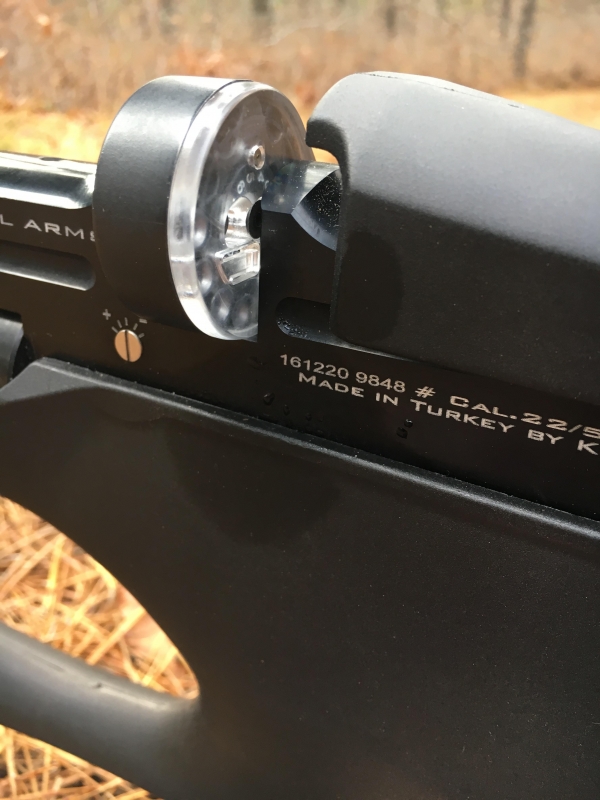

Wasn’t the best description of the above, if you look at the picture you can see the condensation from the “blow by” air. Not sure if it was doing this on full power, as well as choking the flow with the power adjuster.
Also, if someone can suggest a methodology to tuning the hammer spring tension to the ideal setting with power adjuster, I’d be all ears.

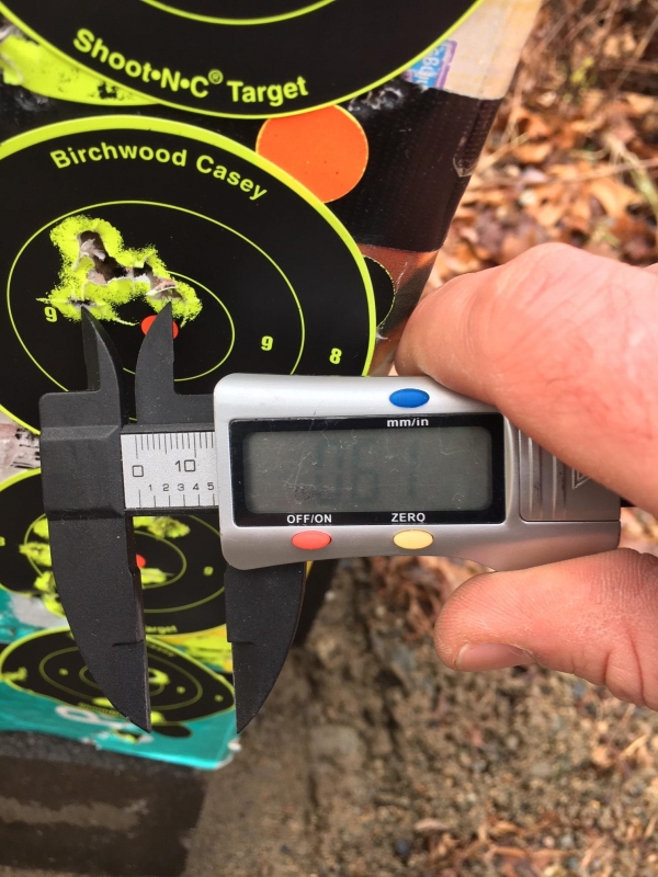

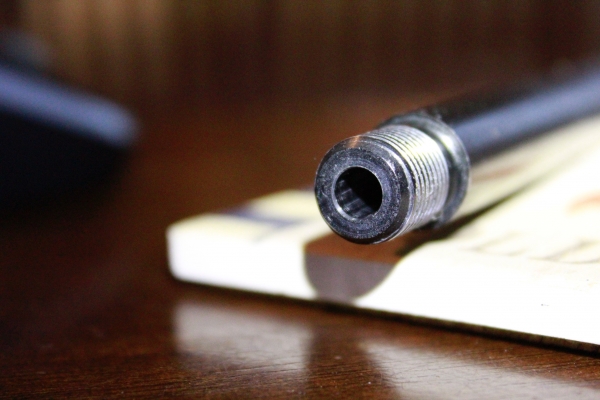

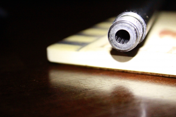

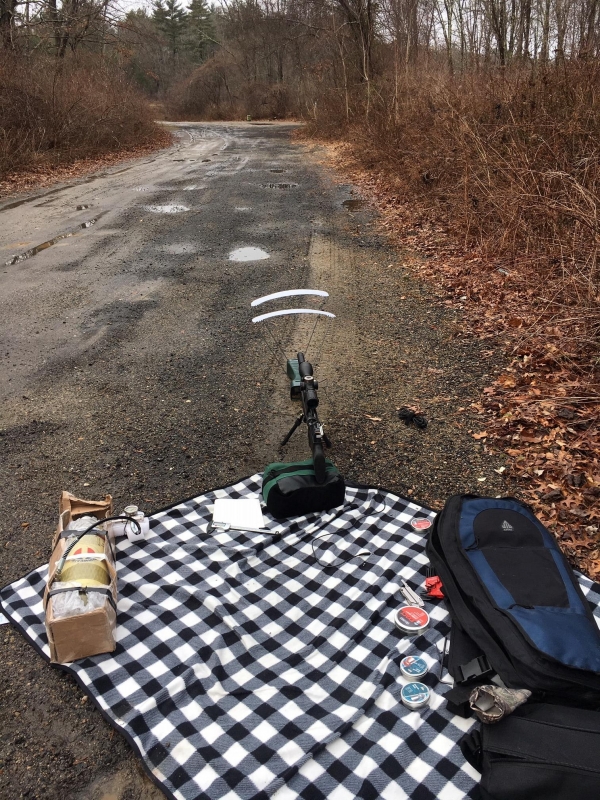

Cleaned the barrel and polished it with some 3M sandpaper that Ernest Rowe suggests. The 25.4's have become very innacurate after 50 yards for some reason and the cleaning didn't seem to help, can't figure it out. So, I detuned the rifle to shoot 18.1's at 950-970fps for about 48 shots and it's very accurate, got a few groups at or close to .61" at 70yds, psyched!

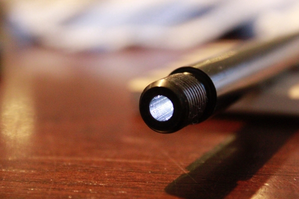

going to polish the barrel again but this is what it looks like now
1545165514_5889869015c195aca9f0ea7.19036558_after clean and mild polish 2.jpg
1545165515_7693069865c195acb023a15.94122406_after clean and mild polish 3.jpg
1545165515_10263015155c195acb4f4300.99632873_after clean and mild polish 4.jpg
1545165515_4284011695c195acbb3bdc9.85039769_after clean and mild polish 5.jpg
