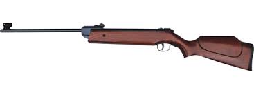

I love your idea! I have thought about cutting the LOP and chopping the barrel on a HW30s to make something like you describe. Pictured here is Sean. I believe he was 5 or 6 when this was taken. He is 8 now. He has no problem cocking the standard size 30 but the LOP is still too long. On a bench it's fine since the rifle is rested but to support it himself holding it to his shoulder is too cumbersome. He can do it but it's not natural. This is a Slavia 618 he is shooting in the picture.

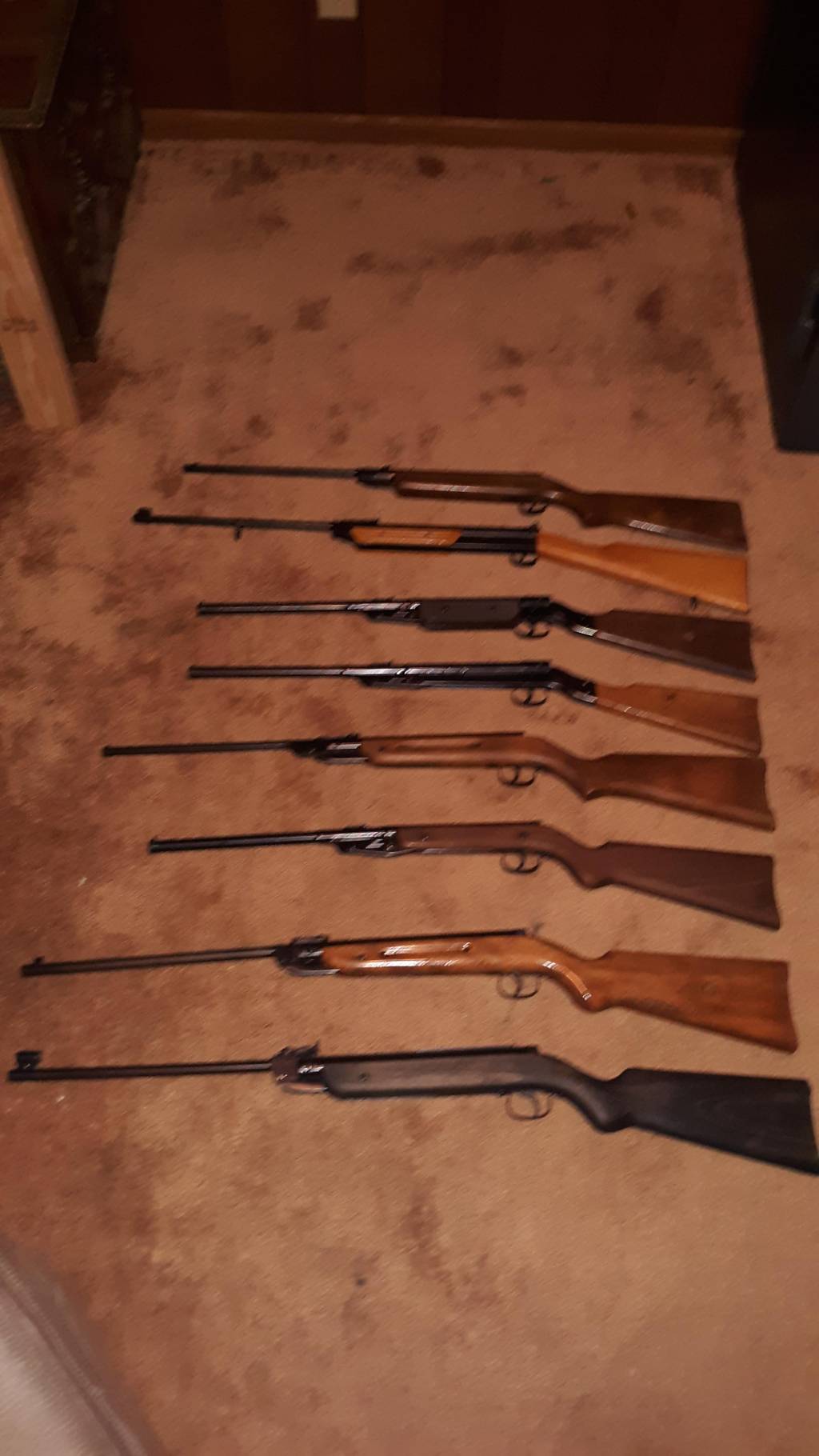

septicdeath,
That's quite some collection of little rifles and some examples of fairly contemporary rifles that have existed in recent times.
