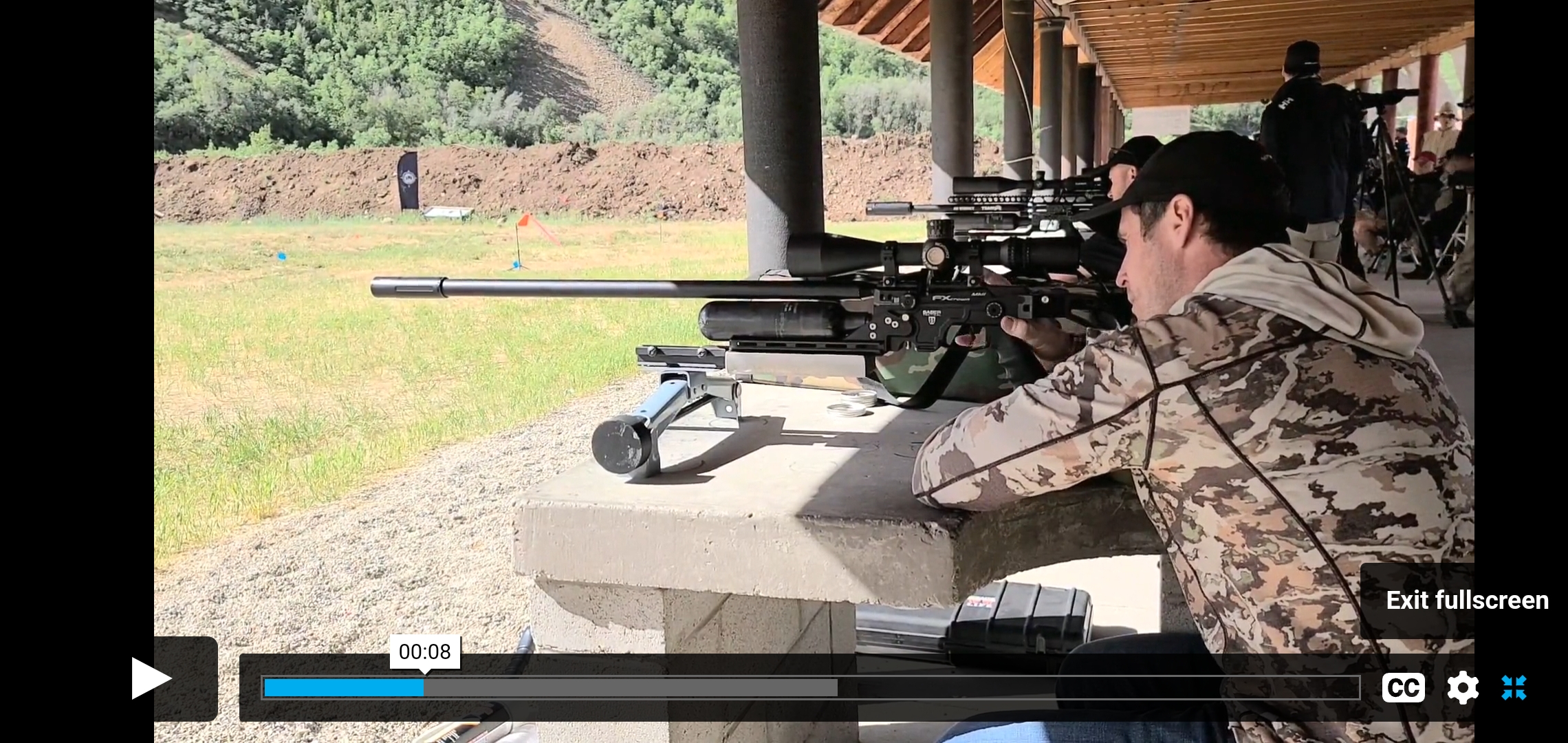

Shooting the winning card at rockymountainairgunchallenge 2022. The entire shot cycle is almost dead flat on his FX Crown. Topped with a Nightforce scope, and held up by a ??? Bipod, which also appears to be weighted down.
no barrel movment on his rig his silencer dont even wiggle wonder whats inside bet its not just a carbon liner but who knows

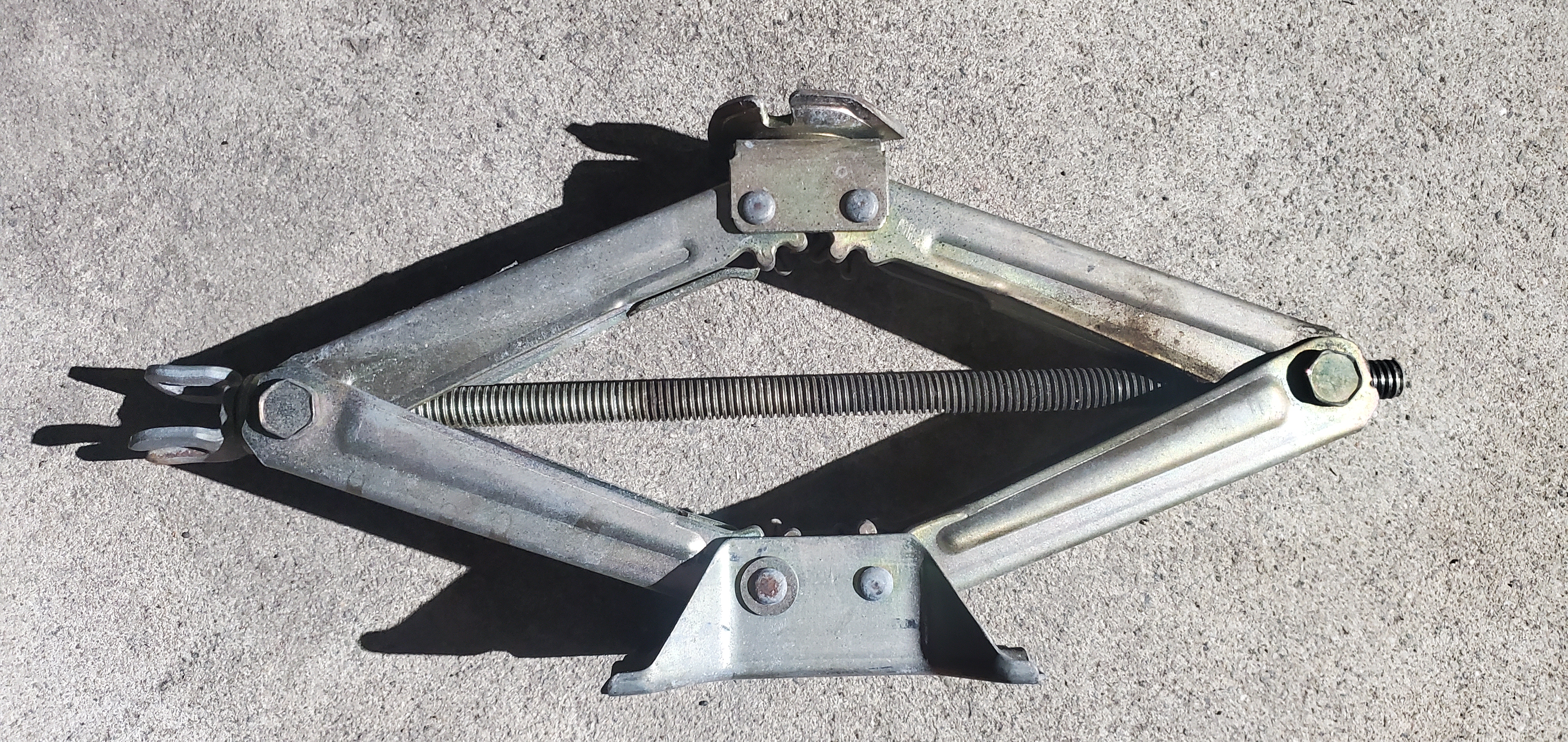

Hmmm I think I will try that weight. It must be heavy. No wonder he has part of a automotive scissor jack to hold the whole assembly up!
I already have one of those bipods in the trunk of my car and didn't even know it! 🙃

Wow, no movement at all, looks like about a ten pound lead weight... (at least), kinda like what Nicolay was using last year. With the newer RD Monsters at 975 in the Red Wolf, they shoot well but require detailed sorting, and still get a flyer every 35 to 40 shots. Unsorted more like once every ten to fifteen shots. Dusty said he sorted in his interview, obviously he was getting an occasional flyer to instigate that sorting. Even ONE flyer would have dropped him down to 4th, so a little luck shined on him that day. Last year I shot a 229-8x in the first round and didn't have a singe flyer. I shot the .25 Delta Wolf in the first round this year and had gun issues, then switched to Bleu (.22 Red Wolf HP) in the second round and had 2 or 3 flyers - a 4 and a 6 definitely, maybe the 7 was me... :oops: And had a decent score relative to the others in my relay.
It is a very smooth and “DEAD” shot cycle!, it should be with the amount of weight on and under that gun, it’s obviously working for shooters. But I have to wonder how much is psychological or just doing what others are? (Remember tuner’s, double bottles etc. etc.).
I did notice it was awkward and a strain to go from record to sighter and back which seems to be from the weight and leverage needed to overcome this and the distance from buttstock to scissors jack.
