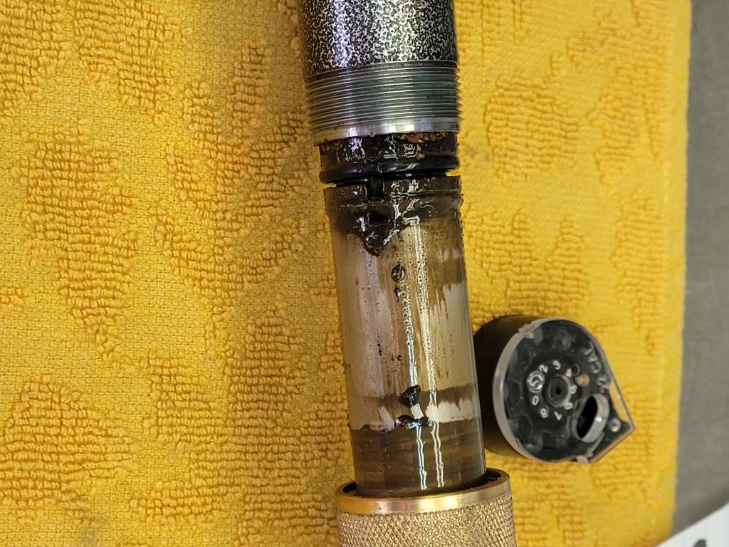

Do not use one without the air drier! The outer tube is steel and will rust from condensation, found out the hard way and thought I would pass this on. Other than that its good quality, easier to pump and fills the gun quicker than the cheapos. Anyone know where I can find and exploded diagram or disassembly instructions since I now have to completely tear mine down to pieces :( I hate flying blind. Youtube couldnt help this time.
any of them can get damaged by moisture pretty quick, and they should be broke down dried and lubed regularly .. figuring out how the first time is the hard part, id look up youtubes on benji and chinese pump disassembly, im sure theyre all pretty similar ... after you do it the first time it doesnt need to be tightened as much and it gets pretty easy .. in some cases tubes etc can be flipped if the sealing end is damaged also .. so yeah, you may need a few tools, vice, strap wrench etc to break it free the first time .. clean it up and have some ~30w silicone oil to lather everything up real good when reassembling ..
I had 8 HILL pumps over the years, always had the air drier models and all of them rusted and pitted pretty fast,.....the past 4 years I used one 50 bucks China pump with no air drier and it's still as spotless as it was on day one.
Anybody can do whatever they want with their money and if they feel that if they drop 300 bucks on a HILL they will get a superior product,...just go right ahead.
Me, after 15 years or handpumping, 8 HILLs later, 2 FX and even a couple Hatsans, I take a 50 bucks China pump without even blinking.

Thanks Dizzums. As always I learn things the hard way. To be sure I have pumped the hell out of it, string after string working out the spring and hammer tunes. I pride myself on maintaining my equipment. Now I've found I need to do it more often. I did pull the outer tube up to stop and lube that with the grease it came with... once. How many pump ups do you usually go between lubes? Tucker5373, I did look at that video, that's similar but not a Mk5 and it's not in English, I appreciate the link though. I think I'll go ahead and buy the Hill piece and look around for an after pump filter/drier just for good measure. Any suggestions? I'm finding strong opinions on pumps around here ha ha
Cool set up WorriedMan! That would be me if I had big bore air hungry guns and bottles for sure! What I use the whole thing for is casual plinking, punching targets, and trigger time. I'm finding half the air gun is the air source. I got into it the Hill half way tonight, carefully... need to get the proper oil for reassembly since everything on my shelves is combustible. It's a very interesting mechanism
