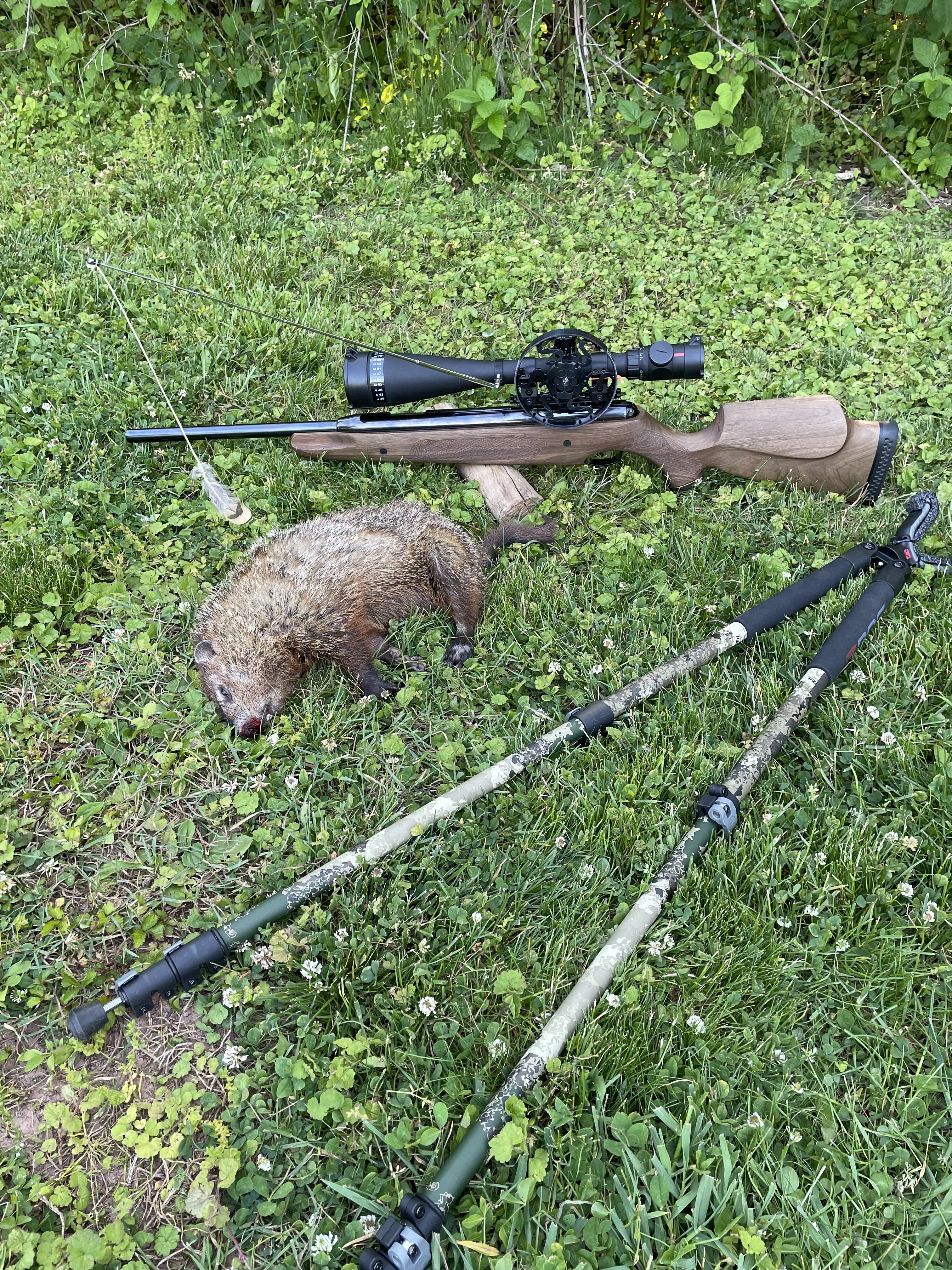

Pretty cool wind indicator, did you make that?
I got a walnut coming.🥰
Thanks, I got it from a buddy who made a hand full for a group of guys. I also was fortunate enough to have someone like @Sqwirl57, help me out through my springer process and put his special tune on my PS.
