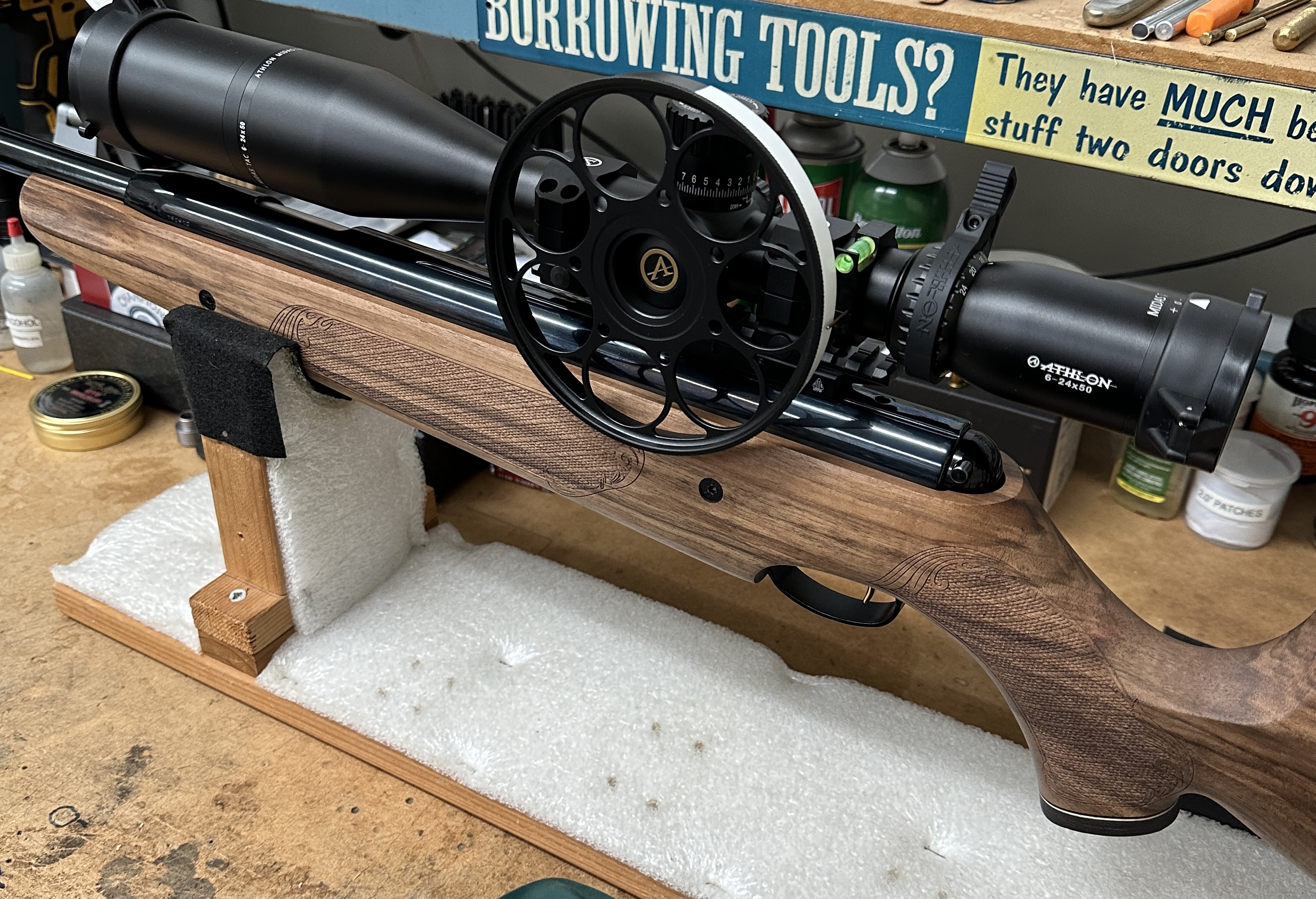

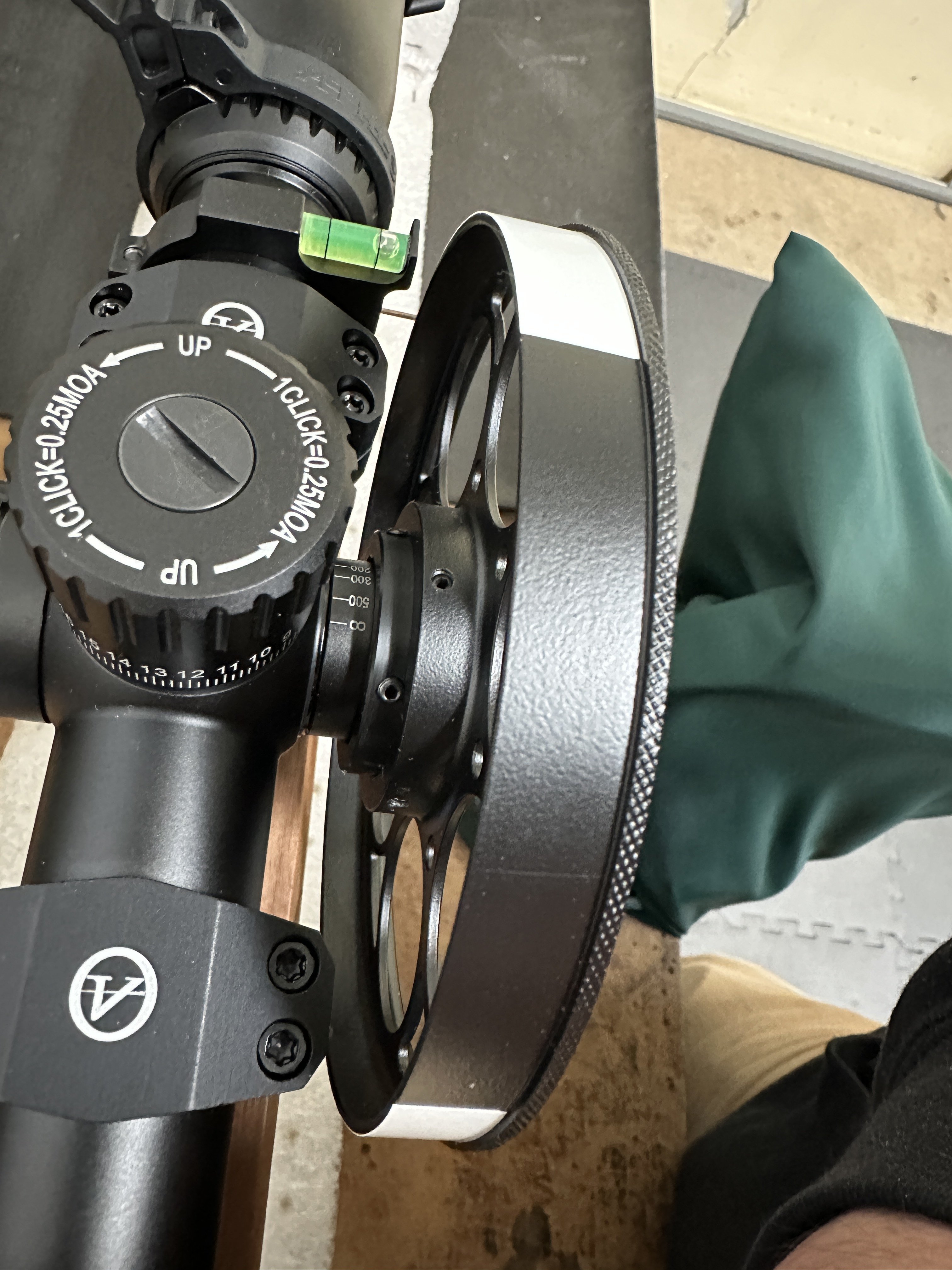

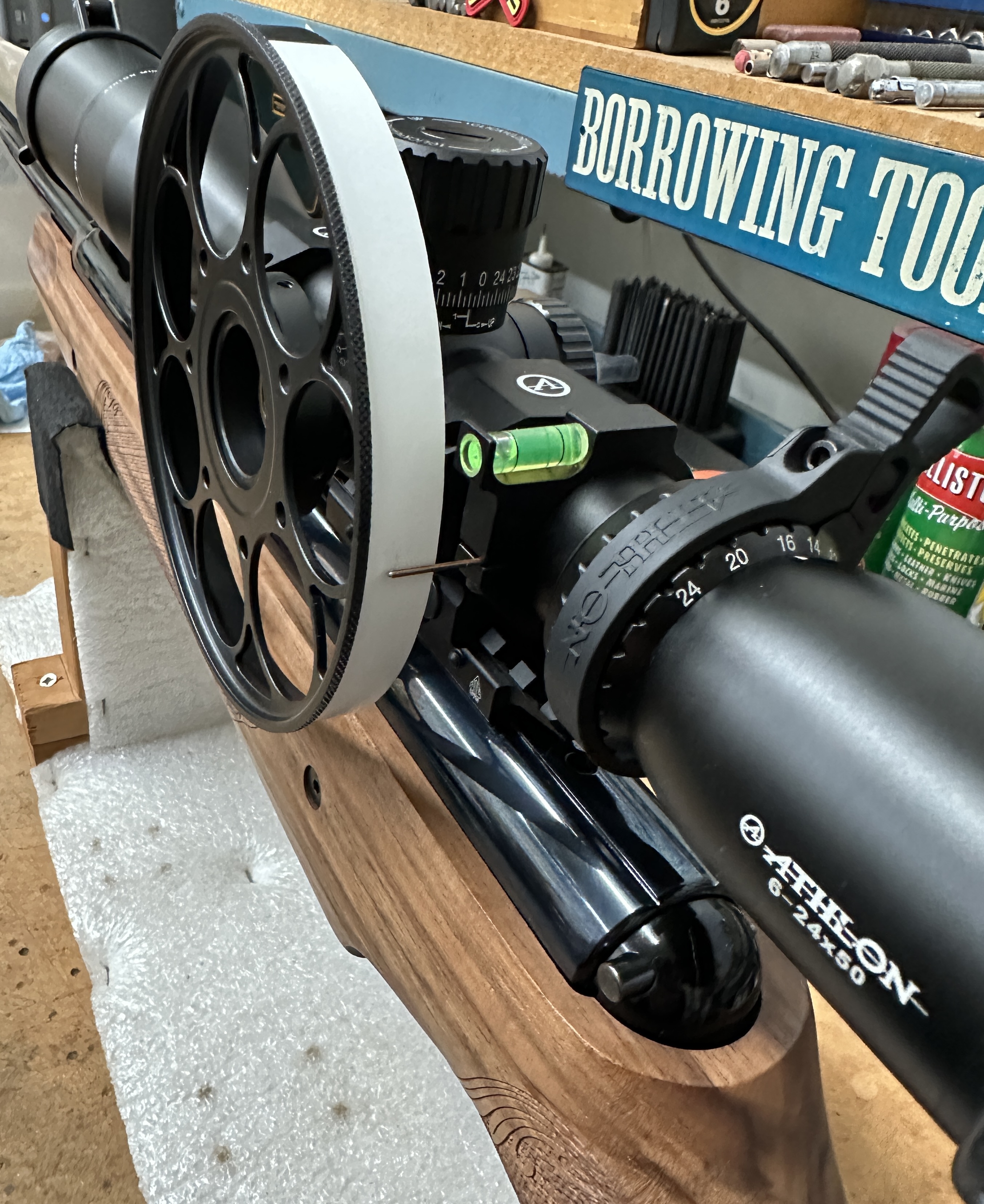

This is my current set up, I have a custom made 5” side wheel that was made for the Tract Toric I had, sold that scope but kept the side wheel..lol.
I decided to mount it on my Athlon Midas Tac, so I had to machine a reducer out of black delrin and drill and tap it. I can leave this reducer mounted to the scope and remove the side wheel if necessary. I put four drill point divets in the reducer for the side wheel set screws to locate in and repeat if removed and replaced.
I’m finding that this Midas Tac’s numbers on the parallax wheel are pretty much spot on, and that’s not usually the case with a lot of scopes.
I added a scope level and home made pointer. Now I have to do all the range marks on the side wheel when I have time.
I’m looking forward to trying this rig out on my field targets when I get it all dialed in. So far it’s shooting very well with what testing I’ve done and I’m getting used to the cocking and loading sequence.

I’m not familiar with those scopes, Sweet job on wheel.
Now just looking at your scope over the breach. My only downfall of the PS is loading, just a little restricted.
Does your scope not interfere with loading?

Actually this scope is higher than I usually mount them and no problem for me loading. The prosport is harder than the 97K because you can’t see what you’re doing, so it’s all by feel. But I’m getting used to it now. In the past I used to mount my scopes as low as possible on the 97K/77K and could still load, no problem. Now I’m using the pic rail that’s already .590 high before adding the rings, which I use the low rings. And I’m liking the little extra height, I think it’s helping me on my long shots. I can load the 97K in the dark, blind folded…lol, the prosport isn’t quite as fast, but I’m getting it.

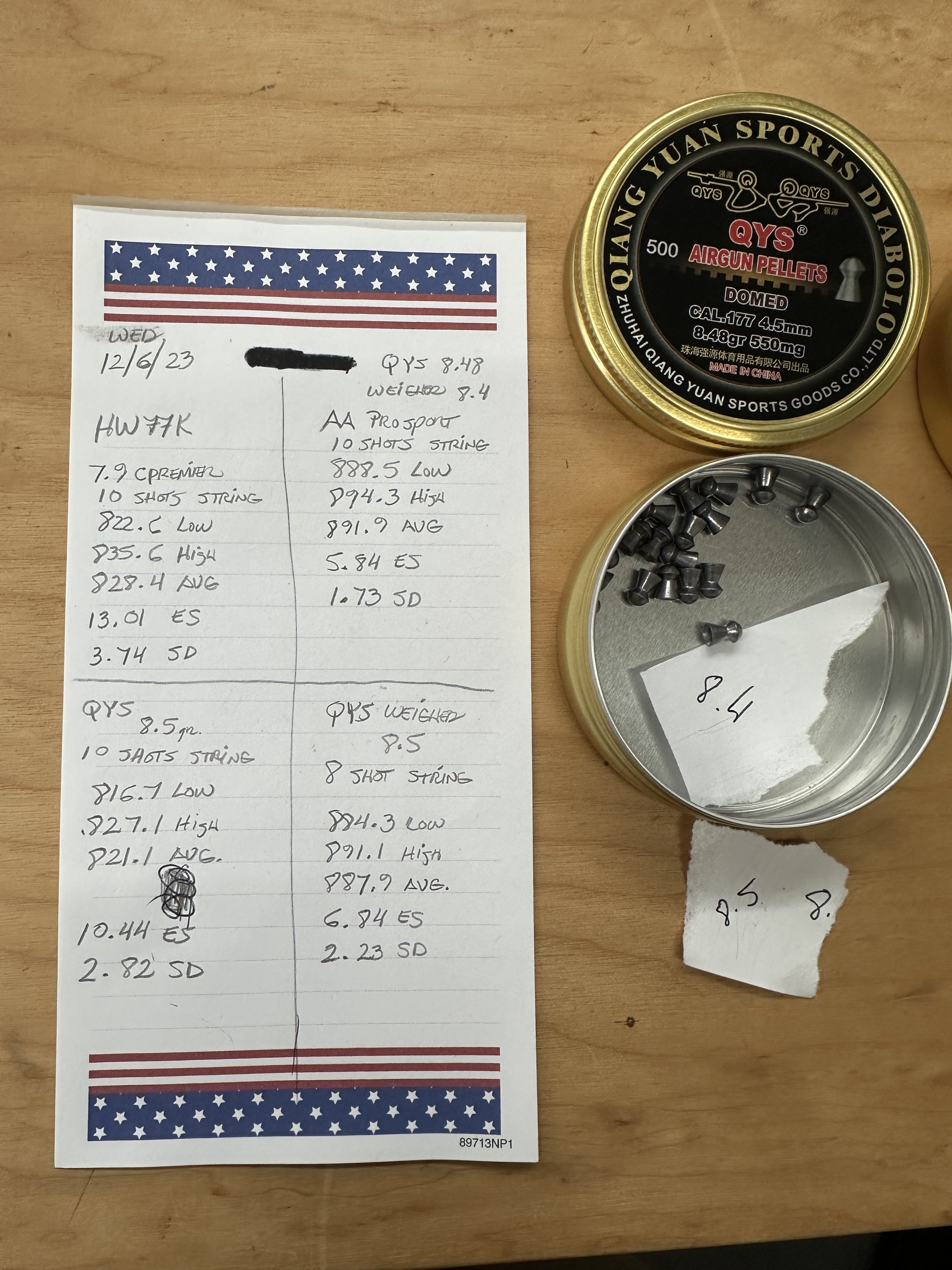

Have you weighed any? The ones I weighed were pretty close although I didn’t check very many.
My prosport was doing about 890fps with them before I took it apart.I’m going to chrony tonight to check it post tune numbers.
I weighed 10 pellets and got 8.95gr average. They give really low St dev over the chrono
Reactions: bustachip
So I guess they are heavier than advertised. I will weigh some of mine when I get the time. The ones I have say 8.48 on the tins.
I bought a number of tins of the QYS 8.48’s. It was about a 50/50 split. Some tins were weighing out at 9 grains and others were in the 8.48. Consistent within the tin but clearly some were 9gr.

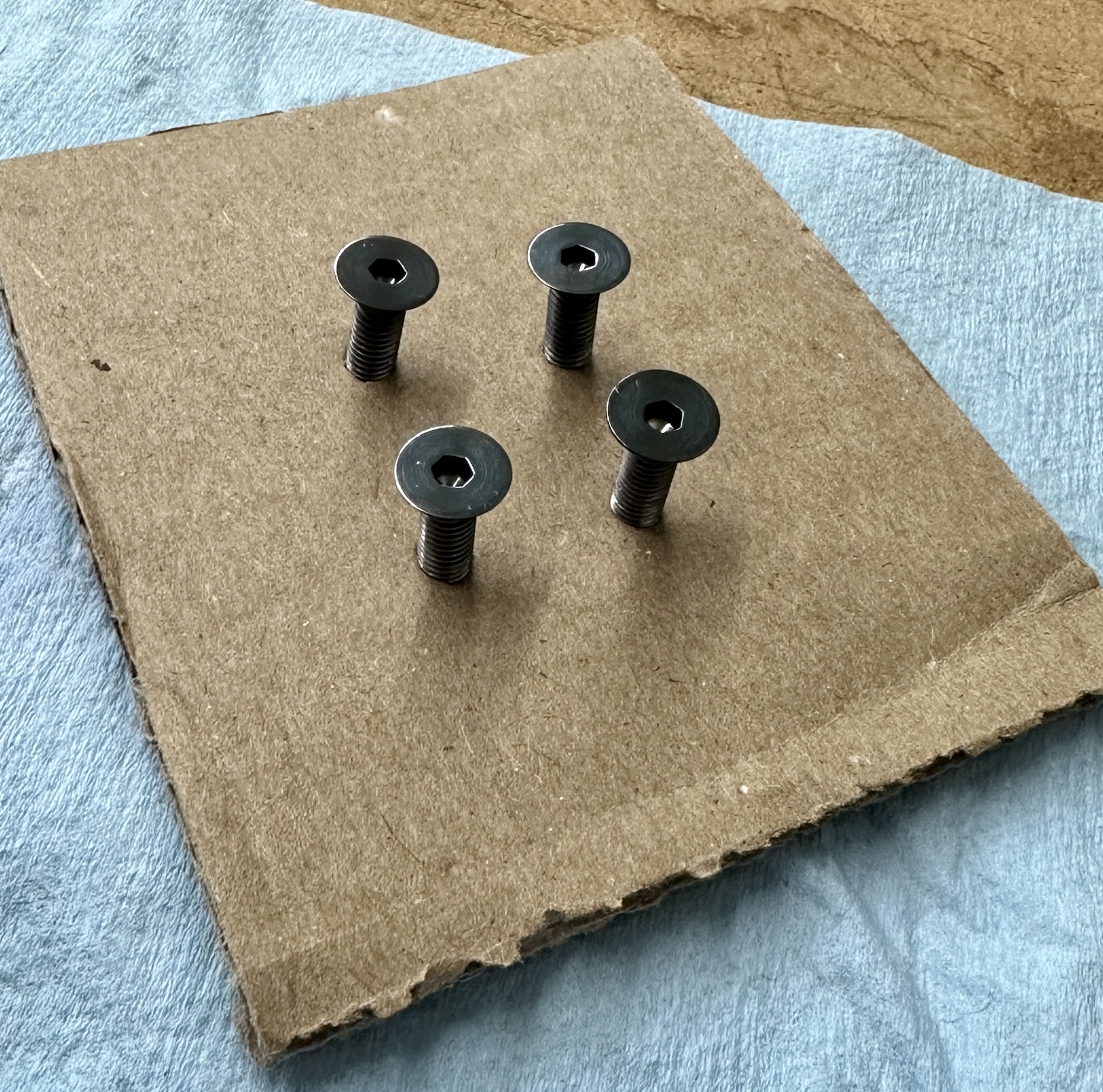

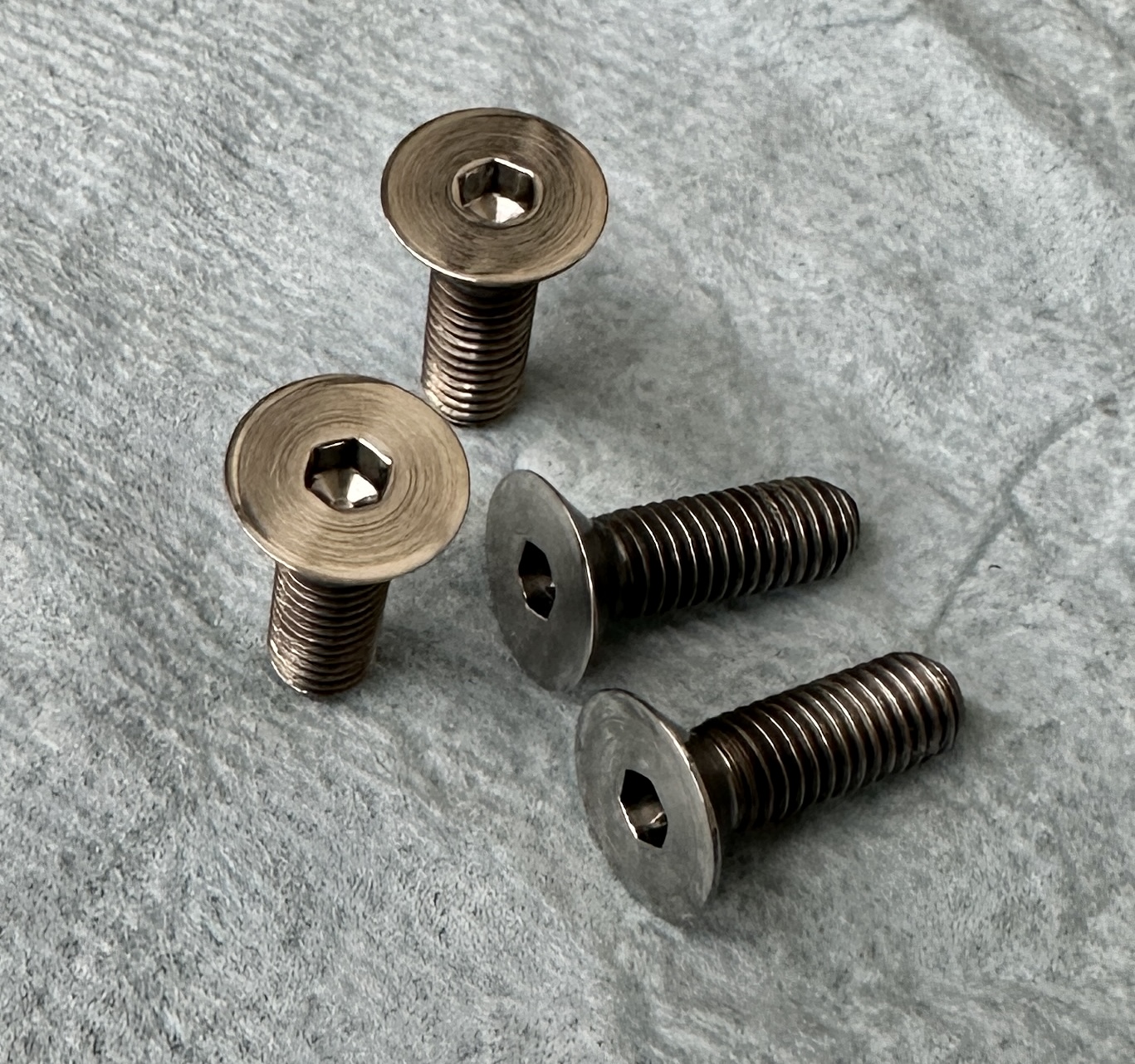

Just a little finishing touch while I have my stock off from oil finishing, and it's in the drying process. The 4 stock screws that hold the action in don't look very good to my eye. So I faced a couple thou off to remove the letters and then polished them...
Next I applied 5 or 6 coats of cold blue, buffing between coats with steel wool, then a coat of oil
to sit until I need them.
I think these will look better to me on the fresh oil finished stock.
I like what you did! I have a TX200 tuned by Jan Kraner (early '08, wish he was still tuning!) and he used a brass cup and blued domed screws. I think I will try what you have done on my other TX's.
