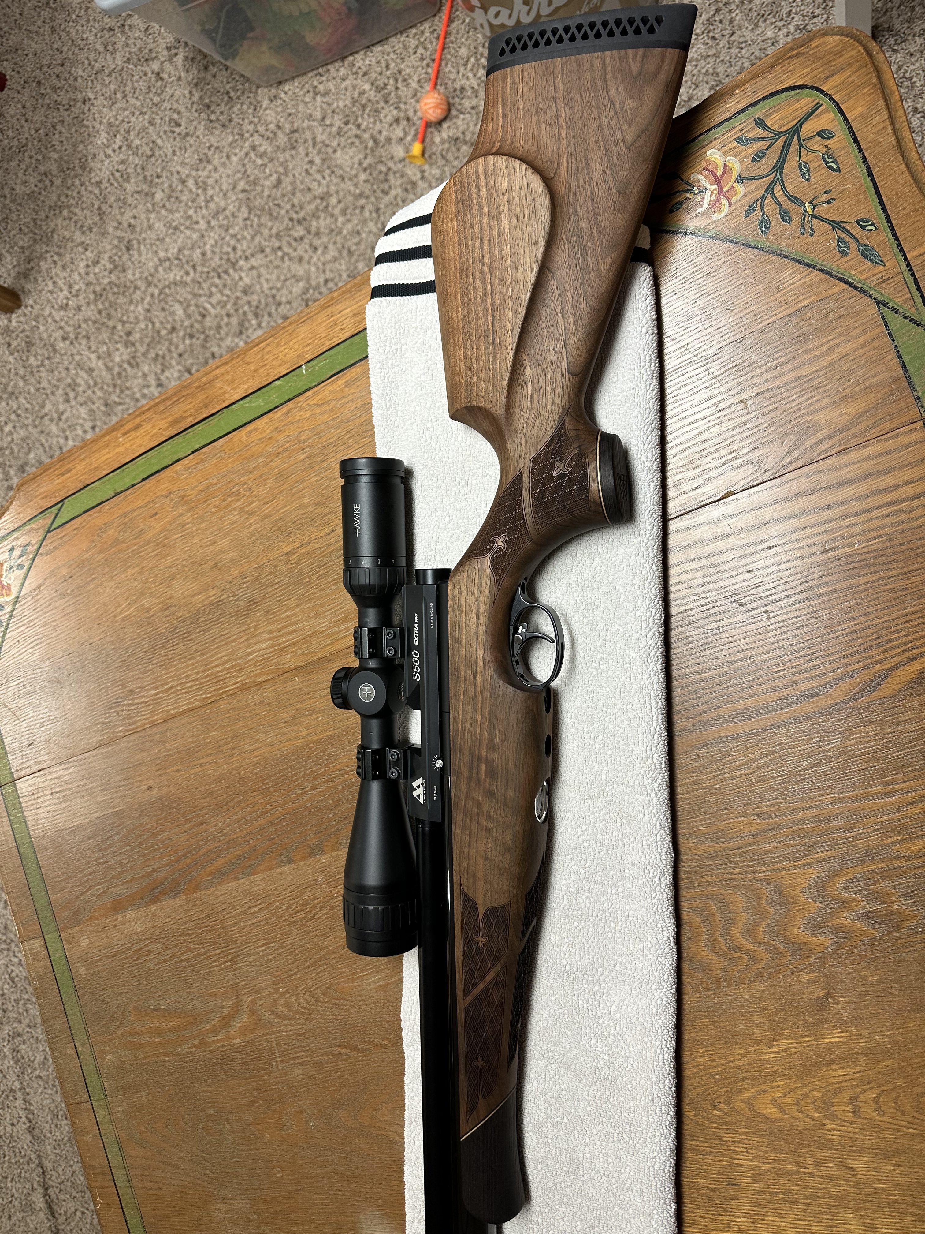

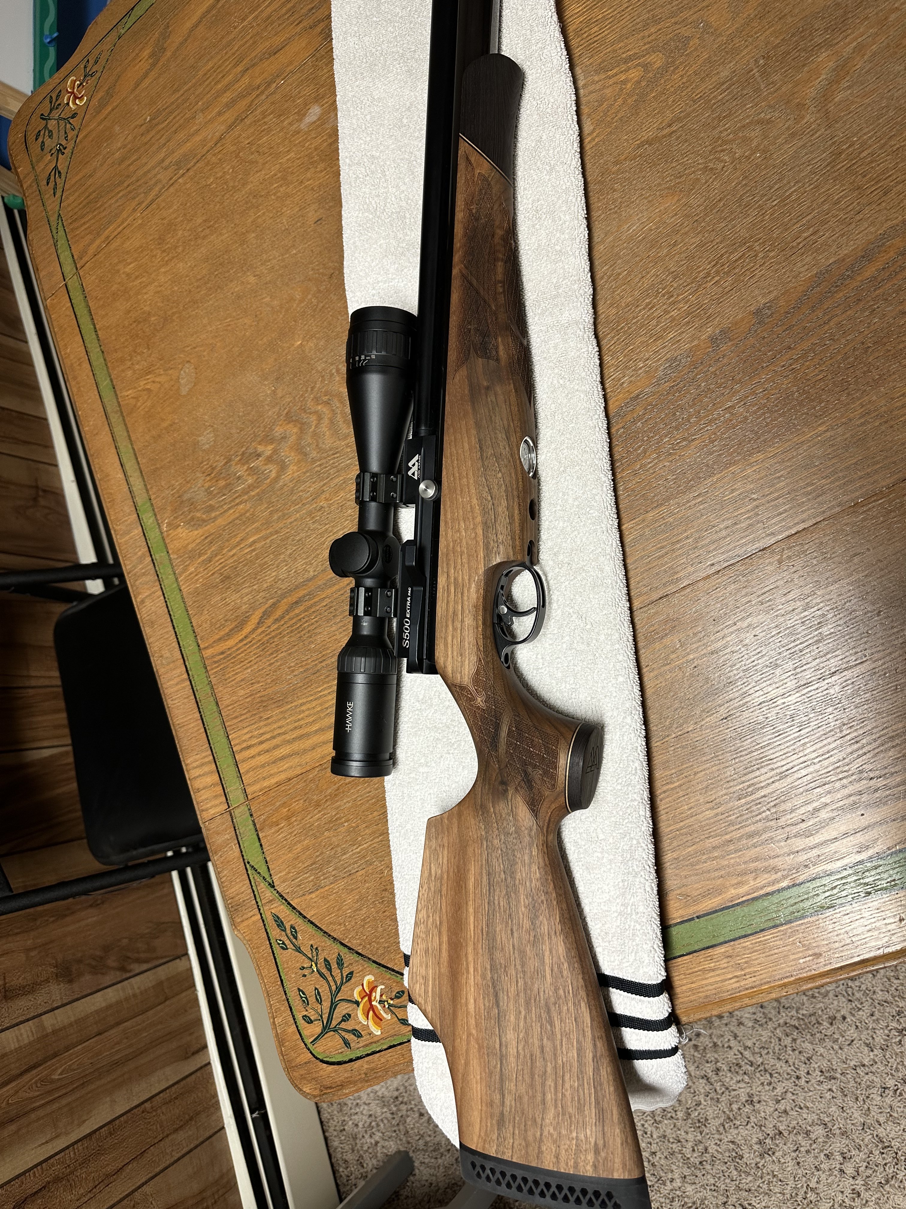

I just couldn’t resist any longer.
Twebster posted this stock in the classifieds back in January.
I held out as long I could, and then caved.
It arrived today, very well packaged.
Photos just cannot relay its beauty.
He has a 510 for sale last I looked. I will not look again, no no.

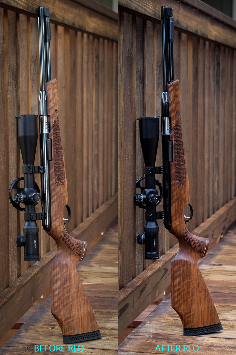

AA has some of the nicest walnut for sure. You got a nice one there! Personally, I really like Royal London Oil. It's easy to apply, and you can get exactly the sheen you want.
I've been refinishing mine, and customers, gun stocks for decades.
Maccari Royal London Oil is the only oil finish I use.
Just like Gear_J says,,,, it's super easy, totally controllable for sheen, if any wanted, and looks beautiful.
Oh, and if you get a scratch, or dent, just sand that spot off, apply some RLO to the spot, and you'll never no it happened!
Beautiful job Gear_Junkie!!

Thanks! And I totally agree with you, it's the only finish I use now too. I've tried lots of others, including various waxes, stains, oils, etc. RLO beats them all!
