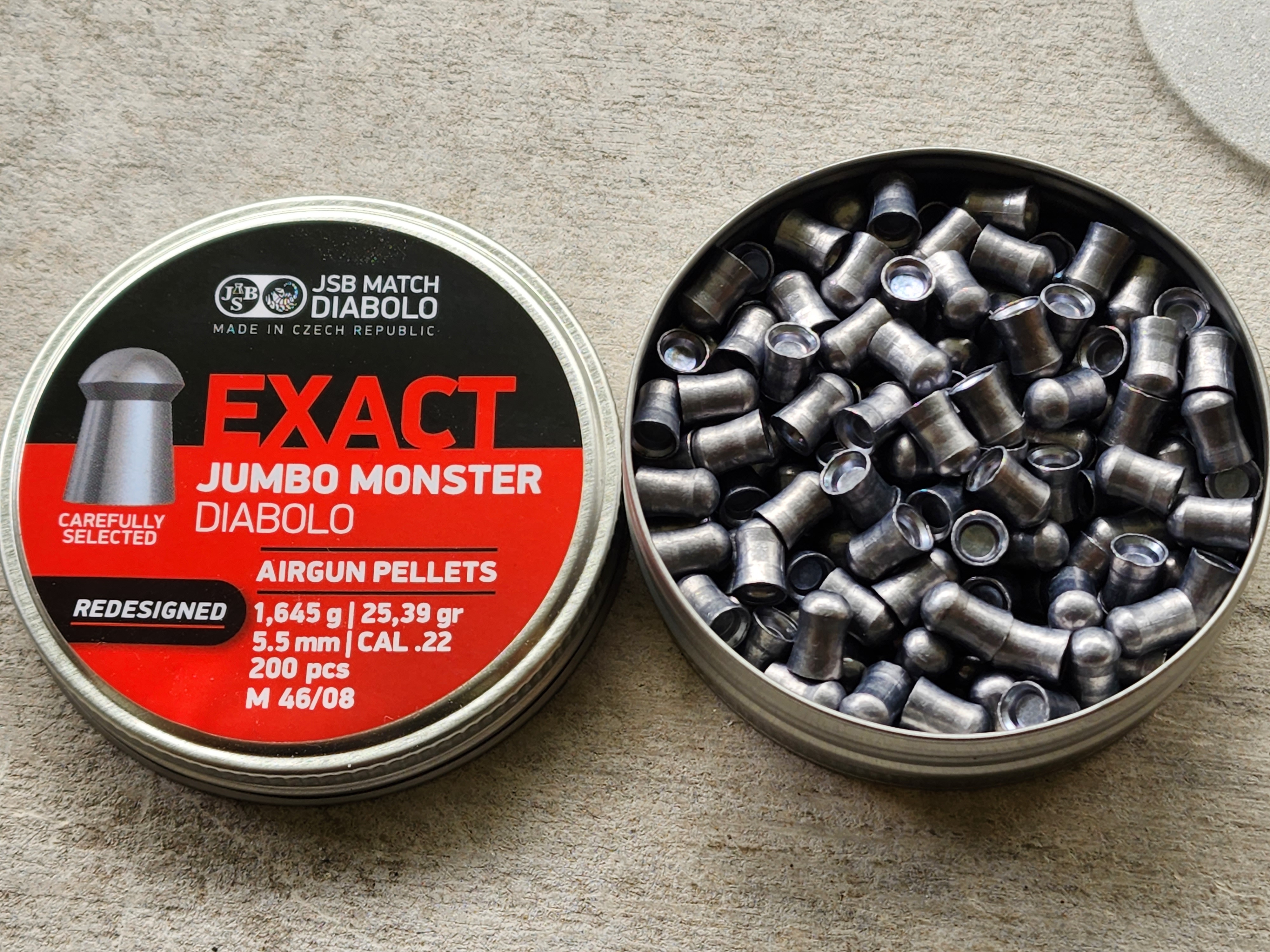

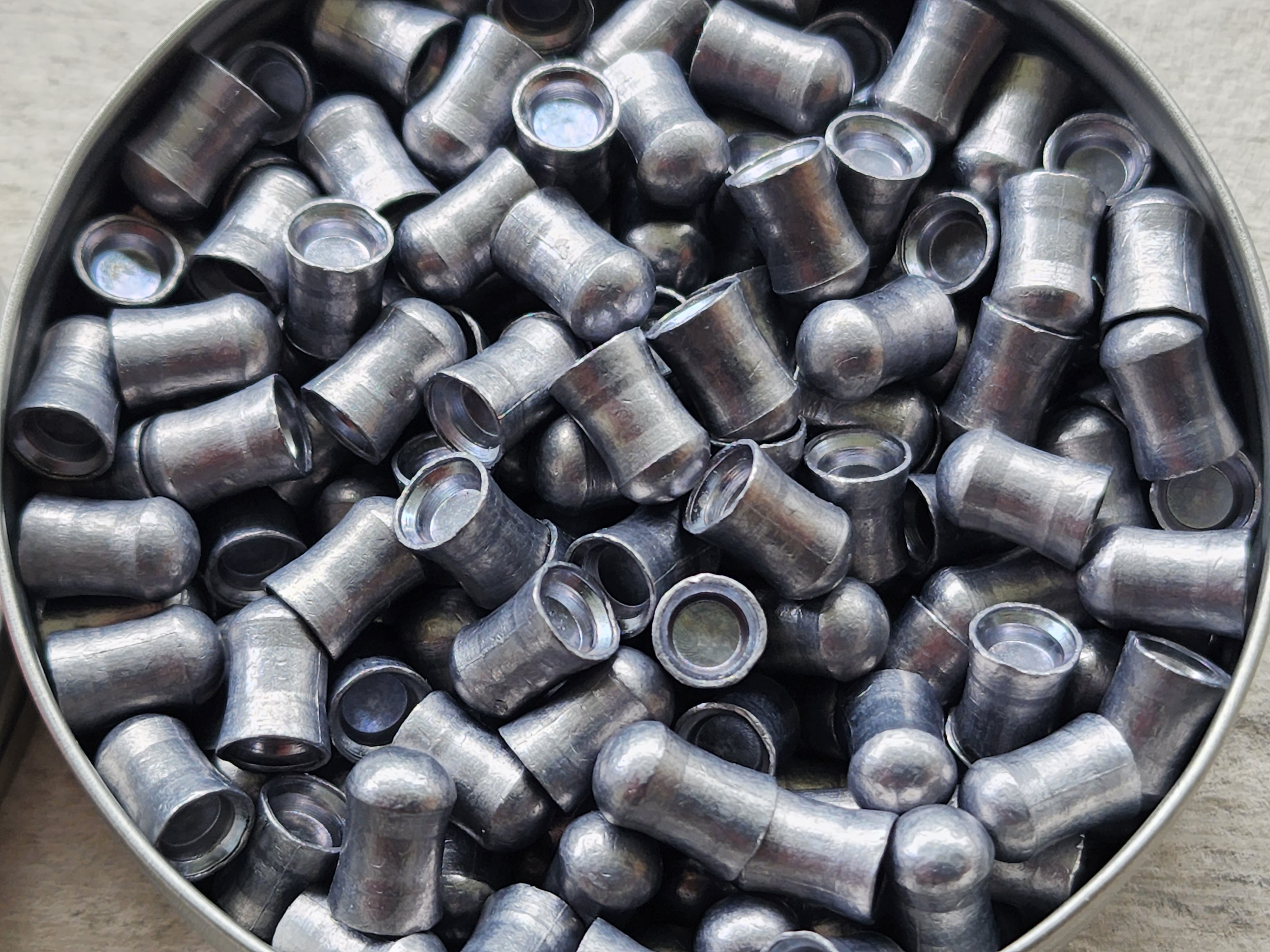

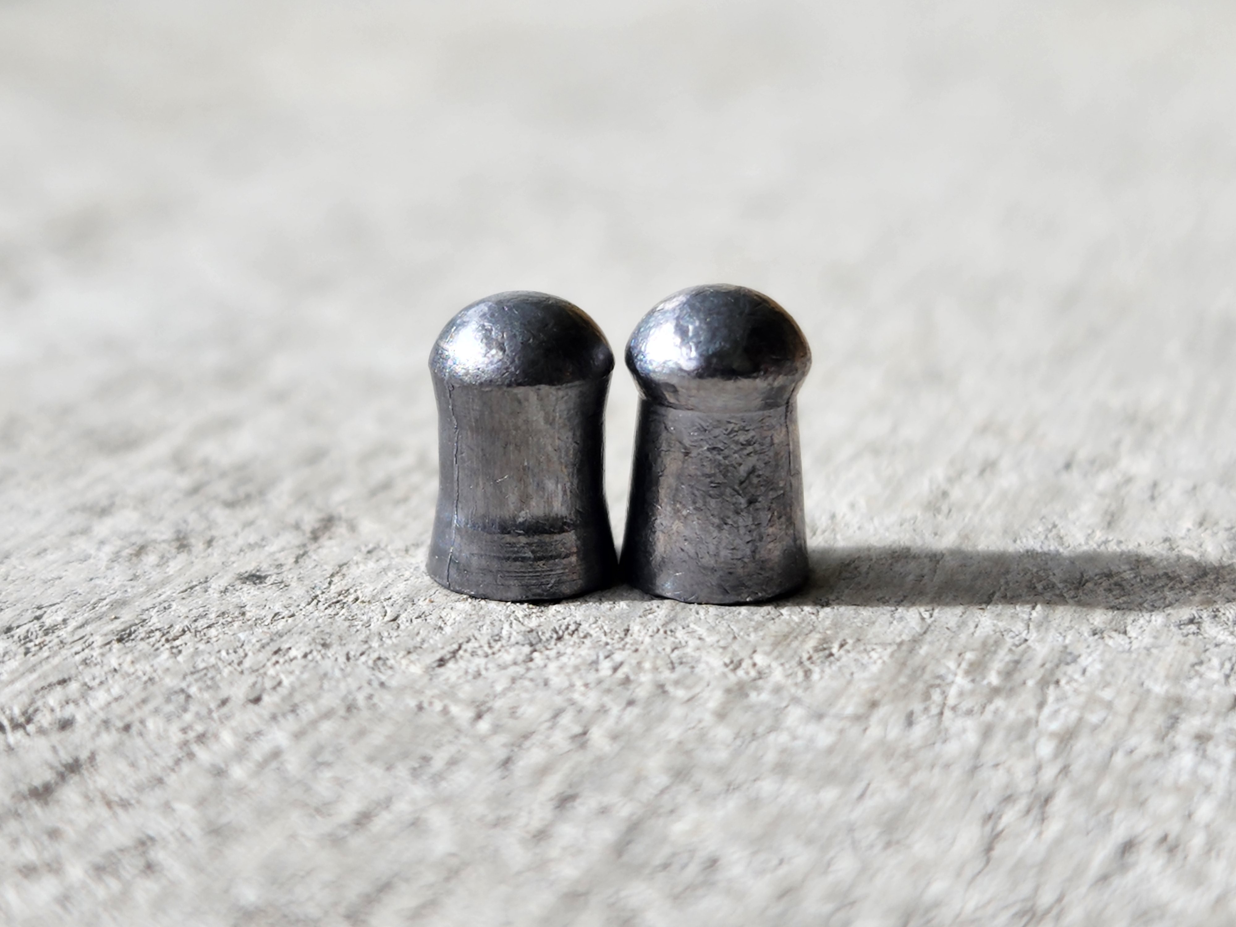

My immediate thoughts went to the pellets. Those who have browsed these forums for a good while have surely seen some posts from disgruntled MRD users. I had too, but chose to tell myself it wouldn't be a problem- sure, might get a bad tin or lot now & then, but will just stock up on the good ones. So I bought MRDs from two other lots (one of them FX branded)... & both shot even worse than the first.
Forum member Richieg started a thread recently that shows in clear detail how the MRD has changed over time:
https://www.airgunnation.com/threads/the-3-different-jsb-25-39-redesigned.1280691/
Won't rehash the whole thread, but for reference, all three lots that I tried look like the bottom most pellet in his first photo.
