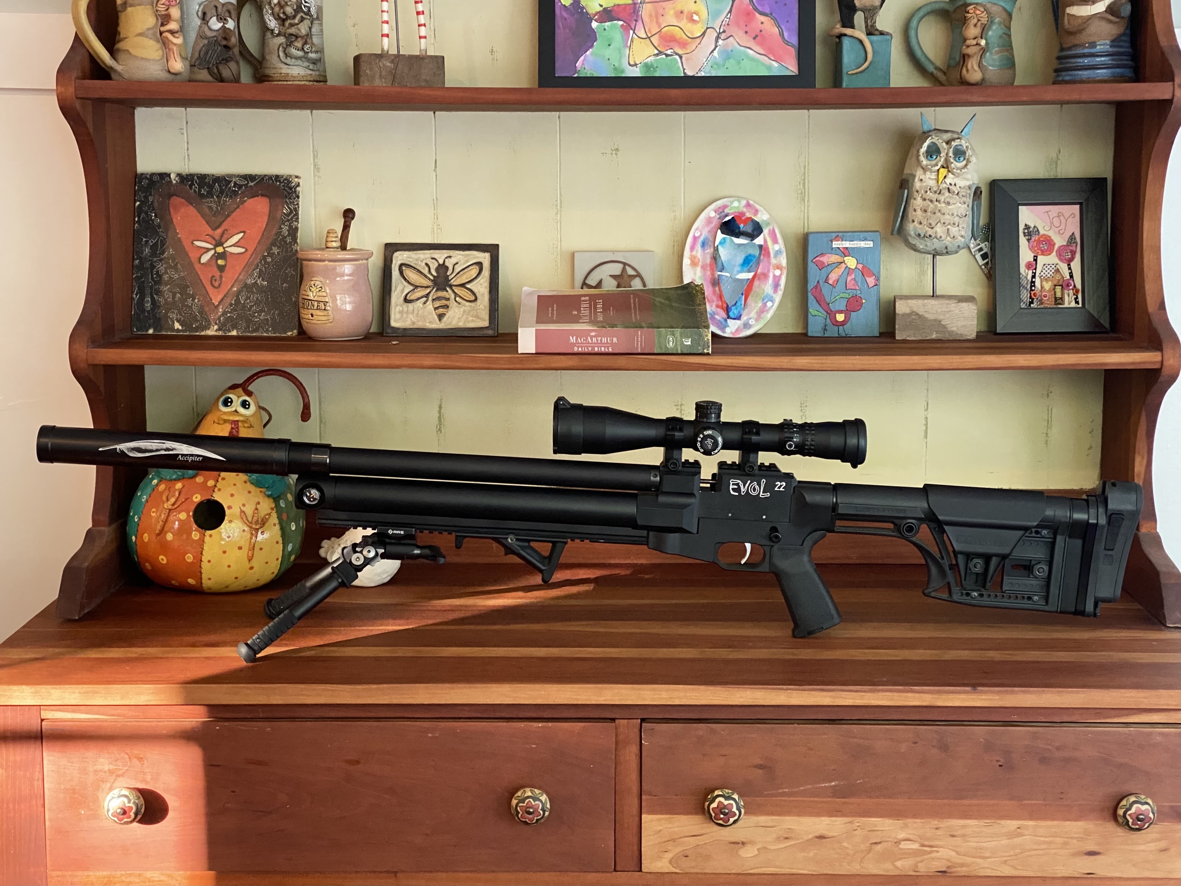

Pretty typical performance for 5 round groups at 40 yards in good conditions shot prone. I was shooting 15.89gr JSBs in my reduced power EVOL 22.

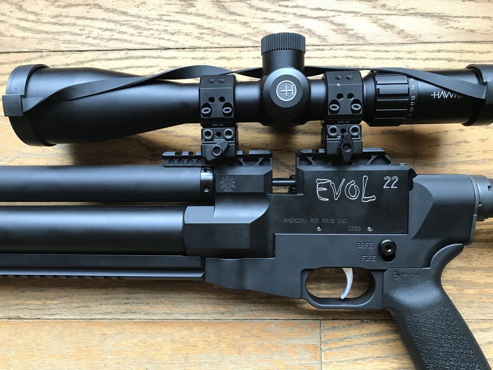

As far as scope mounting goes, if you have the extended rail design like mine, there a couple of nice one piece cantilever mount options available. The Leupold Mark AR mount works well and is repeatable in re-assembly. However, as you can see from the picture, it needs a portion removed to clear the magazine. I cut it off with a hack saw and filed it square. Alternatively, but more expensive, the Nightforce mounts go right on. They are also repeatable in re-assembly. With Tom's built-in 50 moa rail on the Evol, just get a 0-moa mount. Any additional moa and the scope may be too far out of adjustment to even zero at closer ranges.

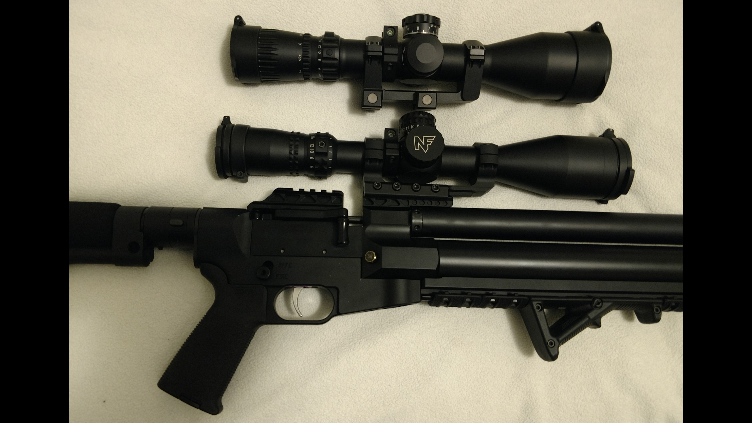

@Calibama22 - you have a few posts above with the scope rings and mounts! @Airgun-hobbyist likes the single mount and I have 2 mounts. As he mentioned above, the biggest problem is getting a single to fit correctly and in my case mounts that are high enough to allow the magazine in. I normally always install "adjustable" mounts on my air guns to allow for longer range adjustments and preserve scope elevation adjustment so I have as many available as I can.
