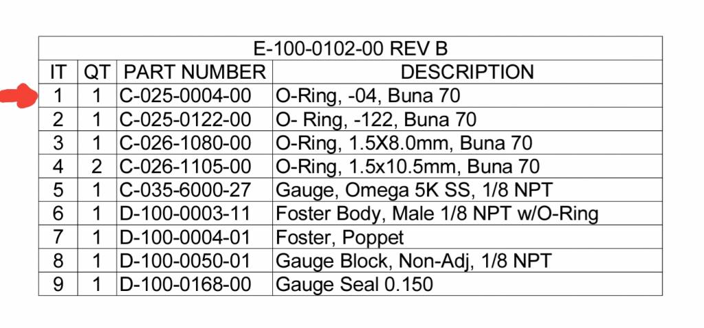

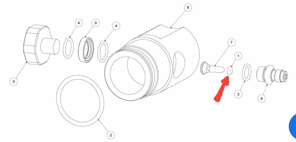

Anyone know the oring size for the check valve?
-04, Buna 70
If you go to American Air Arms main website, there's some updated schematics for the Evol.

HI MTN Ghost uses a EVOL 30 cal , I asked about the .22 caliber MINI . are you saying the reg tube and gage orings all same size and only difference is the probe oring is smaller cause it is ,22 ok , I amgetting a used EVOL I bought from here and I wanted to have plenty of every oring for this gun . I already got orings for the EVOL 30 cal . so do you guys think only different oring between the EVOL 30 and the EVOL mini .22 is .005 buna 90 for probe?
JW... Buna will tear easily compared to cast urethane. The probe oring should be a 90 D, cast urethane 005. The magazine is the culprit in this case. Oring has a tough job jamming through the magazine. I went through several before finally getting the urethane ones. None since.
The other orings might be fine in Buna. I like Viton, myself. It's maybe not as good in extreme cold but better in most other aspects.
