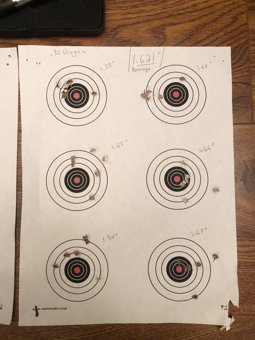

Thank you for chiming in @slayer. I’ve now made a final adjustment. I lowered reg 5 more bar to 132 bar ~ 1,915 psi.
After cooling from the recharge from zero pressure, I got a plateau of 905. I have it set for 890 fps with the 44.75 gr JSBs. I picked up about 3 shots from a 250 bar fill and string has tightened a bit more.
It’s time for a head to head at 100 yards against my .30 Uragán which is set to the exact same speed with the same pellet. Let’s see which gets the nod 💪🏼
Alrighty, got to the range and got her tested. The Evol can shoot. And it won this game but I can’t say the Uragán got a fair shake........
Shot 6 5-shot groups at 100 yards with the .30 Evol and then .30 Uragán. Uragán has a nice FFP Bushnell mounted and the Evol has a Discovery. I’ll tell you though, this Discovery is a nice FFP scope. The best average group size wins.
After shooting the Evol’s groups, I waited for the next ceasefire to change targets. Well, I sent a staple into my trigger hand pinky finger. Well that was dumb! Kinda hurt too 😡 Anyway, it was a little distracting shooting the Uragán with a throbbing pinky 😐
No excuse though. The Evol averaged 1.17” for the 6 groups. The Uragán averaged 1.621”. Both shot the JSB 44.75 grainers at 890 fps. The Evol took it today. @crusher, your Evol is ready bud 💪🏼! Here are the targets and a few pictures:

Thanks for taking the time to do this comparison Derek. That gives me a an idea how to measure my .30 Uragan off of. I'm curious to what's the barrel length of the Evol compared to the Uragan?
Uragán has a 22.4” barrel. Evol has an 18” barrel.
The Uragán isn’t going anywhere. Love this PCP. I’m installing a Huma in it this week and we’re going to put in mad work together and staple puncture free 😆
