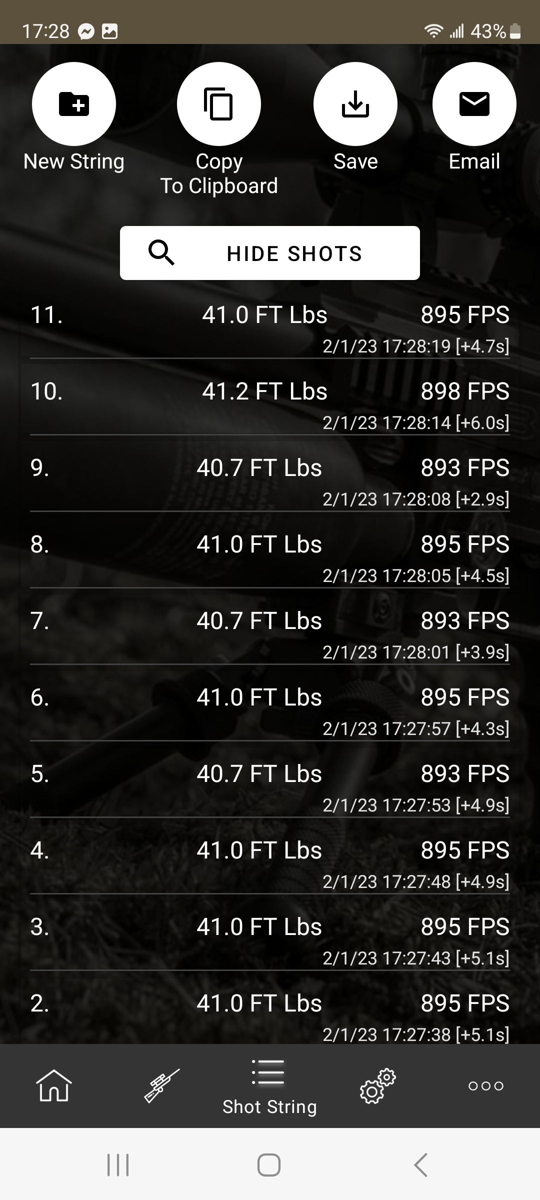

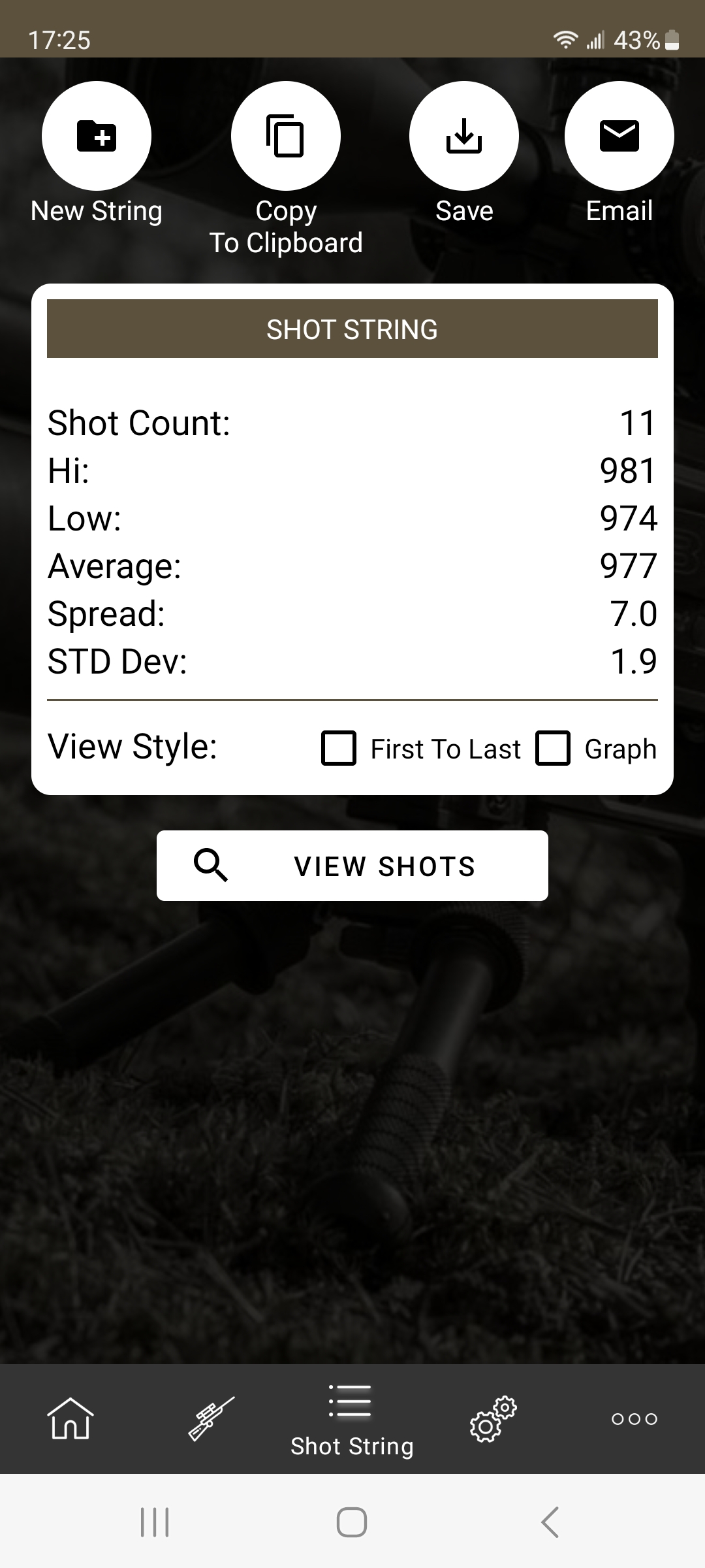

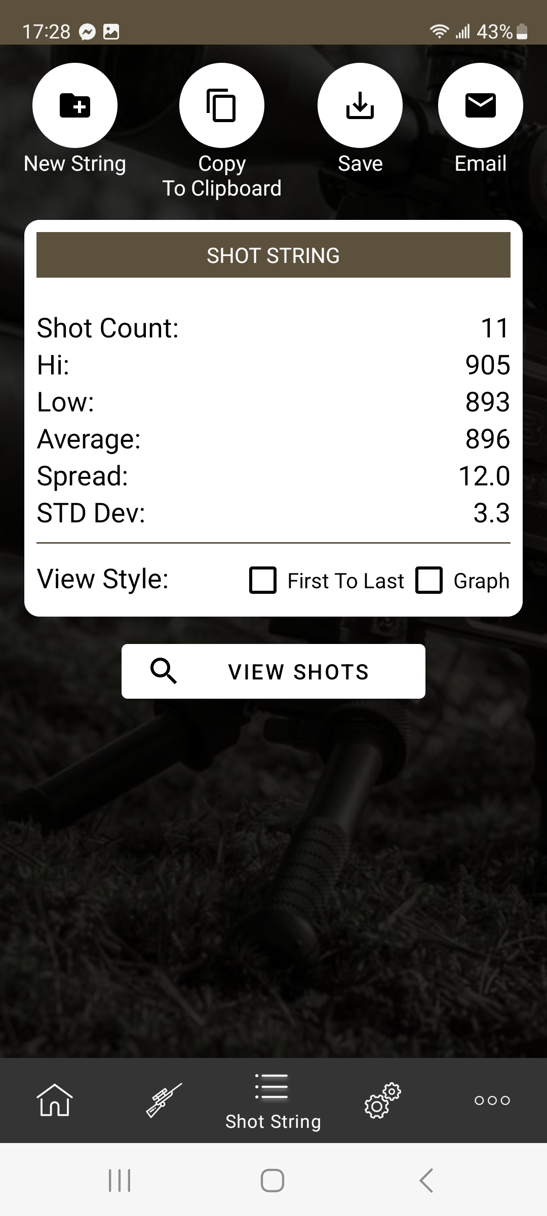

After a few emails back and forth with Tom I was able to get into the rifle and adjust the regulator down to around 1850 psi. This should be a good spot to start testing the 18.1grain pellets. Will start getting some shot numbers over the chrono and see what I get.
Rifle is EXTREMELY well made and very easy to work on. The quality of the rifle is insane, I am really wondering why I didn't buy one of these rifles before.
Some shots with the 18.1 grain pellets as well as some 23 grain javelin Gen 2 slugs. Again impressed with the consistency from the rifle.
Now just need to few feet of snow to go away, and I can get some groupings at 50 and 100 yards.
