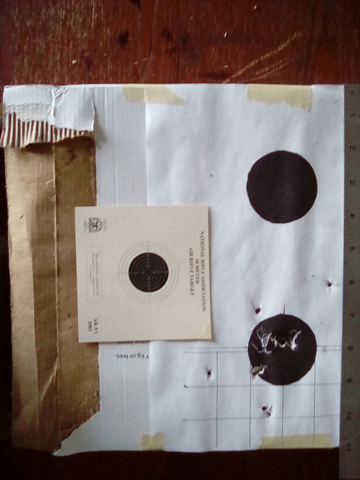

Most of my air pistol shooting is done at 10 to 15 yards. For your distances the targets I use should be just fine. I like 2 inch targets that I make myself. I print up a bunch along with other targets on a Xerox machine. I also like the NRA 10 Meter Air Rifle target.

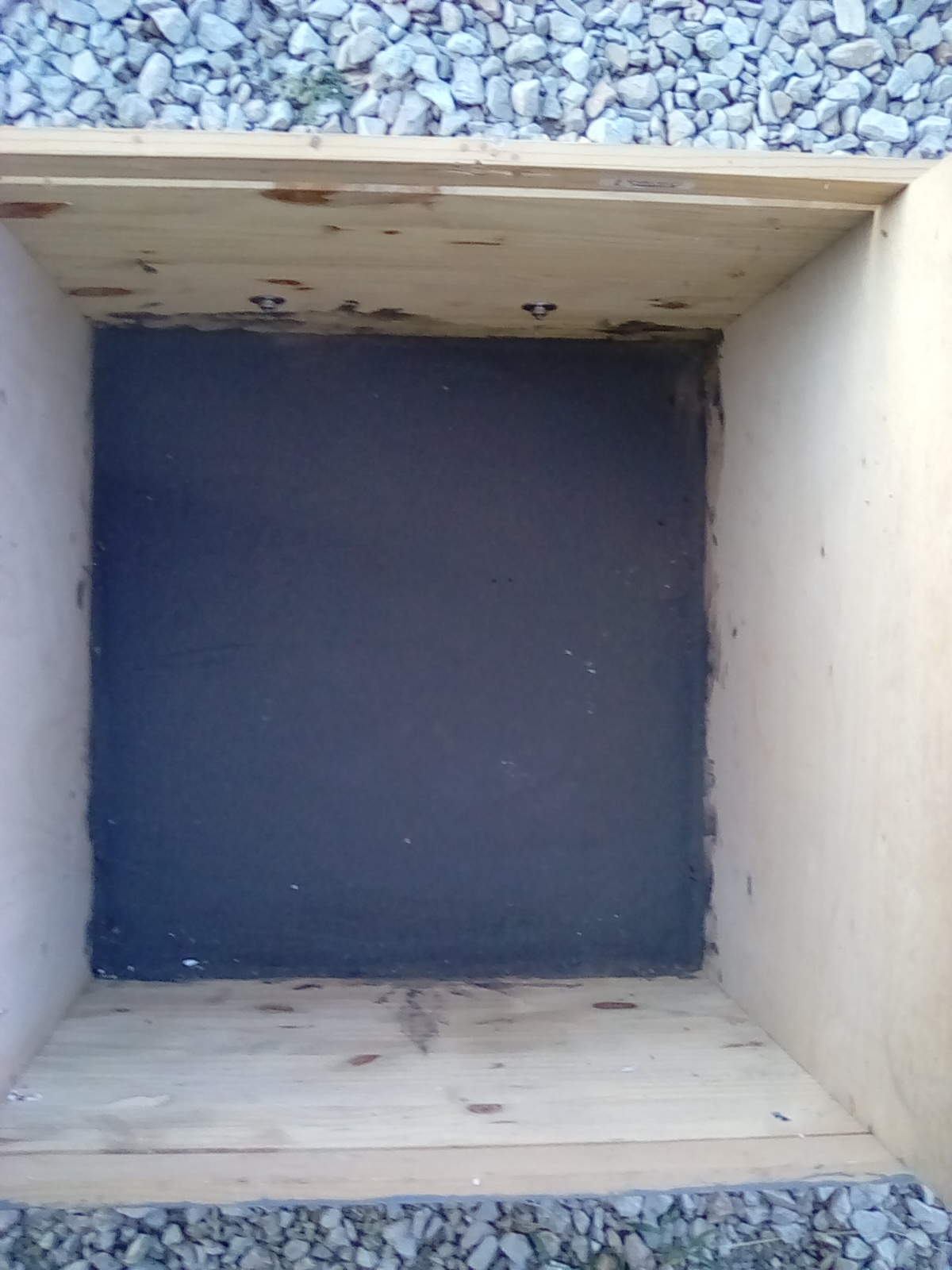

For a pellet trap go ahead and use the duct seal but also stuff the pellet trap with old bed sheets or blankets. The sheets and blankets will stop the pellets and your duct seal won't get tore up. I made my own pellet trap that I use in my back yard.

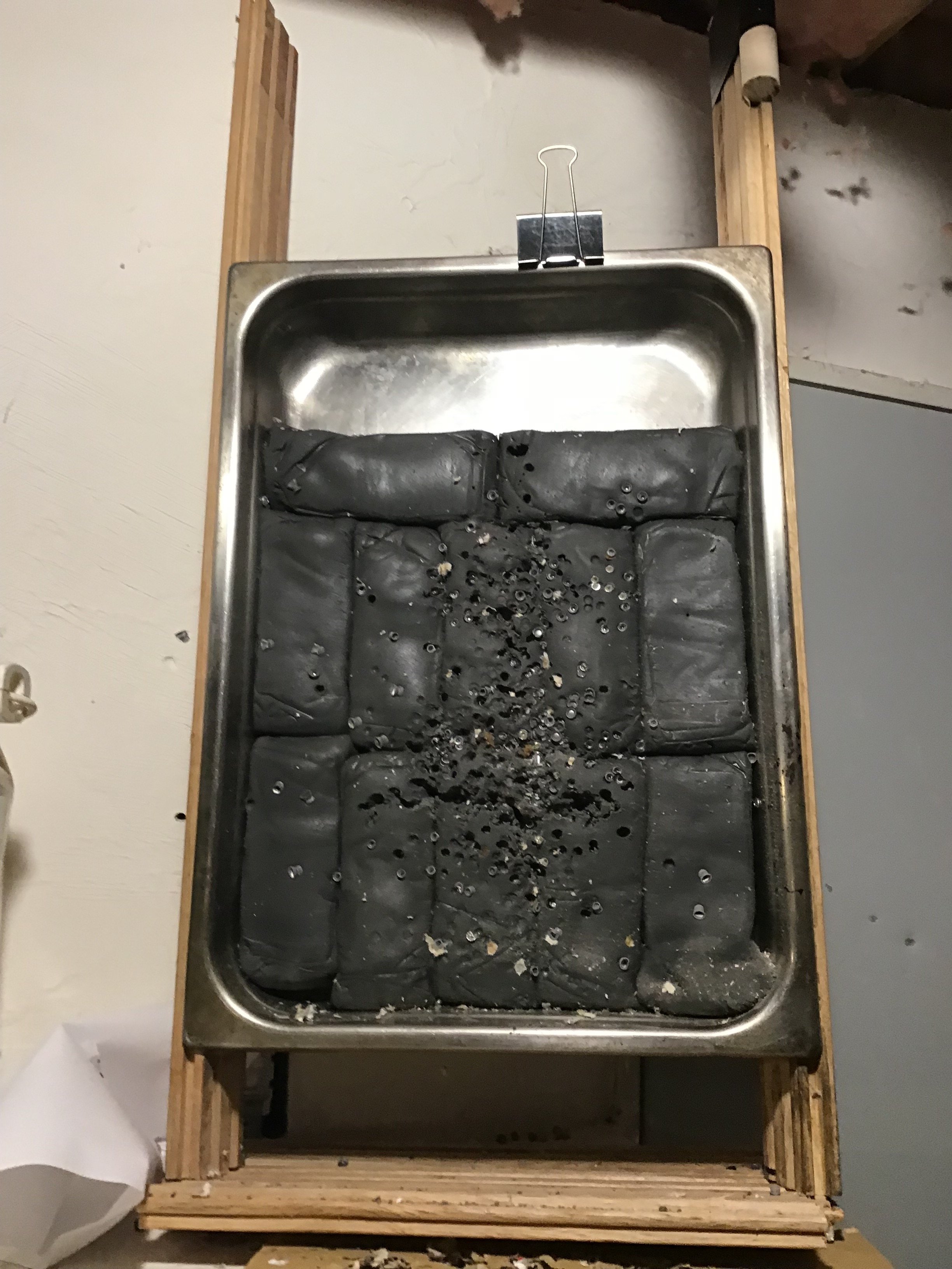

I use a large cooking pan lined with duct seal. Piece of cardboard on the face to stop pellet bounce back. Note the few misses to the left and right. Right side is a metal door. 22 pellets dented quite well:oops:
Regarding targets you can get reduced scale 10m airgun targets scaled for 5 meters. Download the PDF's and print as needed. https://www.gr8fun.net/index.php?main_page=page&id=4

I took the cardboard off to show you the block placement. Empty 12-pack beer suitcases opened up fit it perfectly. I've never had any bounce back. Advise never use BB's but that's stating the obvious..
I used the rubber mulch in a cardboard box. The mulch was only $4 a bag at Wally World and I used 2.
I have shot my 25 cal PCP, a break barrel 177, and my CO2 pistols at it a lot and never had a problem. Pellets only make it about 4" deep. No worry about tunneling as a new piece falls in place. When the box gets torn up I tape a new piece of cardboard over it.

I thought I'd just follow up on what I was talking about yesterday. I finally got around to giving my pellet trap a long over due cleaning out. After removing the bed sheets that were inside the pellet trap you can see that the duct seal is undamaged. One could argue that I don't even need the duct seal.
