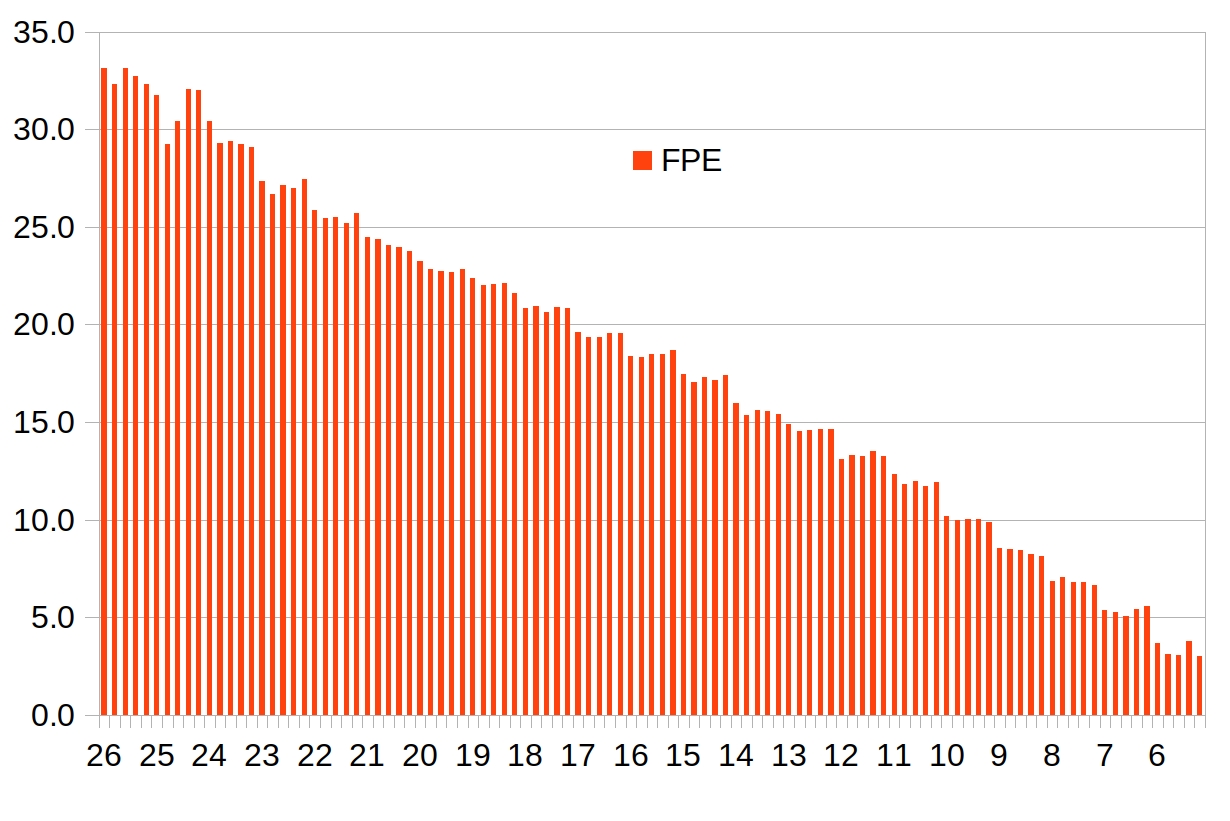

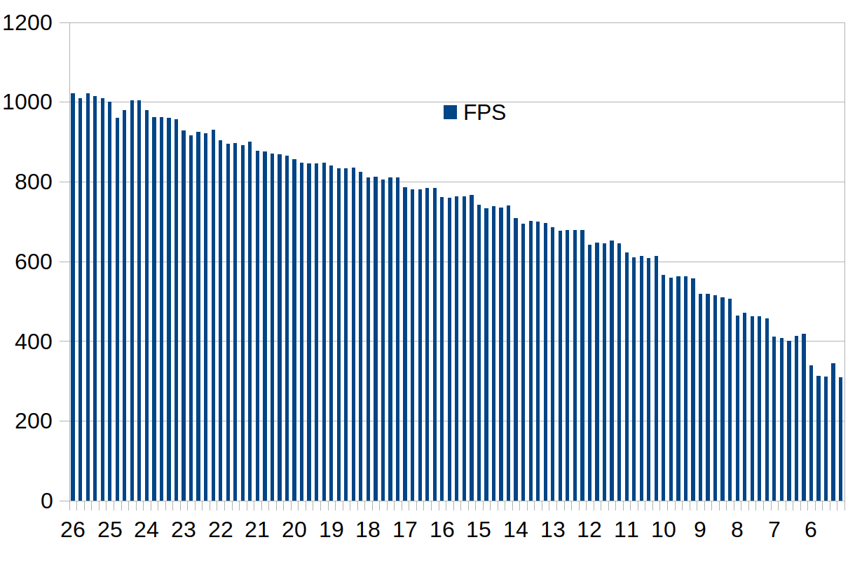

That's an interesting question. I haven't gone over 26 bar. Weihrauch says 26 is max. The Beeman RX tech manual says to not exceed 24 bar. Engineering designs always have a margin of safety built in, often 10%. so it may be safe to go to 28 or 29 bar. But even if it's safe, you will get accelerated wear and potentially early failure. The cocking effort at 26 bar is ludicrous. I ran some rough numbers to estimate the shear load on the little cocking linkage pins, and it looks ok. But you wonder...
I don't see a benefit to going over 20 bar for the stock seal and 24 bar for a Vortek seal. My test showed standard seal peak power happens at 20 bar and 21 fpe. Vortek seal peak power is around 24 bar and 30+ fpe. (There is a possibility that Beeman used a different seal in the RX. Some reviews report higher power than is typical for the HW90s.)
My personal comfort zone is around 20 bar.
Below are my Vortek seal FPE and FPS graphs, using Crosman .22 14.3 grain pellets. It goes from 26 bar down to 5 bar. It's stepped because I shot five pellets at each bar level. Note that my gun has a HW95 carbine barrel, and I took the inertia weight out. I don't think that affects power output.
I just noticed that Vortek rates their new HW80 PG4 kit at 23 FPE (if you use the Vacuseal). That makes sense considering the HW80 has a bore and stroke similar to the HW90.
I hope that helps.
