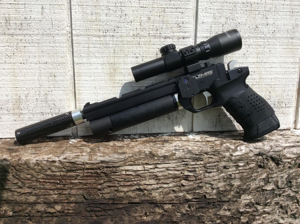

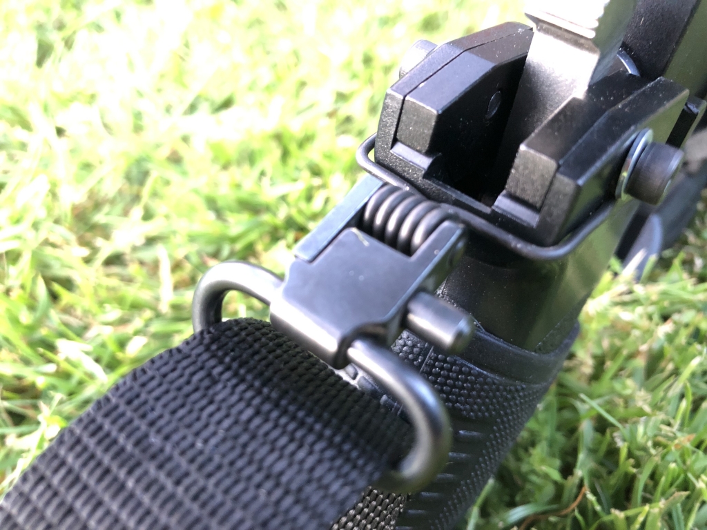

I’m really enjoying this pistol! I still have a plan to turn it into a rifle with the folding stock or something else that I have in mind (rear adjustable sling used to carry the pistol and act as a rear support, like a stock).

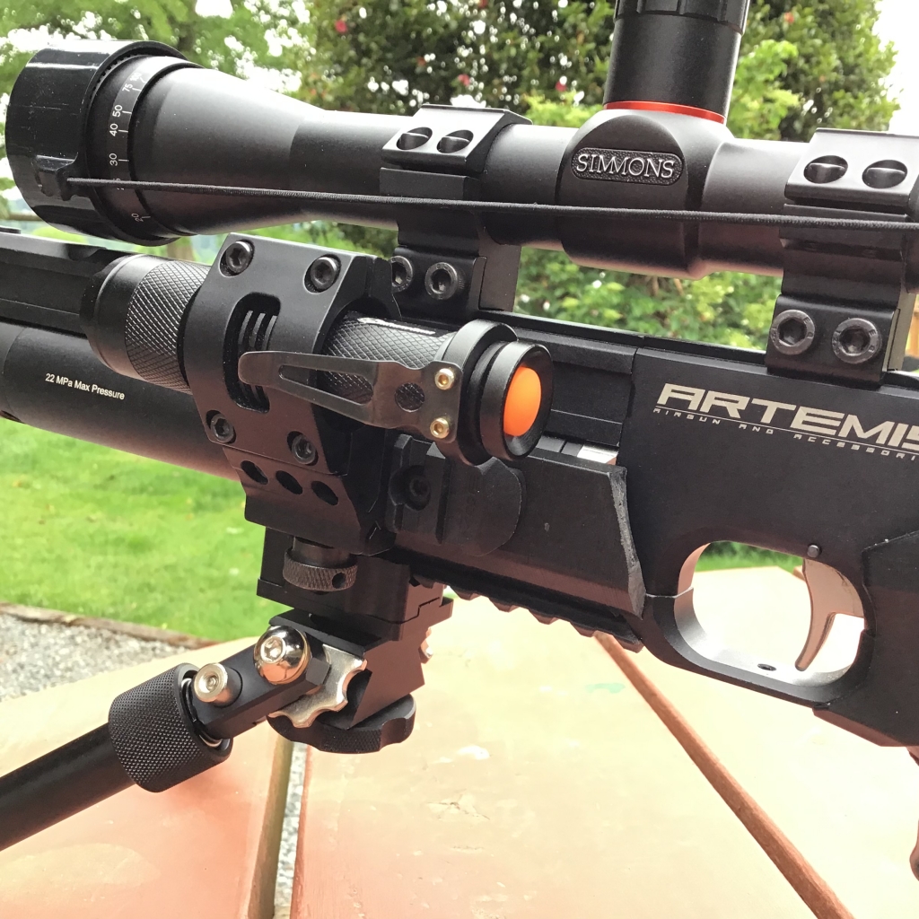

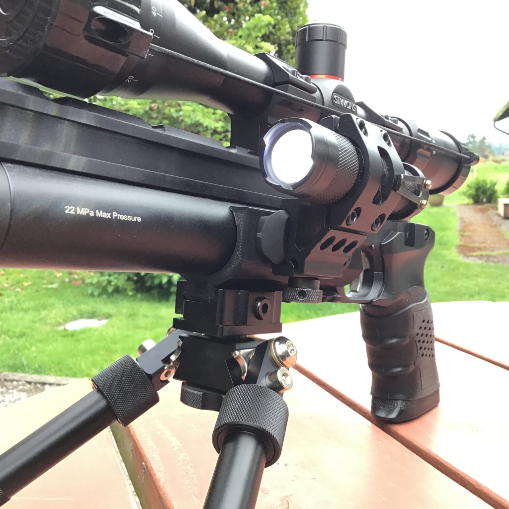

One of the greatest additions was the rail on the air tube. I modded the rail to slide back over the front of the trigger guard to secure it from rotating around the tube. It’s a friction fit. I got the rail to add the bipod. Then as I spent some time with it I had dreams of becoming a rat pester and thought that a light could be a useful accessory in low light situations. I drilled and mounted a picatinny section to the side to accept the mount and the light.

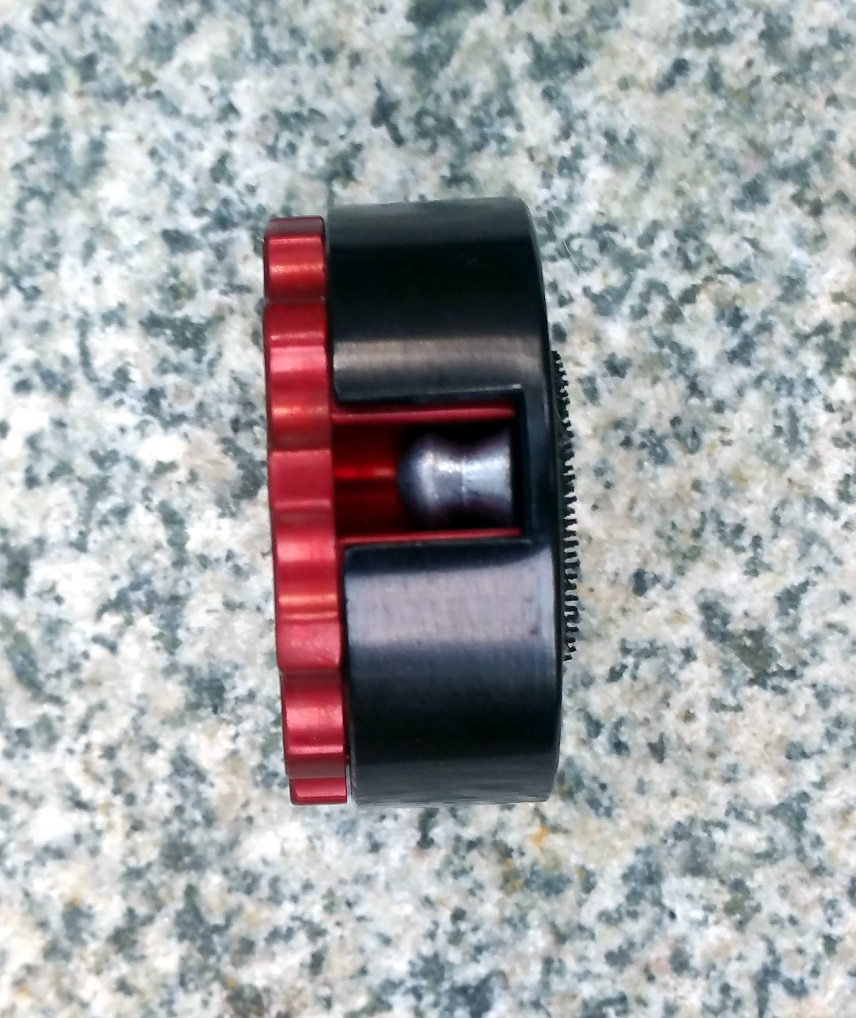

Next i I would like to figure out a convenient way to carry some pellets for easy access to load on the run while chasing down those dirty vermin.

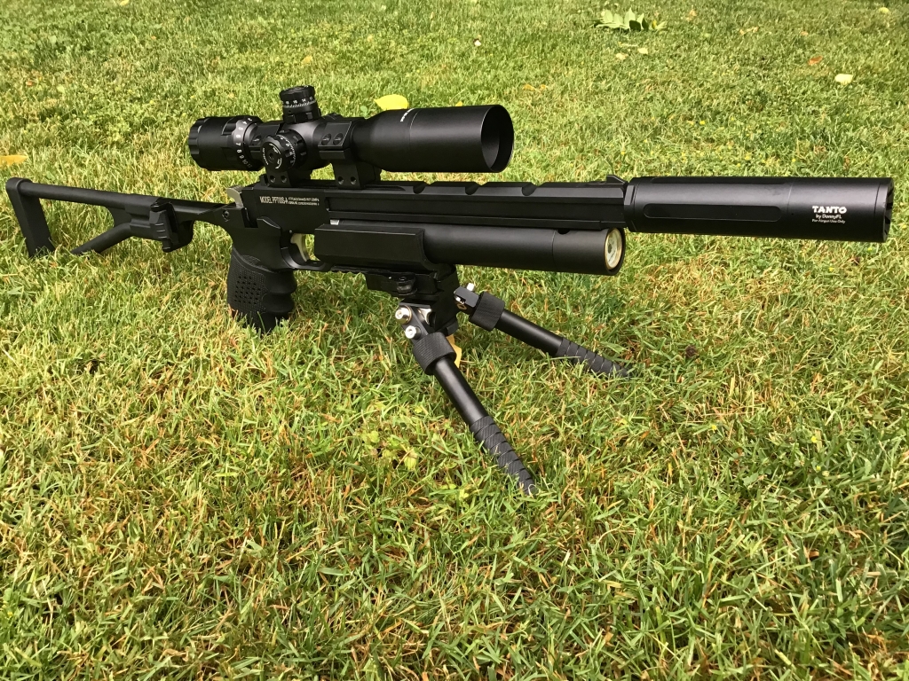

Greenarrow is the stock well made and ridged , Is it quiet with the Tanto and who would you recomend to purchase from? thanks

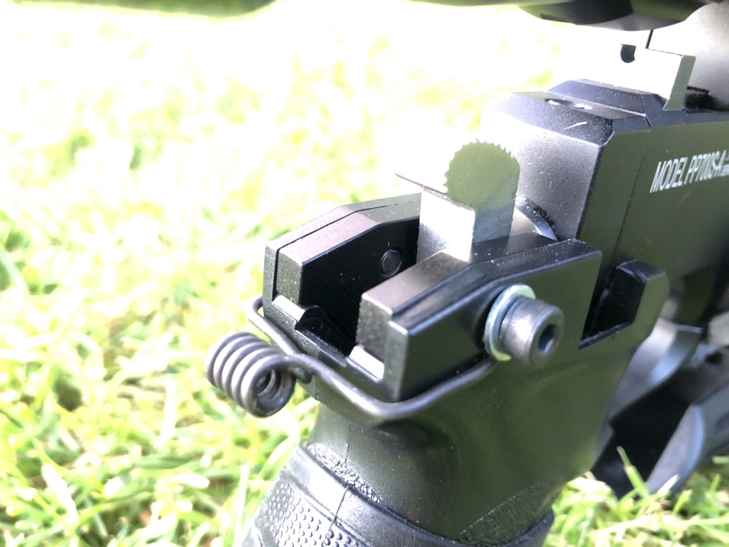

Not Greenarrow but I can give you some info. The stock is not the most rigid in stock form. Its gets the job done and with a few mods it works great. I drilled and tapped the metal part of the stock so that I could put a 2nd screw thru the grips on each side. This takes the up/down movement out of it. I also glued some small piece of sheet plastic in the hinge an this take the slop out of it.
I don't have a tanto but just a cheapie 1"x5" LDC and it does just fine for me at about 16.5FPE
