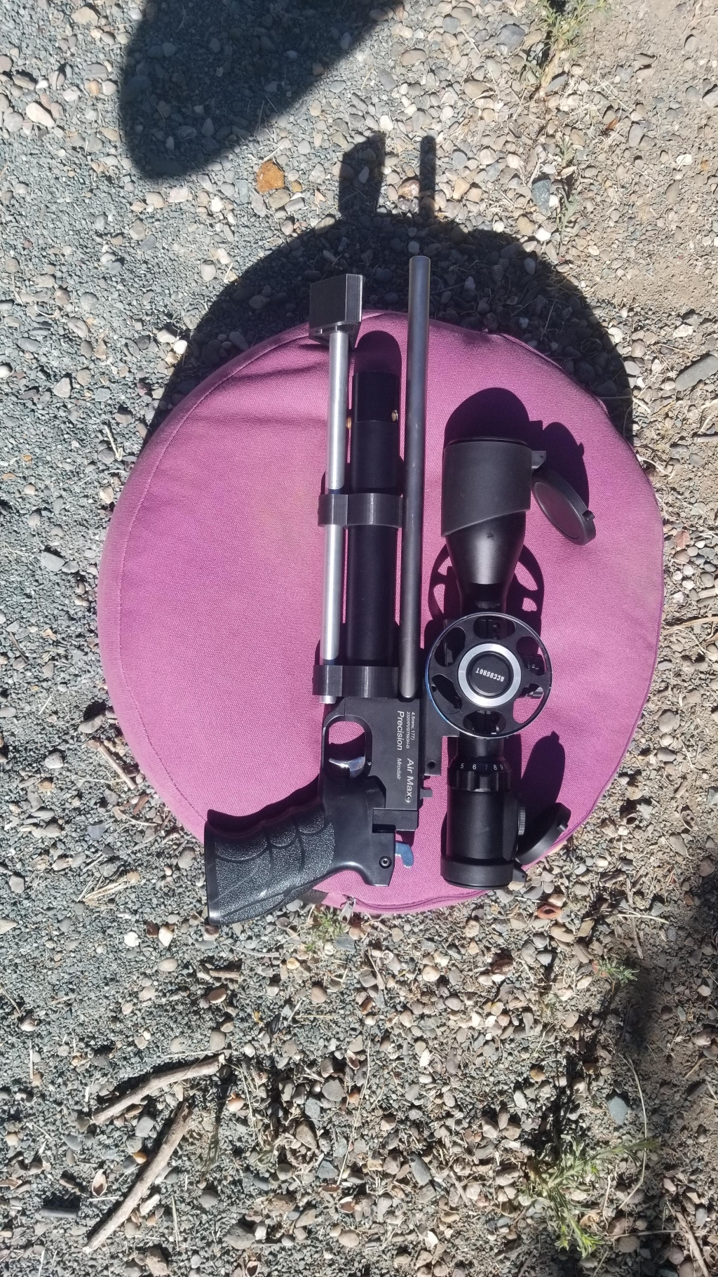

Just made mine into a FT loaner pistol for a friend.
Sports a 14.5" Air Arms EV2 LW barrel, tuned for 8.44gr at 795fps with a UTG Accushot scope and a custom 3d printed extension rod with V block to sit in primos trigger sticks.
Very very accurate.

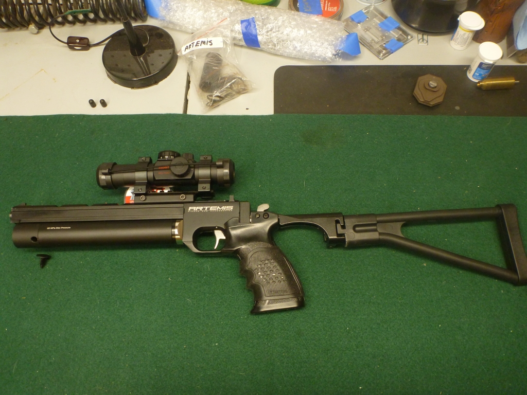

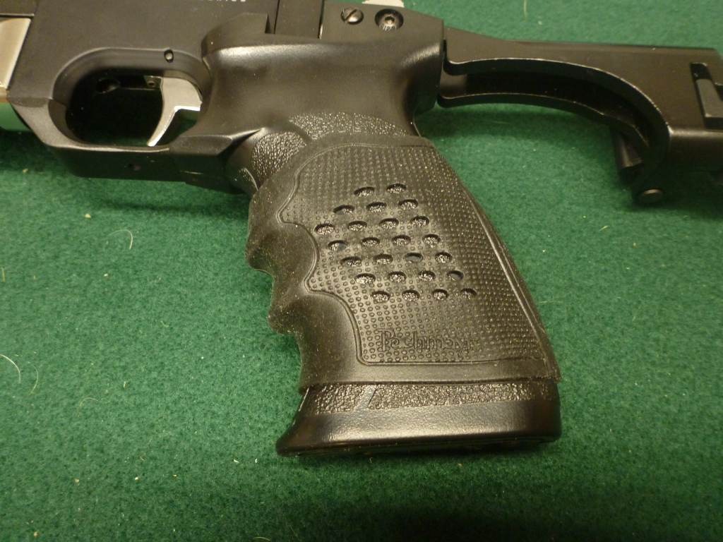

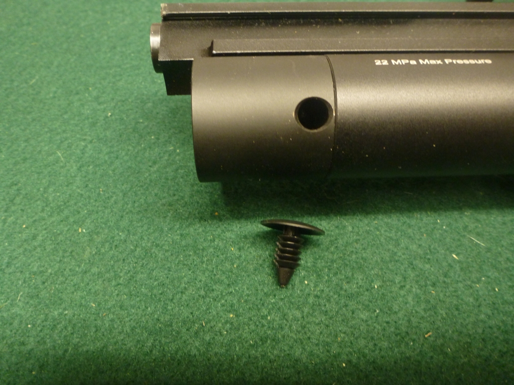

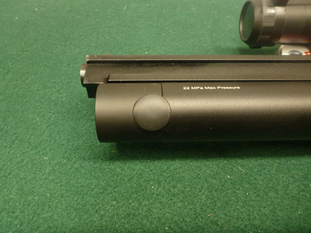

OK folks here is my solution for a simple, inexpensive ($.33 each) dust cover for my newly acquired SP700. These are automotive panel plugs
purchased at my local Tru-Value. These are sized 7/16"X1/4". The grip cover is from Hogue. The size on it is for CZ 75/85. I haven't chronoed the SP700
yet but hope to get it done tomorrow. These little pistol/carbines are real "sleepers" !!
