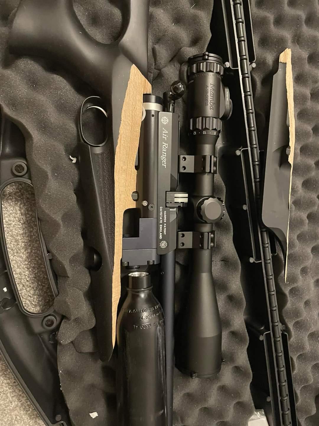

Accident. Daystate Air Ranger bottle front part blasts

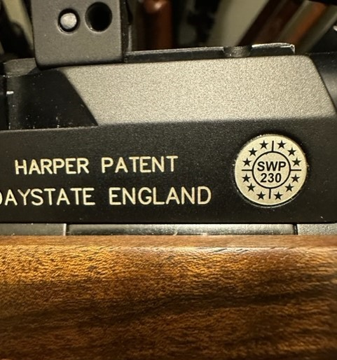

I'm pretty sure that the Daystate recommended max fill on that bottle is 230 BAR. With an older gun, with multiple owners, who knows if the recommended fill pressure was exceeded on a regular basis. My older Air Wolf had two previous owners, and the OEM aluminum bottle was swapped out for a fiberglass wrapped Talon Tunes bottle. I still only fill the TT bottle to 230, even though my FX Crown 480cc bottle can be filled to 250 psi. There may be manufacturer limits on pressure within the block as well. FWIW, I never use any of my three bottle guns to support the weight of the rifle, and I am mindful of the bottle's "line of fire" when refilling it. I also think I have read Daystate's owner's manual that the bottle is to be pressure tested every three years and replaced after 10 years.
On CAST aluminum, which the drop block is clearly made of .... when it fractures or breaks it has this dull granular texture of even color threw out the break.
If a fracture happens w/o a total failure this color will darken generally in the area of the fracture & become telling if or when the area completely breaks.
It is common with many metals upon a catastrophic failure to see a previous fracture, followed by the recent continued fracturing to failure in this slight color difference.
What I'm seeing of the bottle and neck of spigot being still in place is somewhat odd in that no fracture / color breaks appear to be visible ?
Seeing what I am ... Fracture being very near the drop block where bottle butts up to it ... BOTTLE TOOK A HARD HIT creating this break in one moment in time as no previous signs of fracture are evident.
JMO ...

Well guys from the photographs given...
The failure was in bottle adapter that is attached to the receiver!
Where the bottle is screwed in.
So, The Bottle did not Fail!!
The adapter stub with O-ring is still attached to the Air Ranger.
It looks like it Fractured at the start of the threads on the adapter..
Not being a Daystate type... I don't know the material use on the adapter...Aluminum???
So At sometime in it's life, either a hard blow or it experience a Drop....
Normal use or even supporting the rifle on the bottle wouldn't cause this failure!
JMO ...
I would say it's machine from 6061. Better fatigue resistance than 7075, though not as strong. Die cast would not support the requiered strength (maybe zinc diecast?) Sand cast is out of the question. Think just like the L2 incident we have to wait for manufacturer analysis.

Hmmm, I see a future in making that bottle adapter from a nice piece of heat treated 17-4 and selling them to all the Air Ranger owners that just dirtied their underwear.

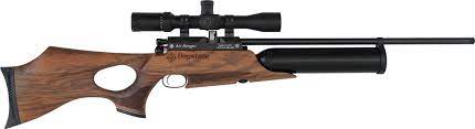

As I said back on the first page in post #12, as an Air Ranger owner I have never seen one that had the kind of "spacer" that is on the bottle, and as member Inverted said in post #36, the coloring of the drop block is all wrong for Daystate - which are generally flawless in that regard, especially back then.
The more I think about this, the more I think that this particular gun was equipped with some sort of in-bottle regulator, of which the "spacer" is part of, and also used an aftermarket drop block with a down sized bottle mount - that also stood off from the block leading to the cantilevered load this thing apparently experienced. I could be wrong, but that is my guess . . .
Again - that mounting of the bottle is not stock for any Air Ranger (or Air Wolf) that I have ever seen. I can say that already, just based on the photos so far and not having all the information, that I am not at all worried about the integrity of my Air Ranger. I took my factory aluminum bottle off to swap for a lighter CF one, and the mounting is rock solid - over 20mm of thread engagement (I don't know the actual dimension, but I recall the M18 threaded fitting is noticeably longer than it is wide , so probably over 25mm long), and sealing via a captured o-ring between the bottle and the block (so not sealed at all by the threads, just like an M18.5 valve to a full pressure CF tank at 4500 psi). The captured o-ring seals when the bottle is just hand tight, so there is no need to "crank down on it" to get it to seal. The shoulder of the bottle has a full interface to the block for any kind of load transfer when the weight of the gun is rested on the bottle (unlike with the one in the photos). It is a rock solid design.
