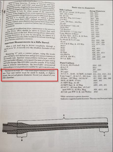

1. Buy a micrometer:
2. Slug the barrel from the breech:
3. Determine best performing slug at your preferred sight-in distance with specified groove diameter.
4. Sample slug at groove diameter, and one slug .001 above and below the groove diameter (preferred distance, then two sight-ins 10 or 20 yards apart) for a comprehensive test.
