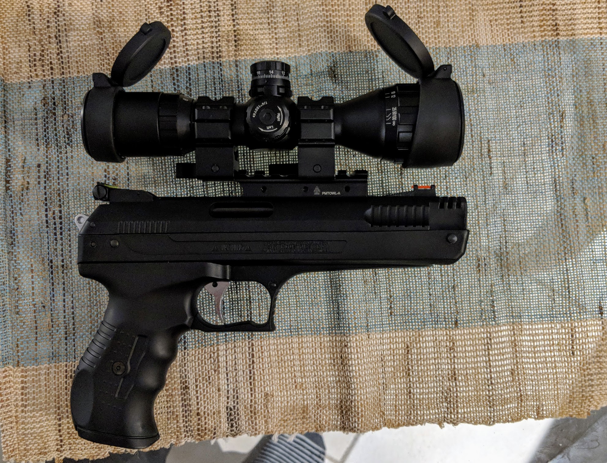

I've bugbustered mine, something like 5+ years ago.
If I recall correctly, it was good (bench rested, sitting, bagged up) for 20 yards and dime size groups no problem.
Never shot it further than that, and the entire setup was done just to be silly and dumb, because I could. Didn't foresee this conversation, so i didn't bother with any real data collection efforts. :)
And what do you know, thanks to the search feature in Google Photos, I can even show it to ya.
