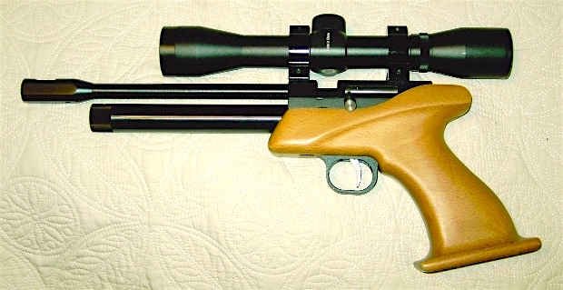

I saw a lot of favorable reviews for the Air Max CP-1M CO2 pistol in .177 cal, a couple of years ago. However, when the accuracy was brought up, all I saw was that it was "accurate, very accurate or extremely accurate" but no targets backing up these claims.
Decided to take the plunge and try it out. While the fit and finish was very good for a $79 air gun from China, when checking the accuracy, it was less than desirable, to me. It's more of a plinking gun.
I could get around 42 to 43 shots before the velocity would start dropping. I even ordered an adjustable hammer for it to try and get more shots per CO2 bulb or Powerlet. With the hammer adjust long or short, it only would get around 21 to 22 shots with a large amount of wasteful CO2 shooting out. The velocity was only around 10 FPS faster, depending on pellet. Replaced it with the stock hammer. It's no target gun but still fun to shot.

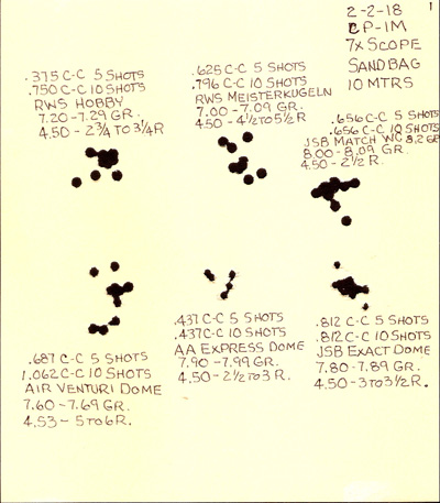

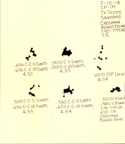

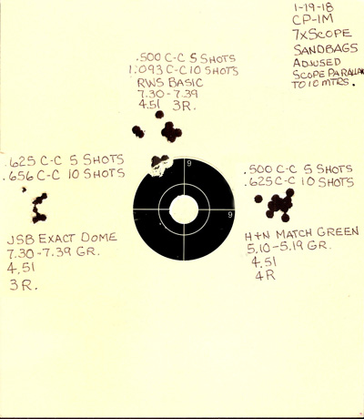

To check the accuracy, a 2-7x scope was used with the Parallax set to 10 meters, shot on sandbags, pellets sorted out by weight, head diameter and rolling radius. These initial 10 shot groups are for checking which pellets to further check out. Reason for shooting at 10 meters is the longest distance I have these days is 20 yards, plus it's illegal to shoot air guns in the city limits, other wise it would be shot at 25 yards for comparison.
H&N Green Match 5.25 gr. - 565 fps
Crosman Boxed Dome 7.9 gr. - 506 fps
RWS R10 7.0 gr. - 534 fps
JSB Dome 7.33 gr. - 530 fps
