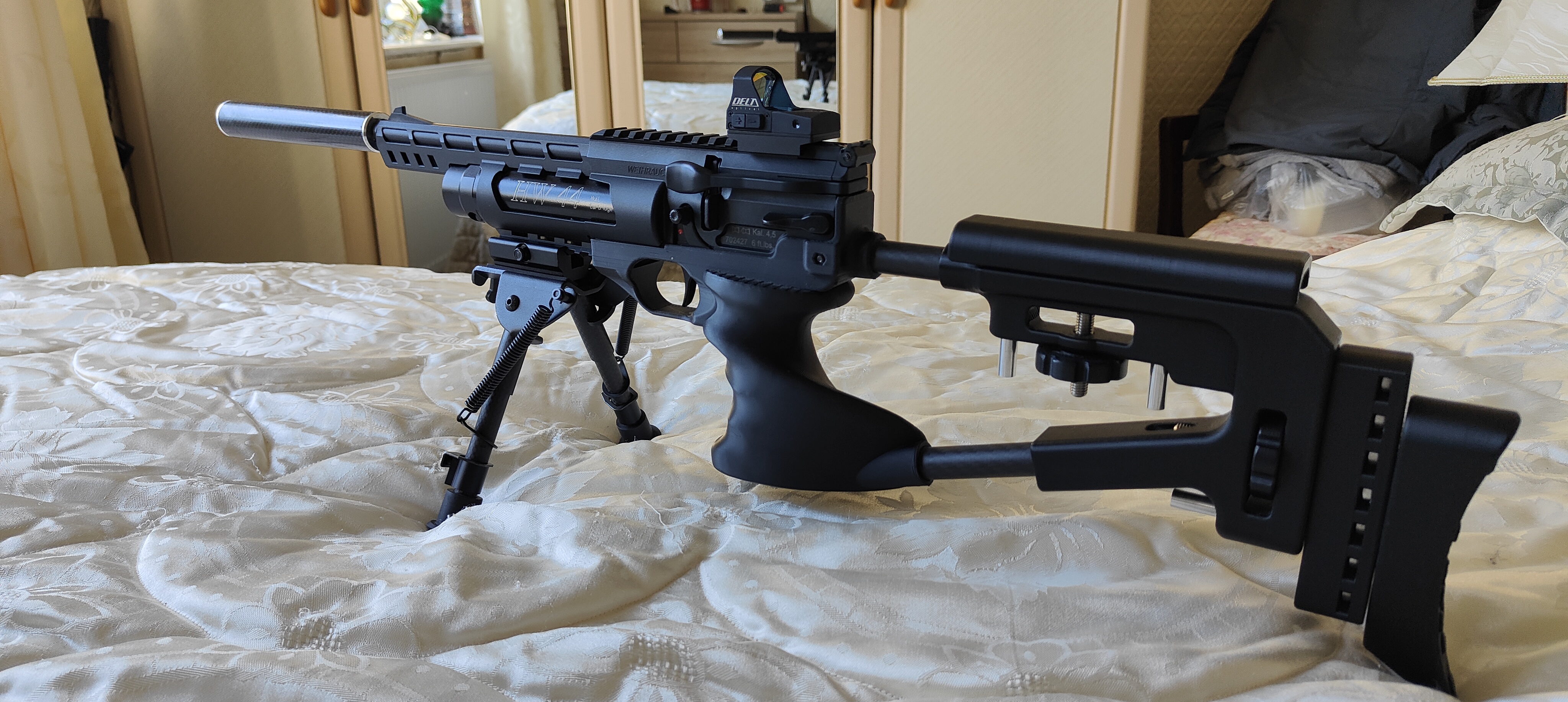

This was done at 15yards rested 6ftlbs with a Red Dot 3moa. I am new to this. I think at this power 6ftlbs 20yds will be the max for decent groups. I however am battering spinners
around at 27 yards nearly every shot. Ignor the top left just zeroing.
