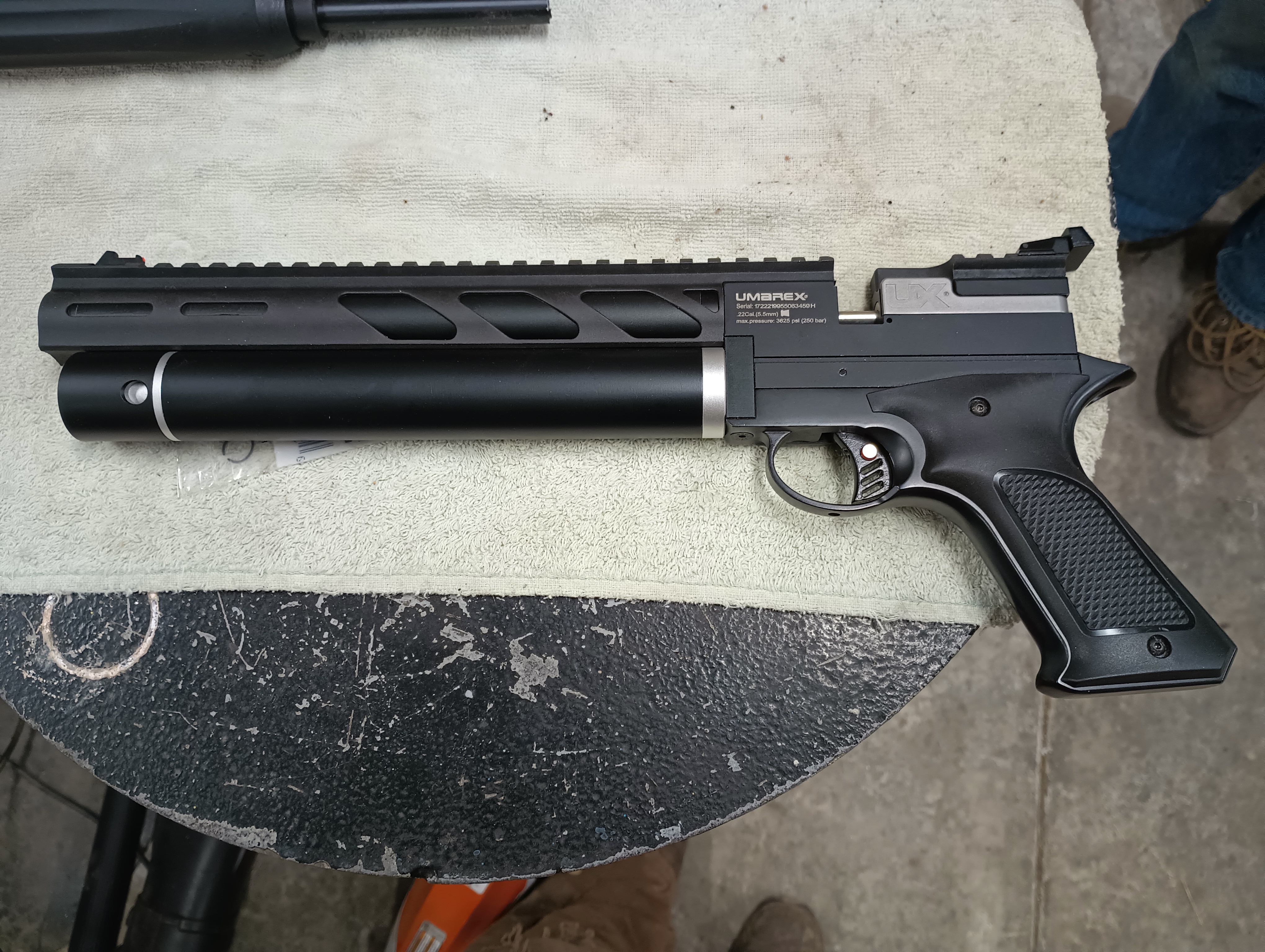

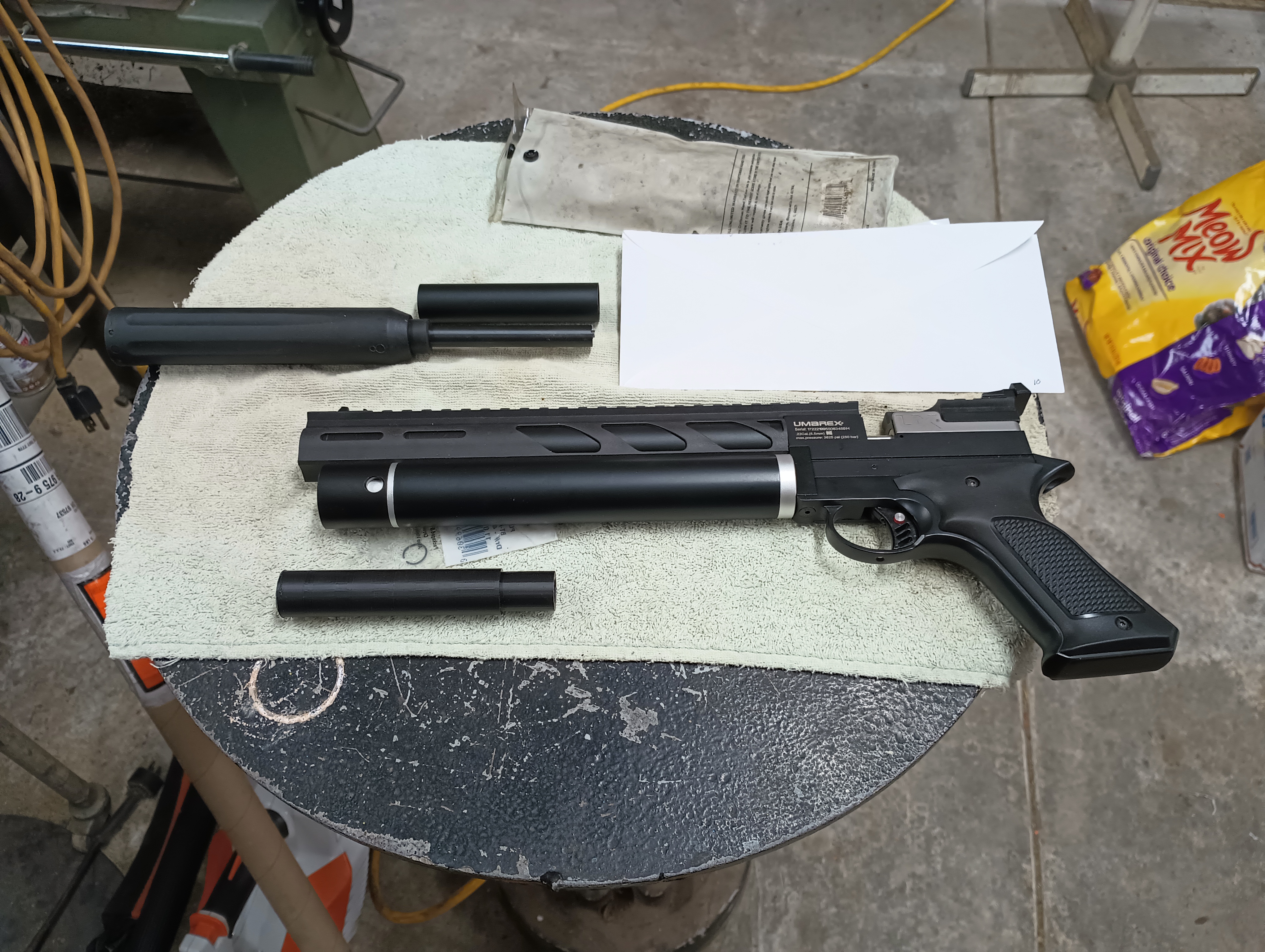

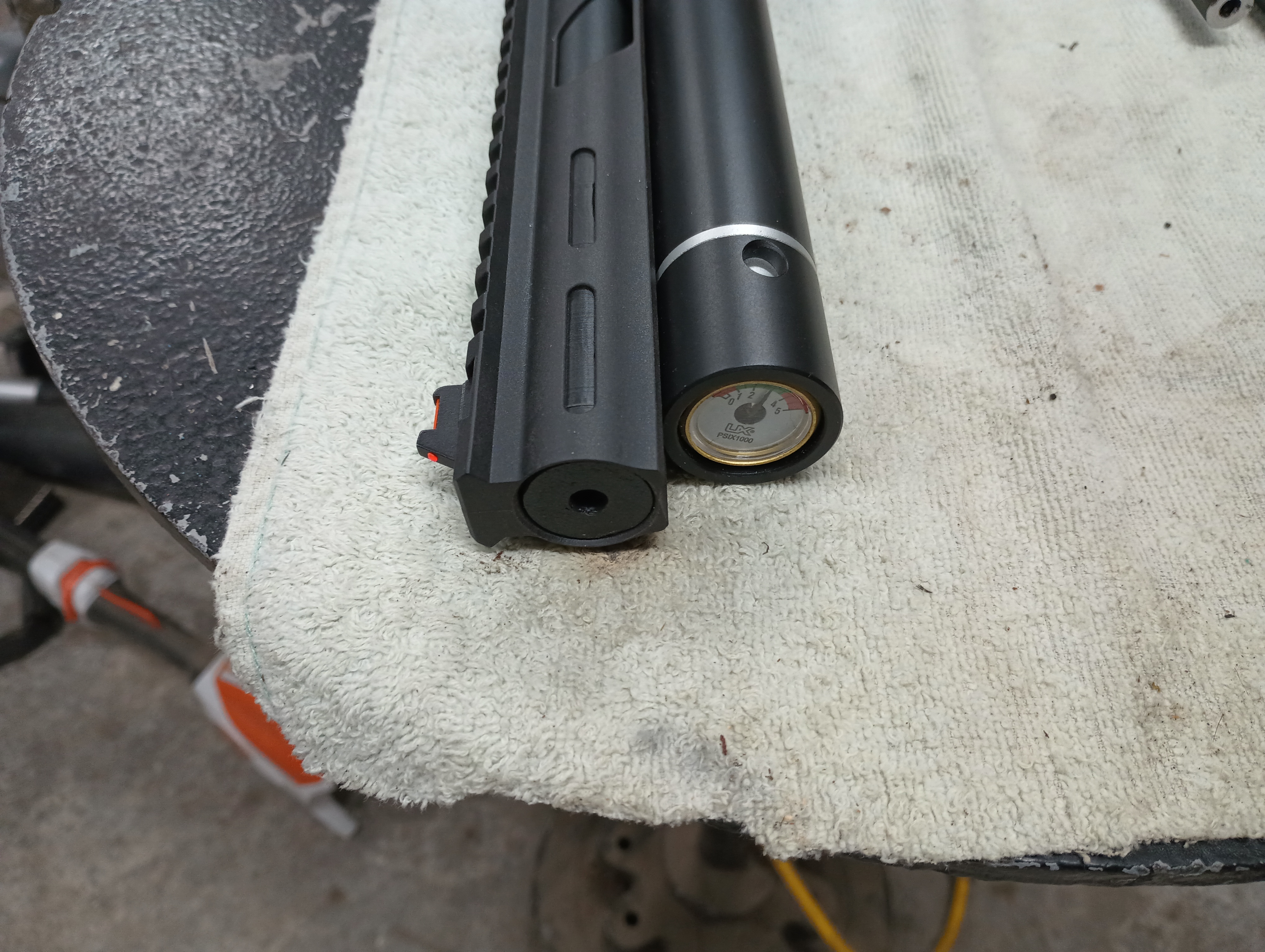

ok..I shortened my notos and I found two things in the process..or 3.. it didn't have a good crown so recrown helped a lot.. now it's also not choked but either way it shoots better than factory.. it's got a 4" moderator in the shroud so the barrel is actually 4" shorter,I wanted it for a pistol..
there's also a place already drilled and tapped for a second set screw but you have to drill a little hole in the picayinny rail so you can put a Allen wrench in to tighten it up.. makes the barrel much more secure.. I drilled the hole just big enough for the Allen wrench and got the screw in the threaded hole and then put the rail on that way it stays a small hole in the rail..
other issue was when I pulled the barrel it has two o rings and one was completely crumbled and missing parts.. the other one crumbled when I touched it.. I assume they were poor quality and deteriorating before I got it from pyramid air..
they are metric, the whole gun is metric.. but they are not a common size..
another member here, good guy.. firewalker ordered a batch of them and I was able to get some from him.. fits and better quality..
I was so frustrated trying to find the barrel o rings that I almost chucked the barrel back in the lathe and made standard o rings.but much easier just getting ones to fit from firewalker.. he does a lot of modifications on the notos and zelos..
I'll attach a couple pictures of the notos I did..
I never installed the stock, just open factory sights and pistol grip
Mark
Mark
