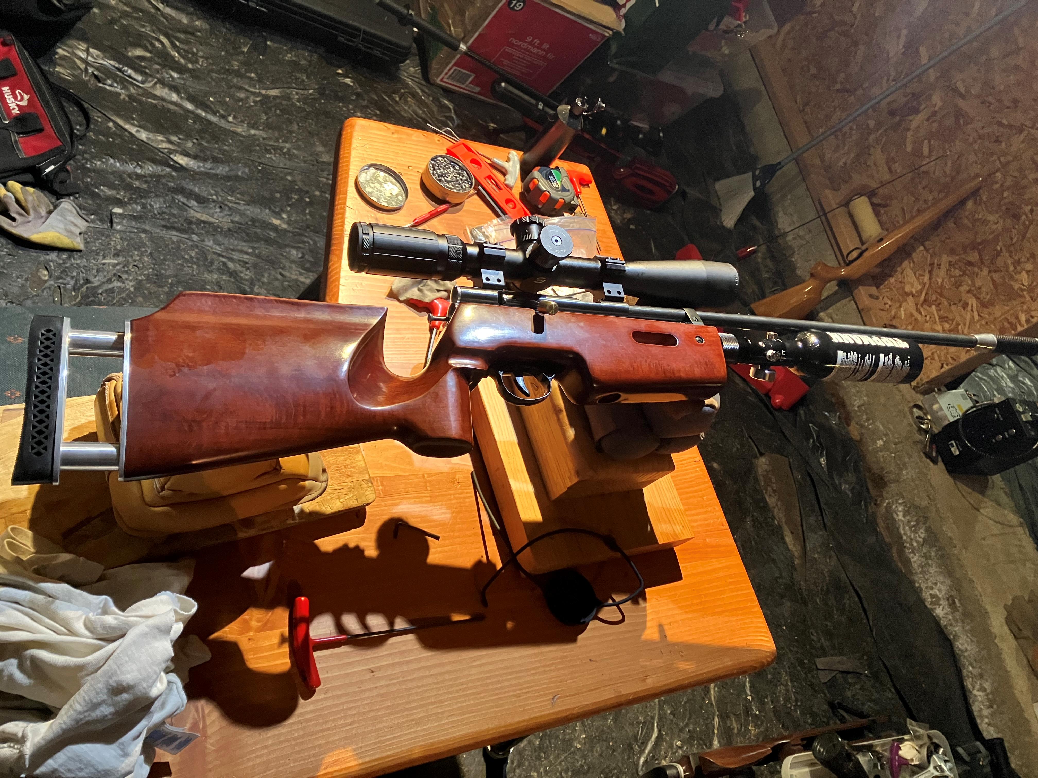

Do you plan to use a scope or peep sights? The AR2078 is a QB78 platform with peeps and a better stock.

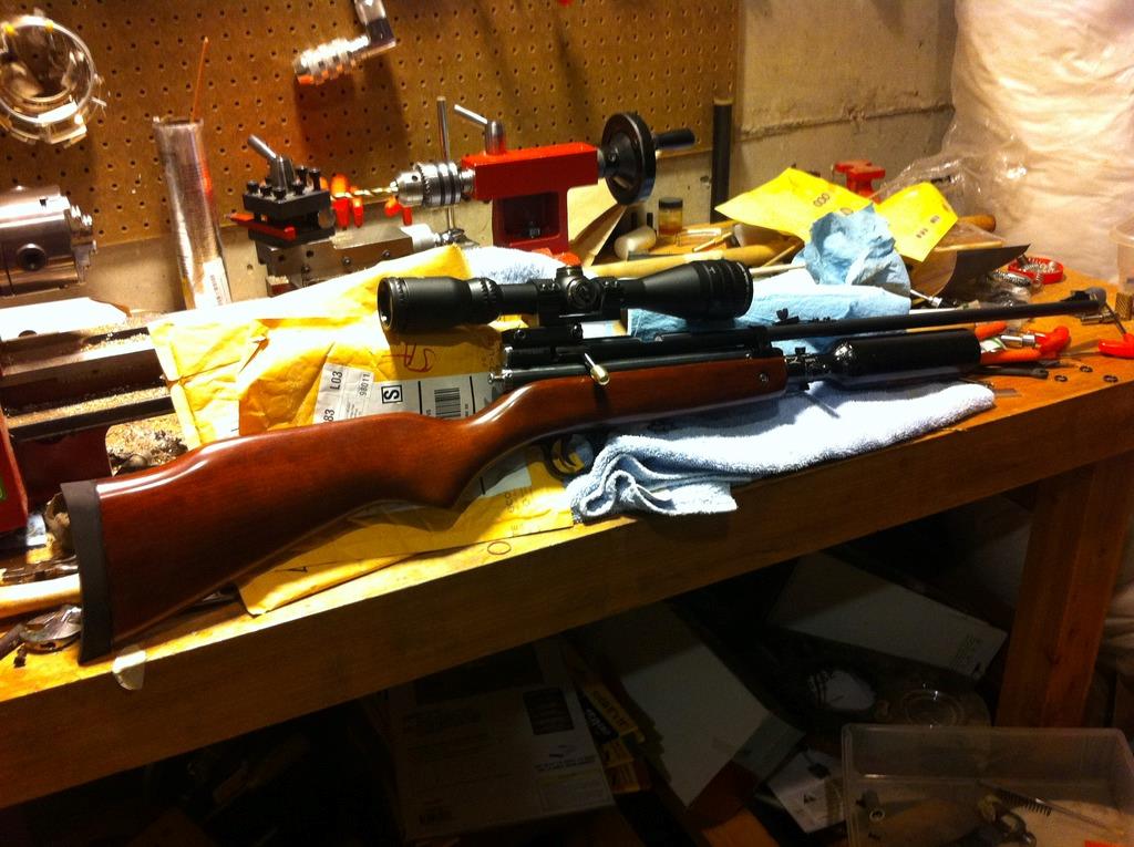

I've had the chance to work with / on a few QB78s and found them to be worth the effort. But... As they come out of the box they need a little finishing. Sharp edges need to be dressed and the gas port in the barrel needs to be de-burred for the best accuracy. Cleaning the barrel thoroughly is needed as well. The Deluxe also needs an added cheek-piece for a consistent cheek-weld. Trigger adjustment is easy and it's done in minutes. If you're not concerned with power, you can dial them back a little and get more shots from a pair of cartridges.
All that said, the .22 Deluxe that I have shoots into less than a quarter-inch at ten yards with Crosman premier hollow points. A friend's .177 does the same with Crosman destroyers and Daisy wadcutters. Here are a few photos.

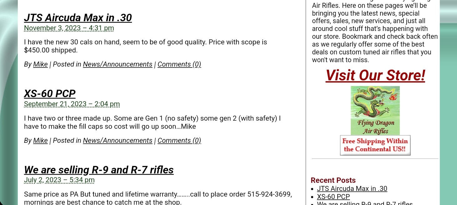

+1 to what SD posted and seen many happy customers post about Mike's XS60C. You might give Mike a call and see what he says:

The QB78 platform is relatively inexpensive and can be made quite good especially at 25 yards.
However, the may need a little barrel/trigger work for them to be very nice.
Assuming you want to buy a QB78, do this work yourself or send it to Jason (Nervoustrigger).
They are best attaching a HPA tank which is regulated, but then you'll need a pump (no more Co2 cylinders :) ).
Mike has some converted over to PCP, if you didn't want to go co2

The High Pressure Air (HPA) (213cc) bottle is (a paint ball bottle) pumped up like a PCP tank. It's also regulated which make it very consistent shot-to-shot until you go off the regulator. In .177 caliber I get about 70+ consistent shots before things drop off.
Very economical relative to Co2, but you need to buy a hand pump (HW90) or a machine. I usually have the regulator set at about 1400/1500 psi, so you can get up to 20+ FPE.
So I'm suggesting to modify the QB78 into a regulated HPA gun or PCP; moving away from the Co2.
