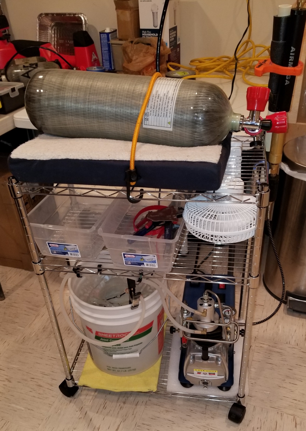

I mean no offense by this question, so pleae infer none. Are these CE as in "Conformité Européenne" or are these CE as in "China Export"? Has anyone looked up the notified body after the CE mark at https://ec.europa.eu/growth/single-market/goods/building-blocks/notified-bodies_en
Thank you in advance and please infer no insult. Looking at the image posted the logo appears to be China Export? I can't make out the Notified Body numbers to run a CE check.
Not to worry no offense taken. At my age ya don't last this long if you have paper thin skin 😁 Got to be able to take some chinks in your armor once in awhile.
I read on another forum that CE does not stand for China Export. I'm far from being the go to source for certification so I go by what I read like this:
https://en.wikipedia.org/wiki/CE_marking
If I were using this for SCUBA Diving or Fire Fighting (breathable air) then I'd buy DOT certification.
As long as the air going into my tank is dry and free of debris my PCP is happy.
You can always ask the person or the company you are buying your tank from which certification they are going by.
